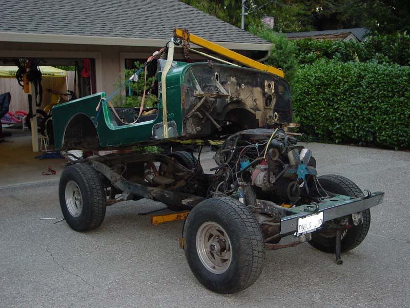

and I found these pics of how another guy did it..

This is how I did mine, only I used a 2" rachet strap under the roll bar 45*. If the Jeep is to high,you could let the air out of the tires, before removing them.

I found a good balance point on a CJ-7 tub is the front center seat belt bolts. Shop crane from the side and link both sides of chain up at lift hook so it wont slip and rotate (had that happen). Best on empty tubs only. For loaded tubs, I pull the chassis out from under it.

I used 2" ratchet straps and my rafters in the garage....... worked with ease..... just be carefull though
