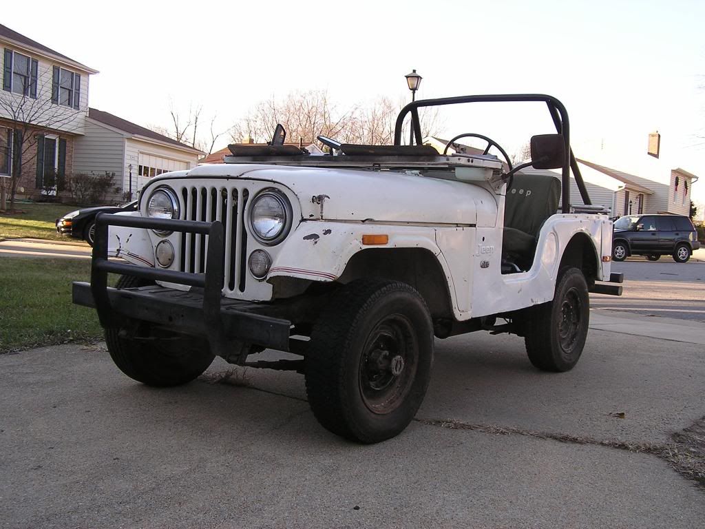

Here's a couple of "before" photos of what it looked like for about 20 of the years I owned it. It was white when I bought it, and had been blue at some point in its life, and the original green was still under all those layers too.
