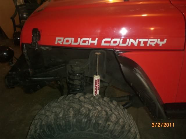

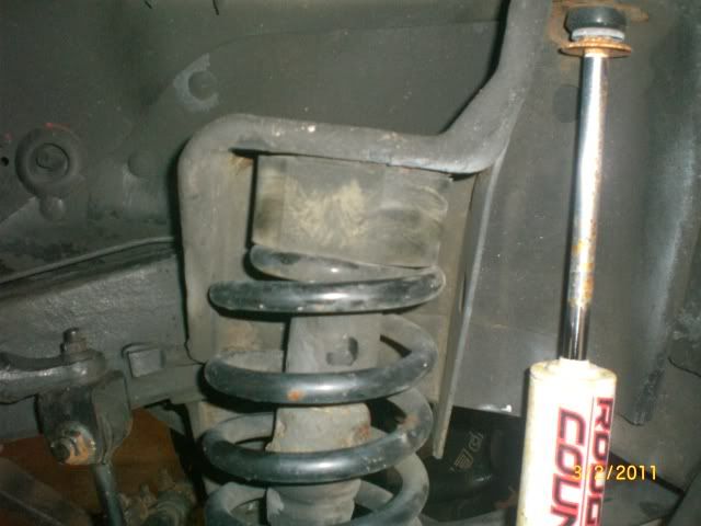

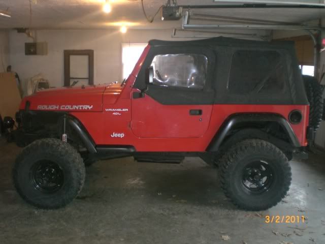

The PO installed 2" spacers on the front to I'm asumming level it out. I've had the jeep for about a year now and I keep telling myself to take them out because I have some small driveline vibes.
I've done brake jobs, oil changes, taken a BL off, dropped fuel tanks, but never messed with anything suspension wise.
So can somebody give me a step by step on how to remove front coil spacers?
And yes I'm aware that my fenders are chopped lol. Not my doing (PO thought it looked cool?) hopefully somebody will donate me some MCE flatties :wave:

Again, not sure, but it appears that there is enough compression left to remove the spacer and still be ok. If the shocks came with a kit and the spacers were added later, the shocks should be ok. Unless longer shocks were added with the spacers. To the OP, if the PO added longer shocks and bumpstops with the spacers, then this needs to be addressed as well.
#14 ·
Like Boogie said, basically the opposite of putting them in. Pull the coils (compressor? that's what I use), remove the bumpstops, remove the spacers, reinstall bumpstops, reinstall coils. Pretty simple. However, this may cause the shocks to blow out over a big bump, and likely would not cure any driveline vibrations.

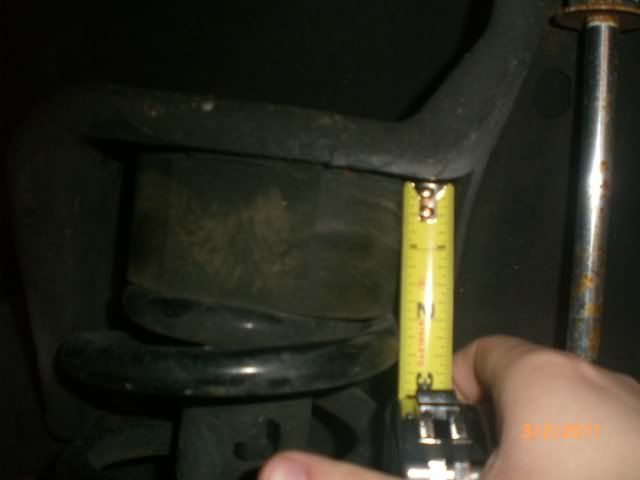

#16 ·
I'm not entirely certain about this -- I'm in a different town than my Jeep right now, or I'd check -- but I believe that the stock spacer/isolator is .75", and that the photo shows that the PO removed the original and replaced it with a 2 inch spacer, which means that the total additional lift is only 1.25 inches (2" new - .75" old). This is how I interpret Daystar's instructions (see this PDF) which are pretty thorough.
If I'm correct, then sawing it out with a sawzall is not an option, and what you need to do instead is remove the spring, remove the 2" spacer and replace it with a factory-style .75" (Daystar part number KJ09108) or a 1.25", or some combo.
Someone else with more knowledge, please chime in.
#17 ·
IDK if i have more knowledge:))) but you are correct in the fact that there are no OEm coil isolaters above the spacers....If you dont put something back in the spacers place you will have metal to metal(spring to coil bucket) contact and that is NOT good! You are guarnteed to have more vibes especailly when the front suspension compresses....Farmer had the math right....All Jeeps come with a fake from the factory and the PO corrected it pretty normally. Id just leave it the way it is.....The spacers aren't likely causing your vibes anyhow. BUT poly does give more vibrations than the factory rubber ones....Sorry for the book:)
