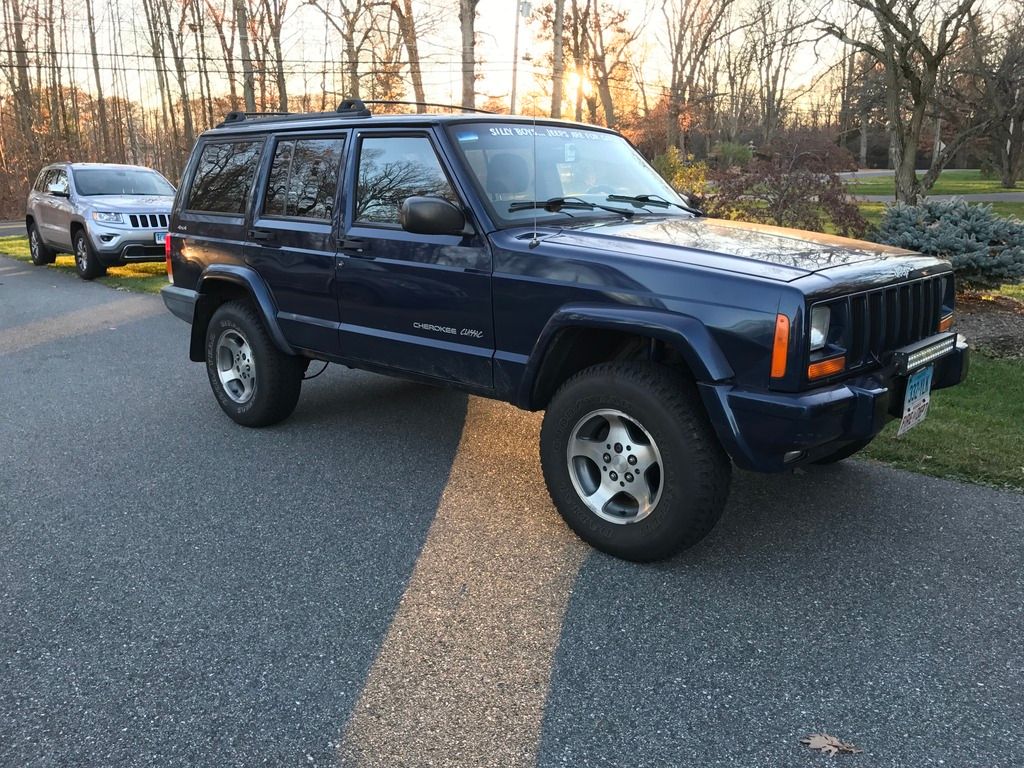

Completely agree with S8NNG8, if you want to go any higher than 3", or even sometimes at 3", you will be messing with a whole lot of other parts to make your Jeep work the way you want it to. At 2" you will be able to maintain a lot of the stock components. But at 3" you will want at least new lower control arms and shocks, maybe a slip yoke eliminator. Higher and the list gets longer. My girlfriends Jeep is lifted 1.5" on 235's and I think it looks pretty good the way it is. Stock wheels with no spacers. Everything stock except for the new leaf springs and front spring spacers.
This is Crown HD leaf springs in the rear and a 1.75" spacer in the front on the stock coil spring. New stock shocks with BPE's for some added length.

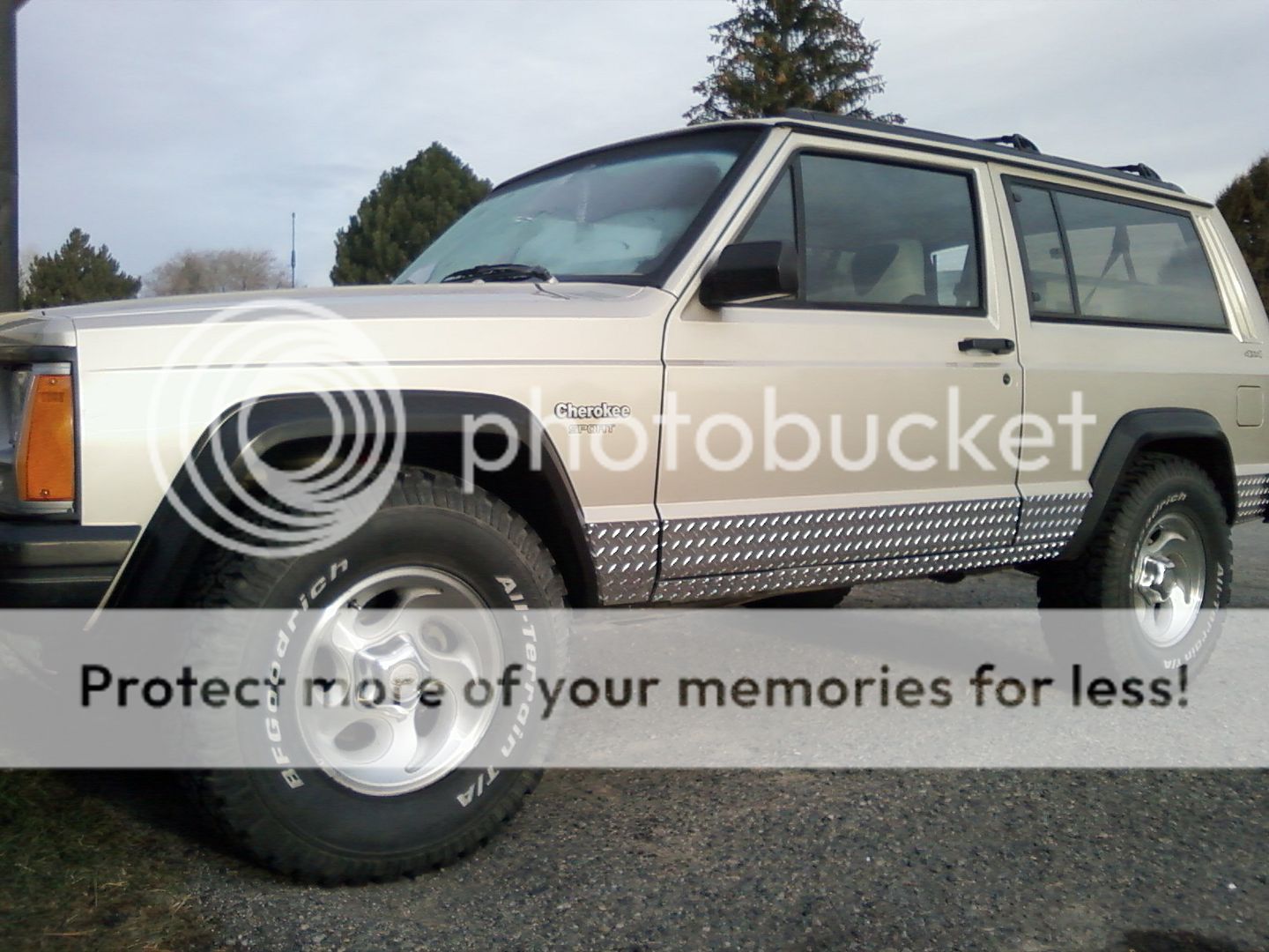

I bought my Jeep with 32s and some old ugly wheels. It had Bushwacker fender flares. I picked up some stock Jeep wheels and put 30x9.50r 15 . They did not look right so I added 1 1/2 inch spacers and have had no problems. I used locktite when I put the spacers on so I would not have to retorque them all the time. I have used spacer on many other vehicles with no problems. If you have the choice get a wheel that you won't have to use spacers on but don't be afraid of them if needed.

thanks s8, that is what i was figuring, i dont want to do a lot of things to it, just get a little lift and better look
redjeepster, thats my jeep exactly, same color, exact body style even the roof rack. I was just turning in my drive way to day and the tire rubbed on the sway bars.
So it is spacers or wheels. Nice jeep. That lift looks good so i know a 2 inch would look just as great on mine.
soapy, what is your lift at now, in the pic. do those wheels have a back space, and what are they off of.

My XJ had the lift installed when I bought it at auction. I think it is a 3 to 4 inch lift. Terra flex stuff. I think the wheels came off a TJ. Picked them up at a local junk yard for $40 each/ got a set of 5. With 30x9.50 r 15s I can still put the spare inside in the stock location.

Wheeled my girlfriends Jeep at Rausch Creek this weekend with her 235's and 1.5" lift. I would recommend it to anyone wanting to DD and have fun on the weekend. I was amazed where it went.
