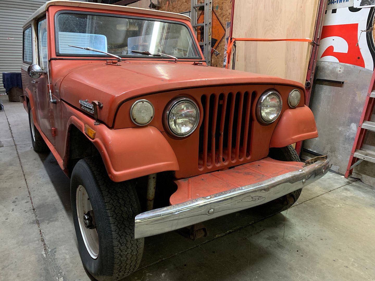

Looks late 60s or so. I had a '72 model this same color but with the "ugly front clip" instead of the Jeep style grill. I would think it would still have the v6 badges if it has the Dauntless odd fire v6 in it. but they may have been removed. You can take a pic of the motor and post it and we will be able to narrow that down. Commandos are rare and not seen very often now days so it is a good restoration project to do....unfortunately you have Cali emissions to deal with...….yuck

#12 ·
'71 or older due to the flat "Jeep" seven slot grill. '72 and up have a different "Bronco" or "Blazer" style front grill. Original late 40s Jeepsters (which are 2wd only) were a pointed grill like the Willys Wagons. Then they went with the flat grill then the rounded full grill look for the last generation.

I think it's a '70- '71 because of the rear reflector on the side of the tub. (But that's a guess)

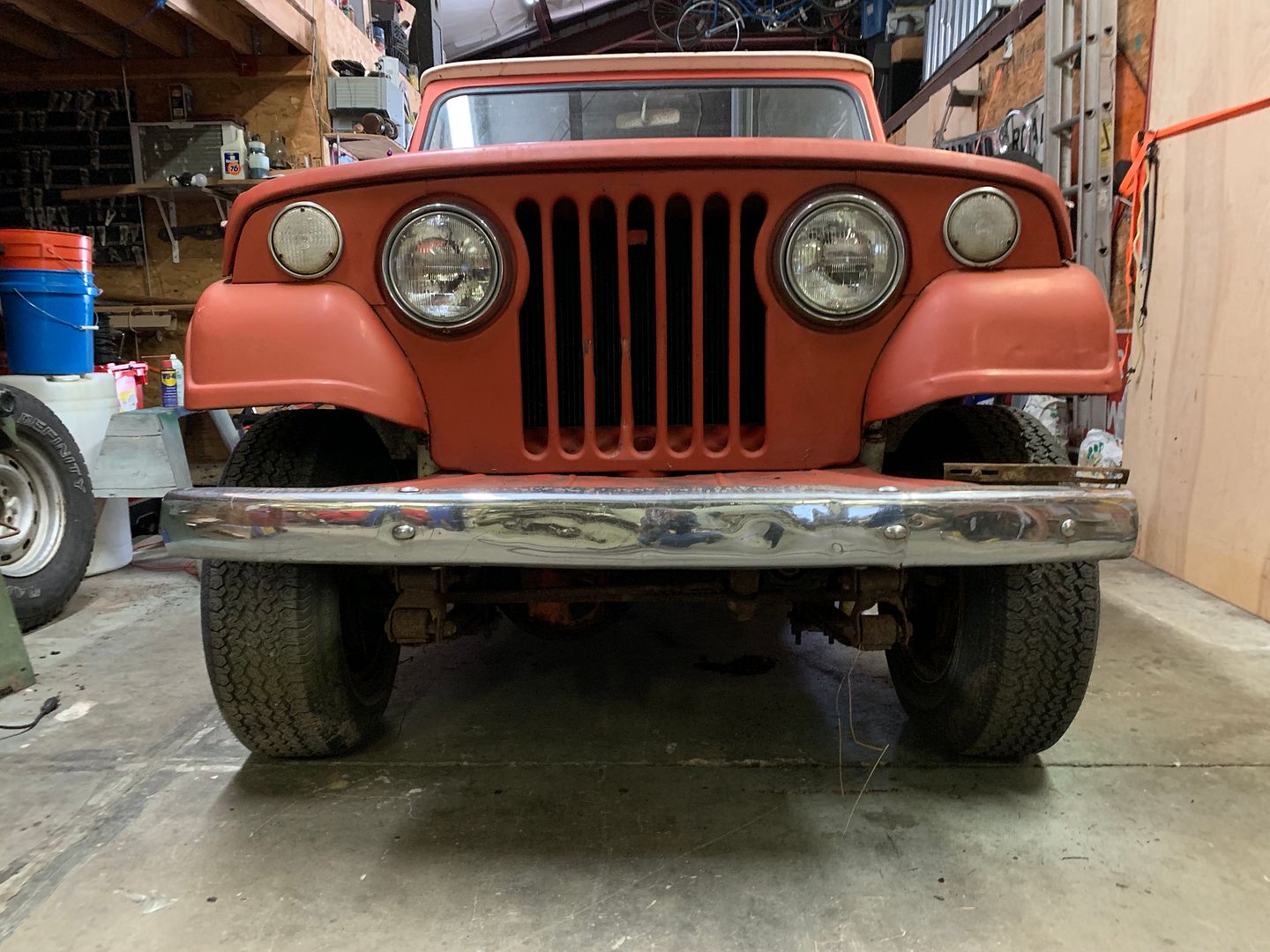

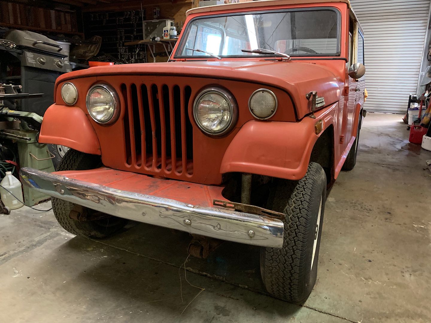

Ok guy's, just got back from picking up the Jeepster. Here are some pics. And yes, it has a V6 emblem. Only on the passenger side though?
Kind of rough. LOL
You can see someone patched it in a few places. Also needs more patches. LOL
Love the hitch. :D
This reflector appears to have been made to go in this location. What goes in the holes below?
So, the plan as of right now is to first take it to the car wash and blast it. LOL Then we will bring it back home and my first thing I would like to fix is the doors. They will not stay shut. One of them has a bound up inside door handle and I really don't know what is going on with the other. The window on the driver door also doesn't roll up all the way. Once I can get it so the rain will somewhat stay out of it, I will move onto other things.

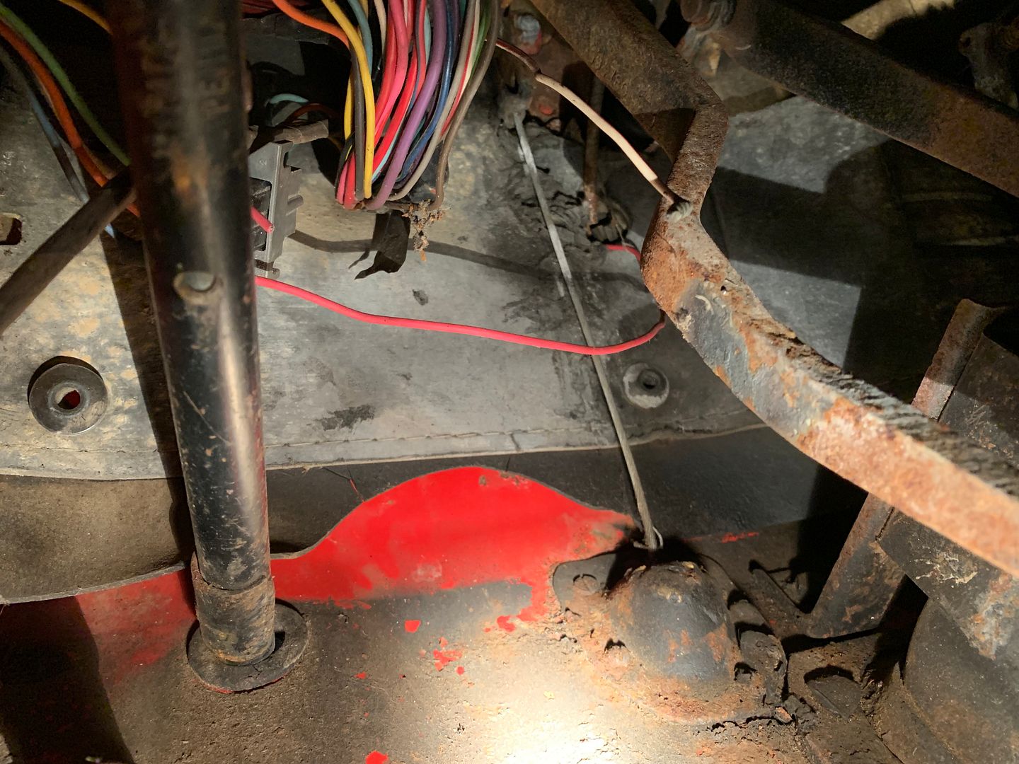

Here's some pics of the steering.
That's about as good as I could get of the steering box. It's still on the trailer so chains are in my way. We are going to take it to a car wash before we take it off the trailer. I was hoping to get to it yesterday but go to busy. Hopefully this weekend we can run it over there. I would like to putter with it a bit, and it's hard to walk around the edges of the trailer. LOL

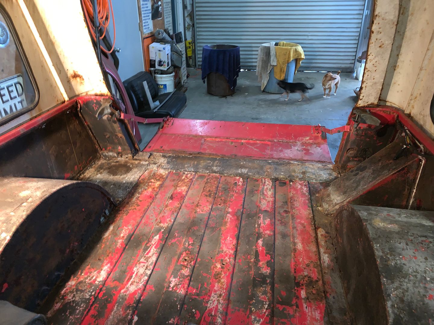

Found these 3 holes in the trunk area. What do they hold? Spare tire bracket or something?

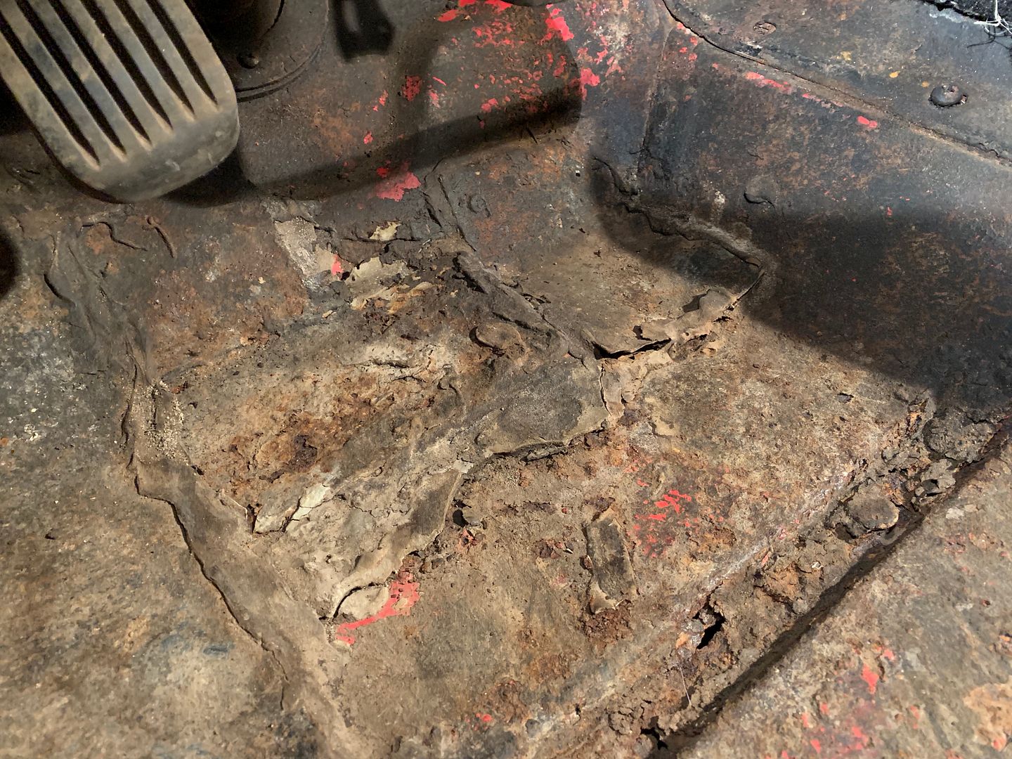

That is indeed a Saginaw manual steering box. Congratulations. The Ross unit is poor at best.
You can keep the existing box or source a pump and brackets for a power steering upgrade.
Rust is a real issue on these rigs and yours seems to have more than it's share. It is especially prevalent around the rear wheelwells and the tailgate area(as you can see). I see there has been some patching back there. Take a good look at the area to insure it is solid or repairable. In fact, take a hard look at the entire body and work up a repair/cost sheet to see insure you want to invest in getting it back on the road. You can use a screwdriver and try to punch through any suspect areas. If it goes through, you're gonna have to repair/replace that spot. Unlike mechanical issues, body work takes a LOT of time and in some cases, can't be repaired without extensive fabrication. Just something to think about before investing money in the engine, brakes, axles, etc, just to hit a bump and have a door fall off..........

Holes are factory (I see five of them). The four towards the front are for the mounting of the 1/2 cab hardtop (pickup style):
When the back seat is installed, the outer two holes are for bolting it down, and the inner two are unused (the two inner ones are filled with silicone seal on my Commando).
The two towards the rear are for the spare tire mount. All the holes are backed with a welded, captive nut on the underside.

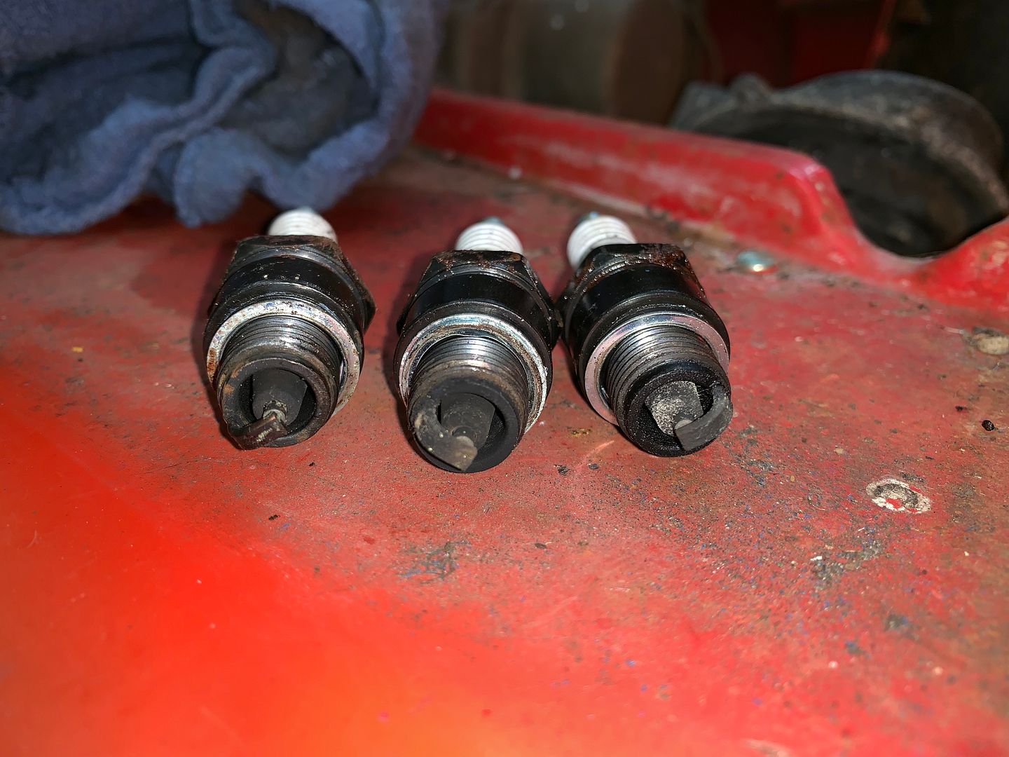

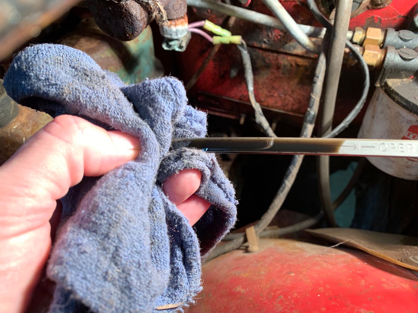

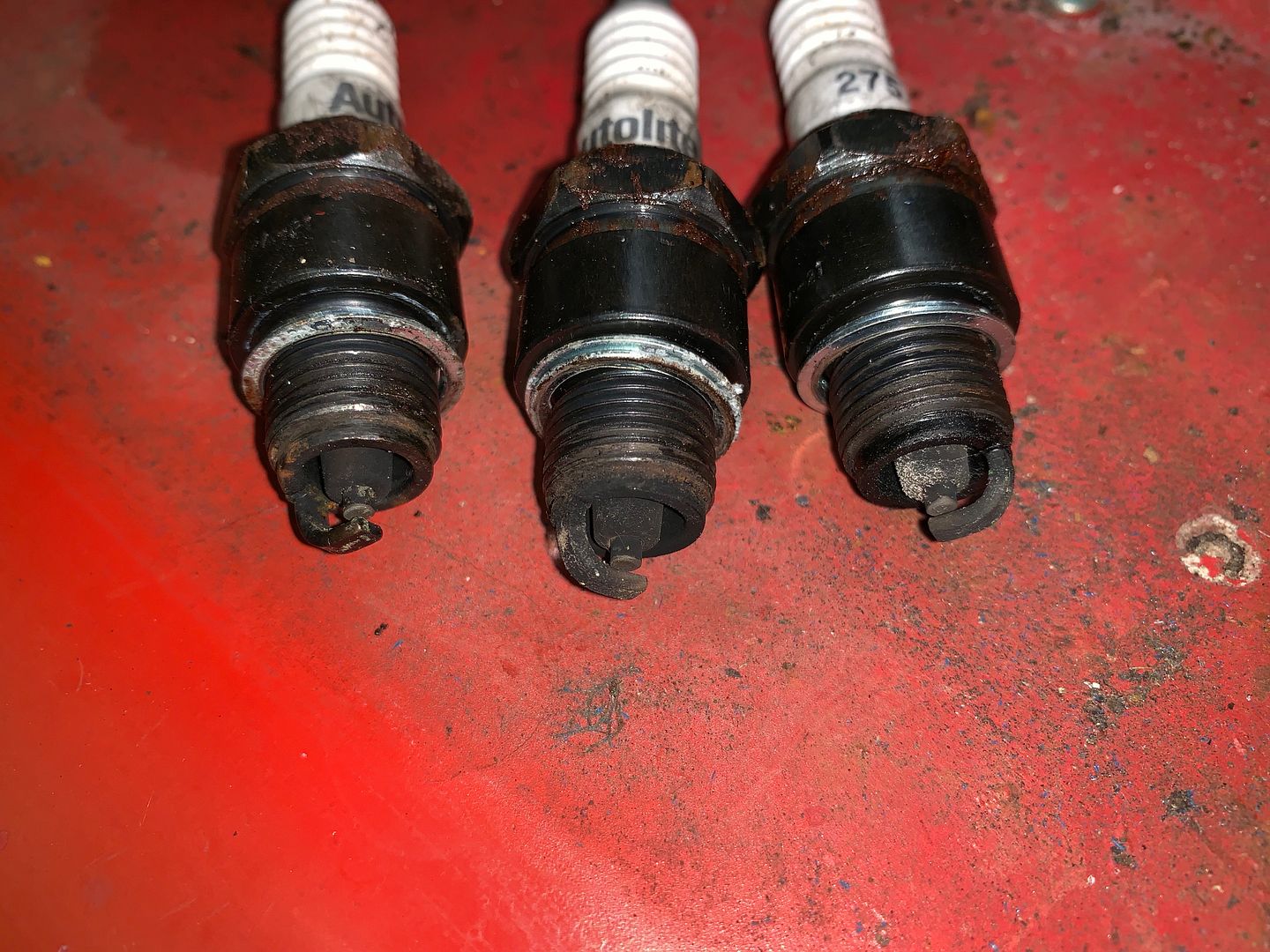

I pulled all the plugs and poured some transmission fluid down the cylinders. That is to help loosen things up if they are stuck. I did try to turn the motor over by pulling on the fan, and it did move a little, so that is kind of good. Then I put the plugs back in, just finger tight, so I could blow out the engine compartment. I should have done that first, but hey, it's done now. LOL
Plugs didn't look bad.
I checked the oil, and it's a bit black. LOL Course it is better then being milky brown. :D

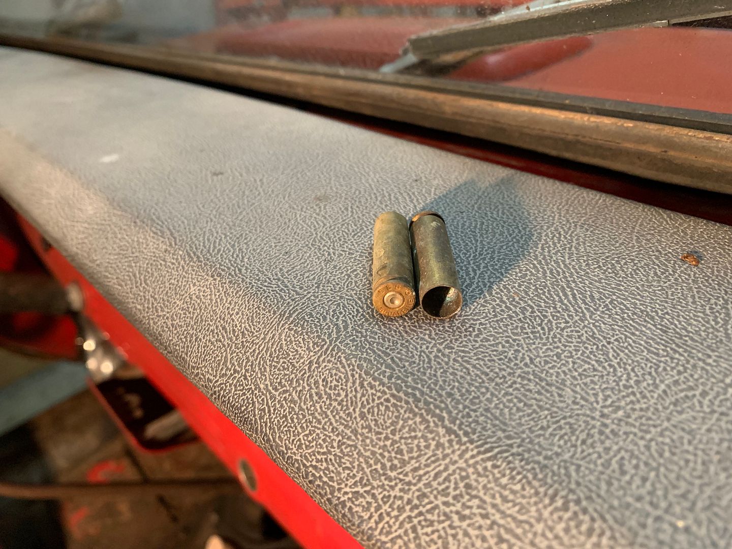

While blowing it out, I found these. Thought they were cigarette butts at first, but then picked them up and saw what they were. They will stay in the Jeep from here on out. It's just something I do when I get a new to me car. I clean it out and always keep something I find with the car. My Ford F100 has a pull tab I found in it that went to an old beer can. My bus has a pin I found in it, and so on. I will probably end up drilling a couple holes in the shells and hanging them from the mirror. :D

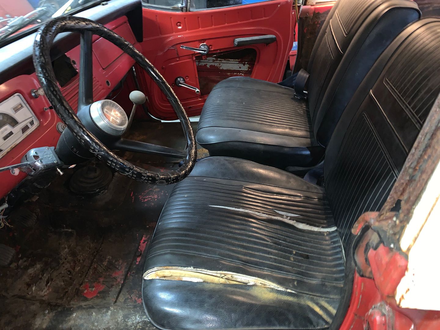

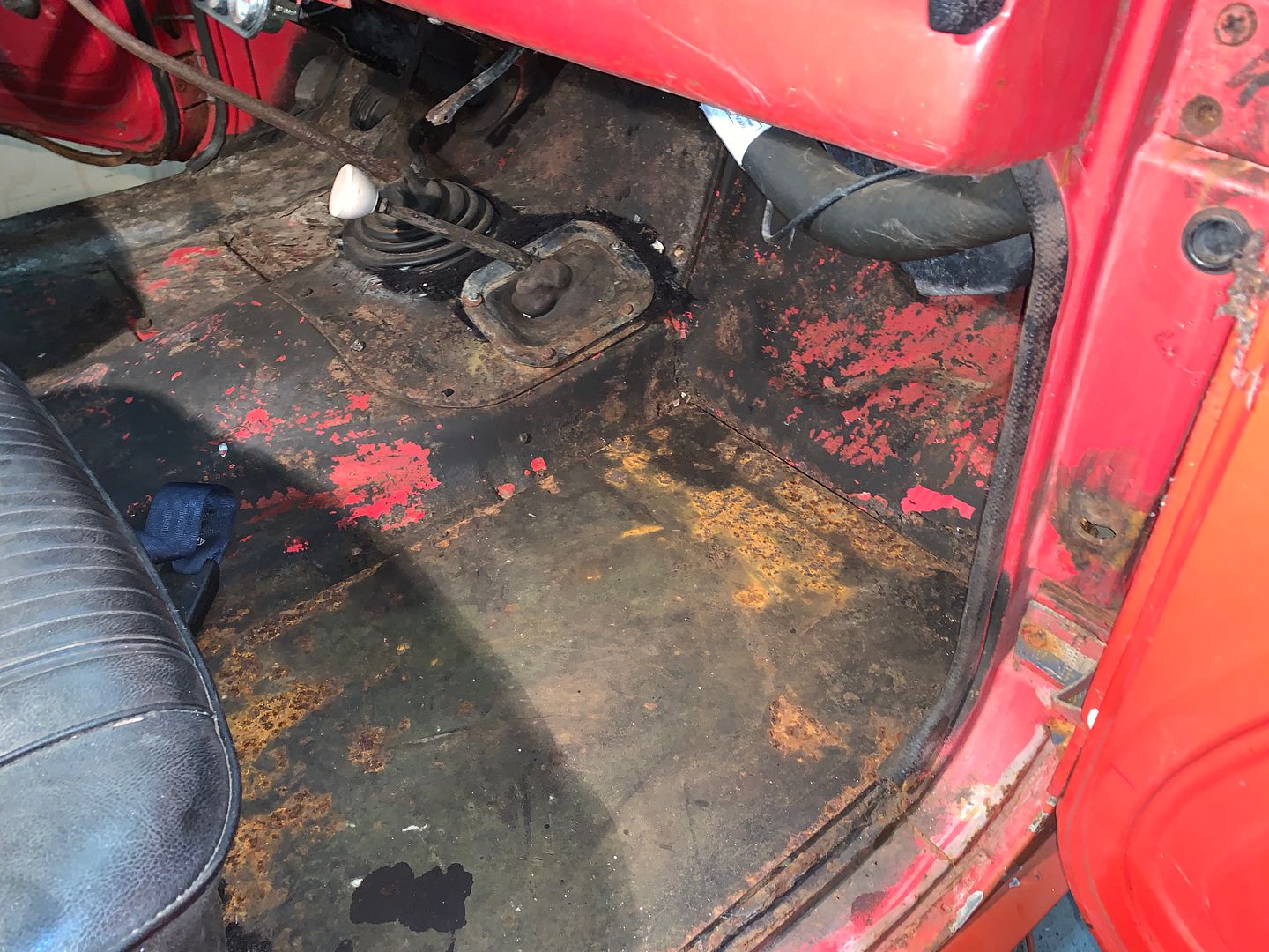

I sat in it and stepped on the clutch pedal and brake pedal. The seem kind of loose but not sure how they are supposed to actually be. Anyway, I looked up under them to see if I could see anything that would make them loose and that is when I spotted this. I have never seen a clutch cable go down through the floor like that. Interesting. LOL
This is the driver side floor board. As you can see, I will have some work cut out for me, literally, LOL. I plan on eventually getting that stuff out and maybe do some sort of a road sign floor or something. Not sure yet.

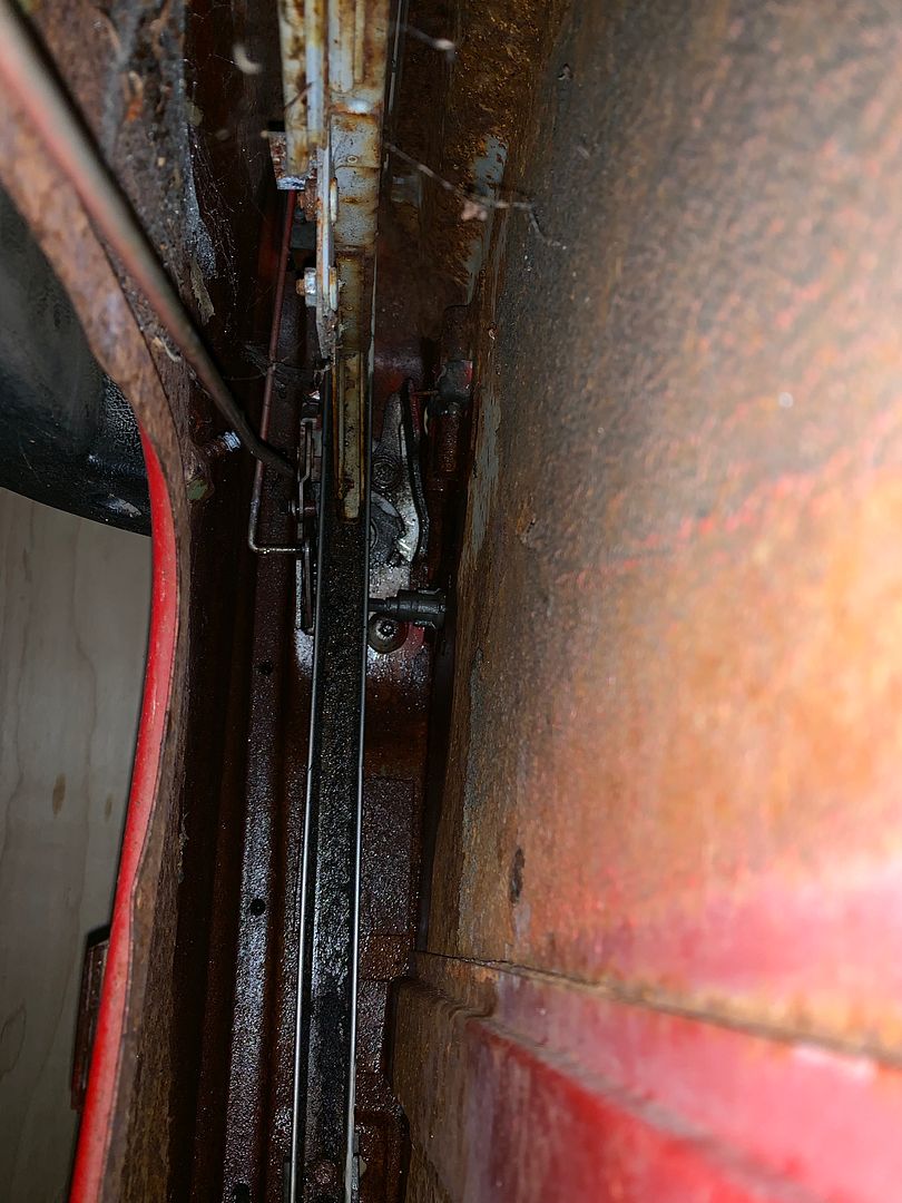

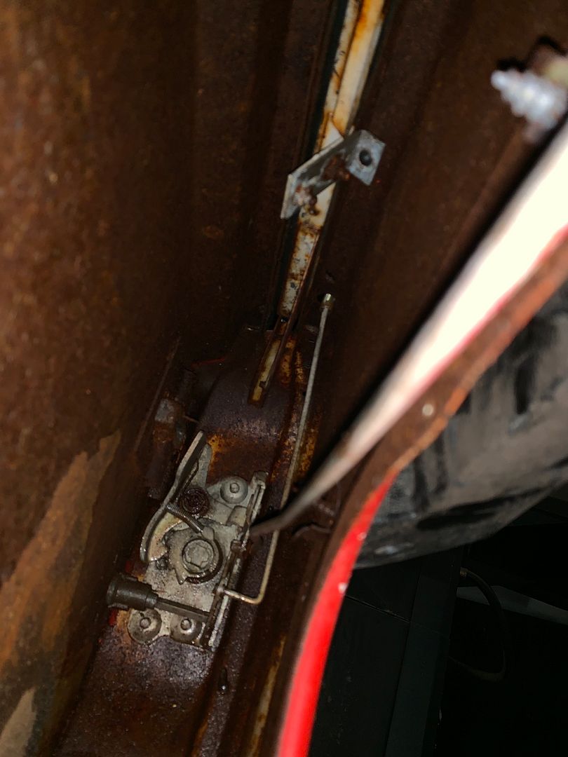

The thing I am most excited about that I accomplished today, was I finally got the doors to open and stay closed. :D
I still have to work on the windows. Tried as I may, I couldn't get those things to budge. I do think there is something wrong in the passenger door. I think part of the track is missing?
Here is a pic looking back toward the passenger door latch. I don't see a track.
This is the driver door, there is a track.
Any info you guy's have on the tracks for these, would be much appreciated. Pics would be even better. LOL I do better if I can see what the track is supposed to look like. :D
