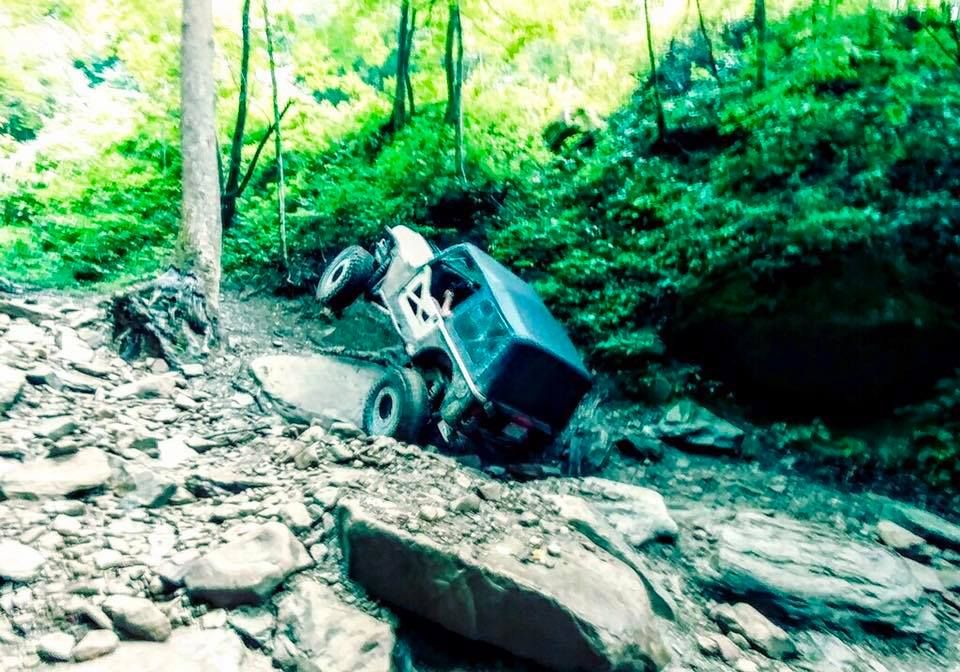

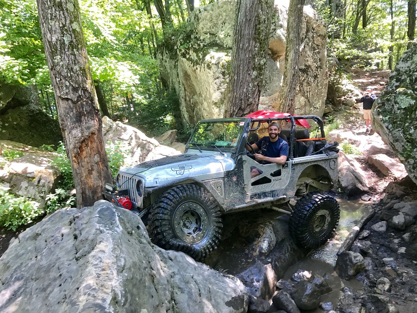

2000 TJ
3.5" metalcloak short arm lift w/ 6pack shocks (no body lift)
MC overlines with 4" flare
37" Mickey Thompson MTZ
Currie HD tie rod/drag link
Dynatrac Pro Rock 60 F/R - Width extended to 63.75" WMS/WMS - Stock WB needs hi pinion axles
ARB F/R, regeared to 4.88
Short shaft kit/np231
AX15 terminator
UCF no body lift skid plate
Drove 3 hours to AOAA, wheeled the black trails for 2 days, reconnected sway bars, drove home. No issues. Sits very low and handles better than stock.
It took a lot of planning and work to make it like this. I wouldn't trust too many stock axle/steering components to reliably handle 37's, even for a daily driver.
