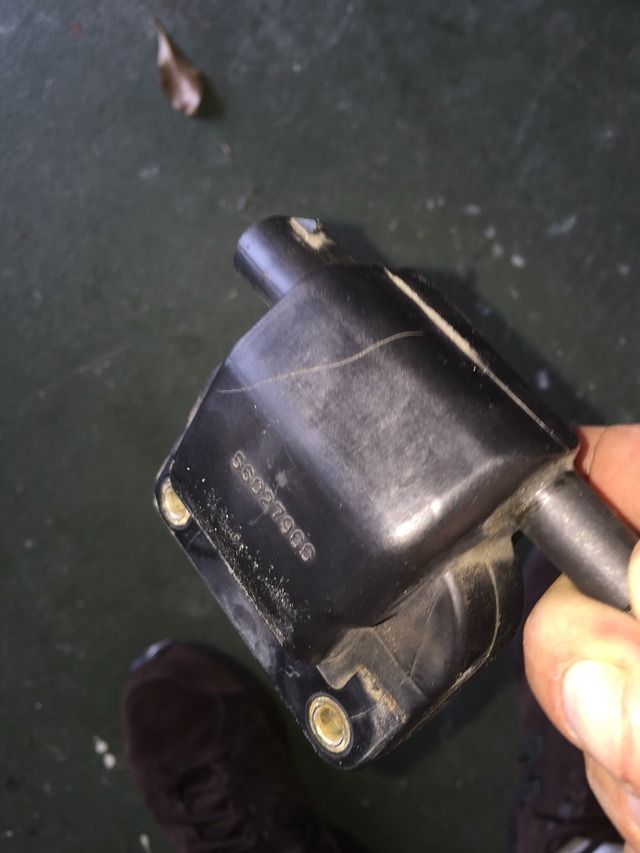

Removed the coil. It has a good size crack. I really don't think a new coil is going to change much though. Waiting to install it after I find one of the nuts that dropped…

That is a bad coil!
