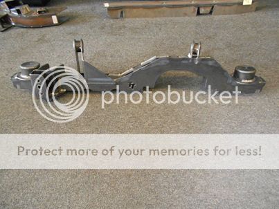

Well I did what everyone says DO NOT DO. I did a truss system, gears and ARB locker for my D30. I do wheel if some nothing crazy I try to keep all tires on the ground unless flexing. While doing some research I called AEV, Poison Spyder, and Metal Cloak talked to their tech department and asked their opinion on doing work to the factory D30 vs upgrading. They agreed with me that I would probably never see any issues as long as I did not beat and try to jump it. Moderate wheeling on trails with rocks and more so expedition run I would be fine. Now of course they said your best bet is upgrade to a quality D44, but I took the gamble and have been pretty happy.
Couple of things I suggest is if you have the axle built regardless of what housing you go with consider having it power coated while it is tore down. This is one thing I really should have done there is no good way to paint the inside of the truss and the bare metal will rust quick. I am in the military and travel all over my Jeep sees more highway than any trails I just want something capable if in 5 years I can upgrade to lets say a G2 axle then I think I got the use out of my D30.
90% of the trails I run:
Really I guess it depends on what you are gonna do, I would not take my JK out West with out rear 60 and front 44 RCD shafts ect. But here in the East I think I will be fine.

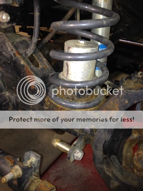

Glad to hear that your 30 is holding up! Good call with the powder coat! We do get rain in the desert sometimes! No salted roads though. I'm with you, I should never have more than one wheel off the ground at a time. Not all of our trails out here are killers, but you don't have to look far to find them!
Few months after install. Shop spray painted the metal, at this point all I can do it rust converter and maintain it.
