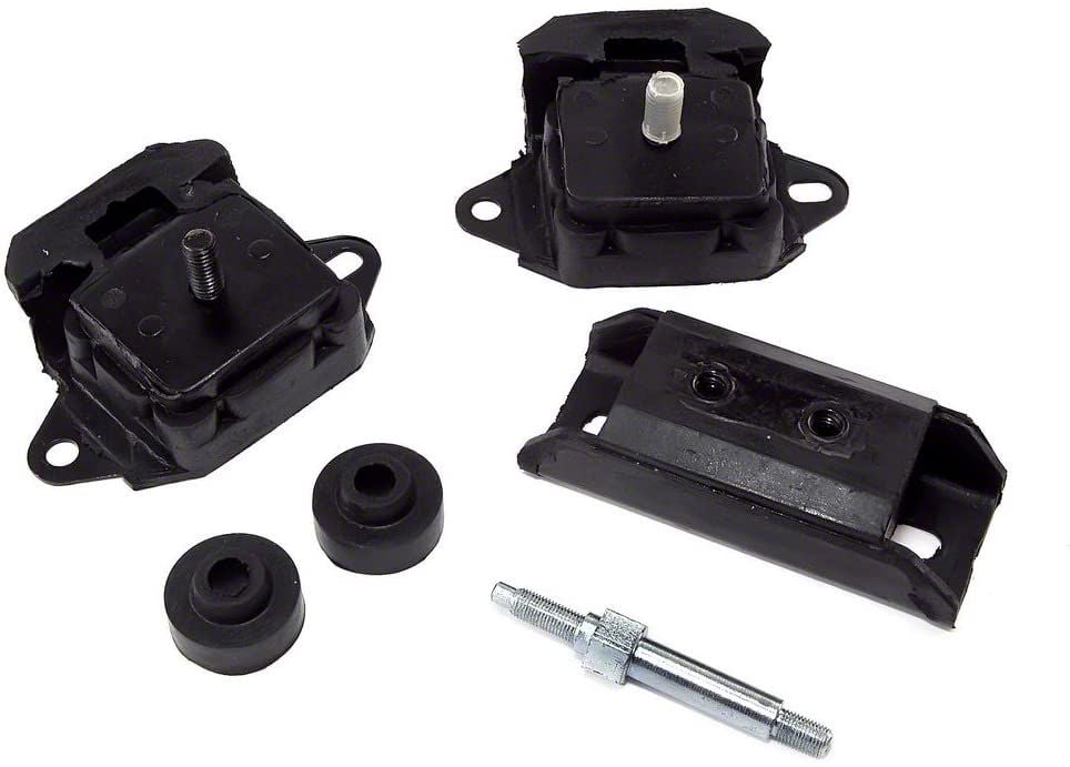

I think I need a new rubber dealy bob though that rectagle shaped one was totally worn out and chewed up.
I think i's ok and its not as big of a disaster as I thought. but I'm not sure yet till I put skid plate back on and whatnot.
Edit: While its off I'm cleaning up the old gunk and seeing that I probably should buy some new of the rubber mounts and hardware, these bolts are shot ( no threads on them one of them was loose for so long it ate all the threads looks like a smooth rod now lol ).
Luckily after this week I have 3 weeks of vacation to work on this thing lol. ( and hopefully not mess anything else up haha )

#36 ·
I found these, but I'm still looking. I think I did see some on advance auto parts for much less. The rectangle one on mine is so destroyed I'm not sure what it even looked like originally.
for a full kit. but doesn't look quite like what I need but has the front mounts too? if I fix those sometime also?
Here is what I need. ( everything is all wet and nasty as I soaked it in cleaner while the skid plates off )
