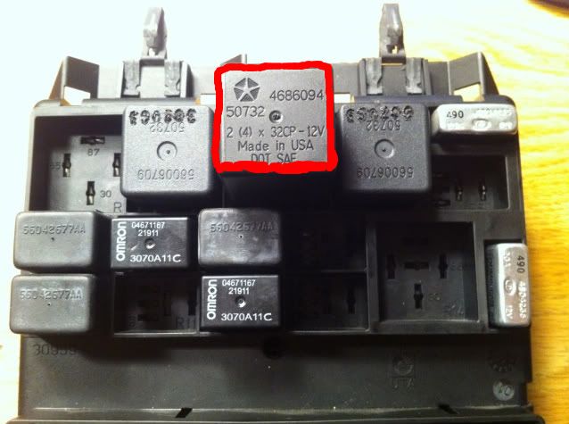

Step 1: Find your flasher relay and pull it out. It is above your fuse panel at the very top and its the one that sticks out the most. Circled below

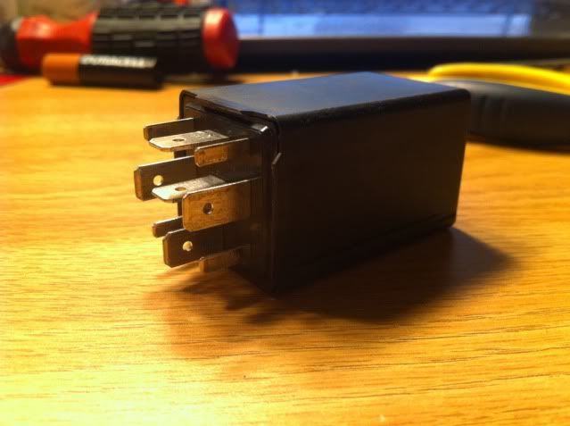

Here is your victim, looks fine from the outside!
Using a small screwdriver pop the relay open, there will be two tabs holding it in:

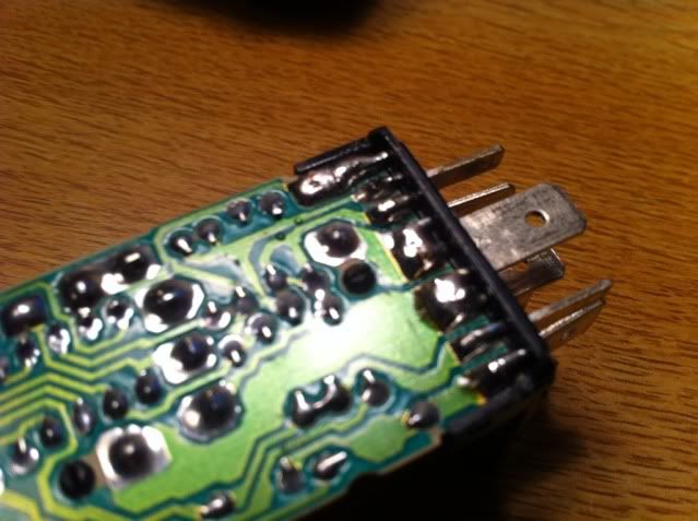

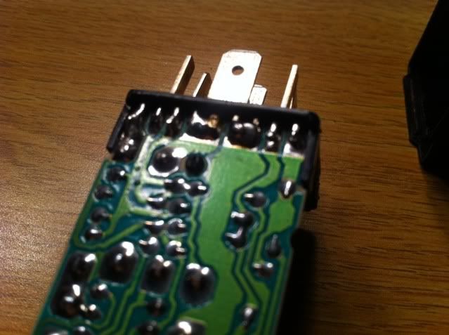

Slide it out and flip it like this. You can see the solder does not look well distributed at these edge pins. when these pins flex they break the weak factory soldering job:
Heat them up WELL one by one with your soldering iron and add some solder if it looks like it could use more. Make sure you dont bridge any joints with solder or you're going to screw something up.

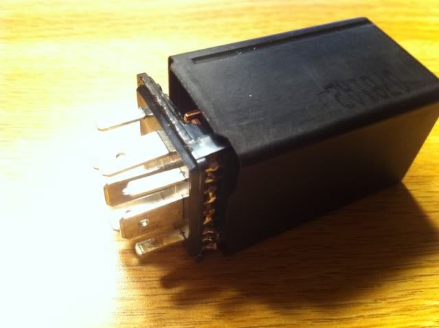

Pop the relay back together and stick in Jeep. Enjoy your working flashers again! I originally did this for the PO of my Jeep and it has been working for 2 years straight now. I figured I'd take it apart and show you guys how its done.
