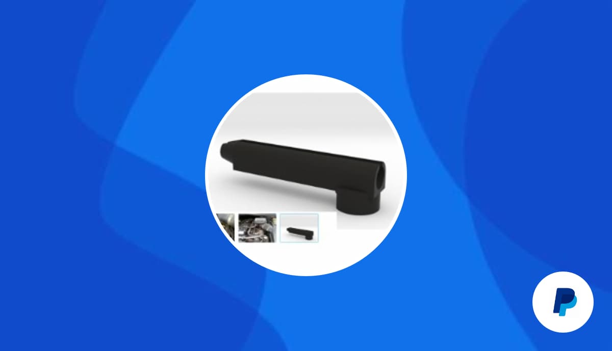

Below is a link to a replacement clip that simply slides onto existing cable.
Works great on my 2002 Jeep Grand Cherokee 4.0L, took about 5 min to install if you include crushing the old one up to take it off.
Modeled after the original that broke on my jeep. Didn't want to install a new cable for something so small and seemingly easy to fix....
Install vid:
Standard long style clip: http://shpws.me/F0rh
Metal version for super duty:
For a shorter style for older jeeps? Try this clip: http://shpws.me/H32m
Please let me know what ya think, how it works for you, or doesn't work right. Can be tweaked, just ask.
Shapeways is no longer in business.
Going forward you can purchase clips from me.
I currently only have the standard long version black 3d printed plastic clips.
$20 and I'll ship it directly to you.
Click link below
$20.00
What's this for: Jeep 4.0 Standard Black 3D Printed Plastic Clip
Selling items may or may not be allowed on the forums, however I am just trying to help fellow Jeep owners and others out. This isnt a very profitable "business". But it is my time and resources.
If you desire the short clip or some other material or color, drop a reply.
Thanks for your interest in the clips.
