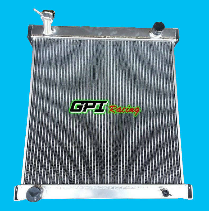

GPI Racing has an all aluminum one for $160. They even make one for v8 swapped TJs. I have used their radiators in my drag cars without issue. I've had one in my 'Cuda for 7-8 years now, but then again none of the cars I have/had them in ever see winter road salt or mud and they have limited street use. Mishimoto makes one too, but for 3x the price....

Most all moderately (or cheaply) priced all-aluminum radiators are shoddily constructed, so badly made that they'd leak like a sieve if their manufacturers didn't add a liquid epoxy lining inside the core. It'd be a pretty expensive all-aluminum radiator that didn't need the epoxy lining. Epoxy lining sounds like an ok idea but epoxy doesn't conduct heat worth a crap which negates most of an aluminum core's ability to extract heat leaving little reserve cooling capacity. And for only $160 you can bet it's one of the shoddily constructed types that don't last or don't cool well enough in tough conditions.
And in TJs, shoddy radiators don't last for another reason. The tub/radiator mounting area flexes enough to cause problems with radiators not designed to withstand such mounting area flex.
Personally, unless I was prepared to spend BIG $$$ for a high quality all aluminum radiator I'd pass an all aluminum radiator and try to find a Mopar. Mopar's has an all aluminum core which is constructed well enough to not need an epoxy liner.
