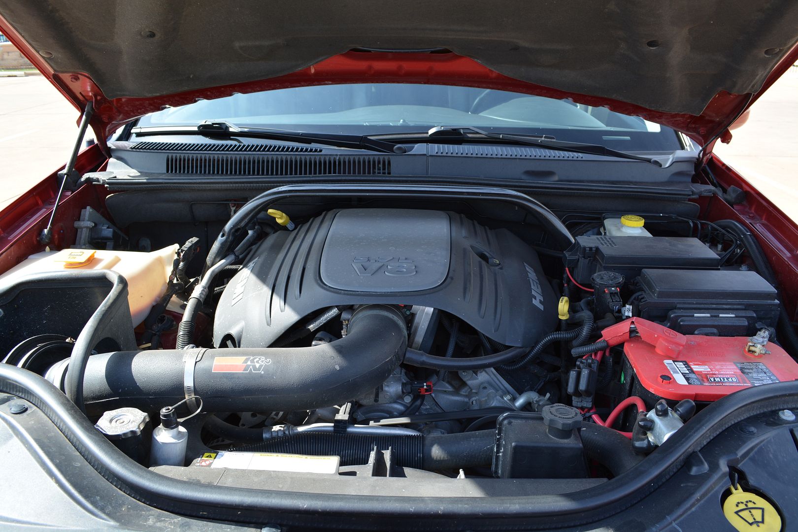

Okay, cleared the DTC's, discharged that system and gave it a crank. Here is the result, did not generate any DTC's after this. I am going to take the battery in and have it tested.
Edit: Battery is fine, tested good. I ordered a NorthStar AGM just to have the right size in there (Optima is 34r) but that is not the issue. Did not have time today to look at anything else. Coil swap will be pointless as the motor will not even start. Best I can do is pull the plugs and see how they look.

The engine is turning over just fine so its probably something simple keeping it from starting. It almost has to be fuel/air/or spark related. The fuel and air should be easy:
For fuel, there are 2 filters (that are unfortunately "non-serviceable") located in the tank that could definitely have gotten clogged up with bad gas or even ice if there happen to be some water in the tank. That or possibly a bad fuel pump? Its hard to hear so have someone else turn the key to the start position. You should hear it run momentarily.
Air is obvious. The K&N was pretty clean but you could try taking the cone off to start.
Spark is the more difficult one. It could be ignition related or a random sensor. I'd say pull a plug, ground it, and see if it sparks. But unfortunately its not that simple on the WK. From WKjeeps:
The 5.7L V-8 engine is equipped with 16 spark plugs. Two plugs are used for each cylinder. The 5.7L is also equipped with 8 separate and independent ignition coils. The one-piece coil bolts directly to the cylinder head cover and attaches the coils secondary output terminal directly to a spark plug using a rubber boot seal. A separate primary electrical connector is used for each coil.
Two knock sensors (one for each cylinder bank) are used to help control spark knock.
The 5.7L engine does not use a conventional distributor.
The ignition system consists of:
16 Spark Plugs (2 per cylinder)
8 Separate, Dual-Secondary Output, Ignition Coils
2 Knock Sensors
Powertrain Control Module (PCM)
Also to be considered part of the ignition system are certain inputs from the Crankshaft Position, Camshaft Position, Throttle Position, 2 knock and MAP Sensors.
It could possibly be a bad coil but you'd think it would still start with the other 7. I could be wrong though. You could also try using the Flashpac and returning it to the stock tune. I haven't heard of anyone experiencing problems with the 91 octane tune but it may be worth trying.
Honestly though, it sounds fuel related to me. It seems to start but barely runs like its being starved for fuel. Do you have anywhere warm you could park it overnight to see if you did possibly get some bad gas contaminated with water?
I hope you have some good luck here. Keep me updated.

After that I put in new cam and crank position sensors. They are cheap enough and a bad crank, which is a common failure on these, could cause my no start issue. Unfortunately that was not it. I am pretty settled on it being a fuel issue at this point. Now the pump is priming, the reason I was unsure initially is because the pump does not prime as my '04 WJ does. The pump actually primes when you unlock the Jeep via the remote. This is definitely a much better design as most people do no let their pump prime when they get in the vehicle, they just turn it full over. I normally hit the remote a good distance away from the rig. But I happened to be standing right next to is today while unlocking and I heard it prime. Just to confirm I locked it, crawled under and unlocked it, and it definitely kicks on.
Now the reason I think fuel is when I turned it over I gave it a little gas and actually got it to start. As soon as I let off it died. So I did it again and this time kept feathering the gas and it stayed running, but every time I let off it would want to die. I ran it this way long enough for my flashing CEL to come back (maybe 20 seconds) and turned it off immediately. Pulled the code and got P0300, multiple cylinder misfire. Unfortunately the 5.7 does not have a Schrader so I cannot hook up my gauge. Not sure where to go from here.
