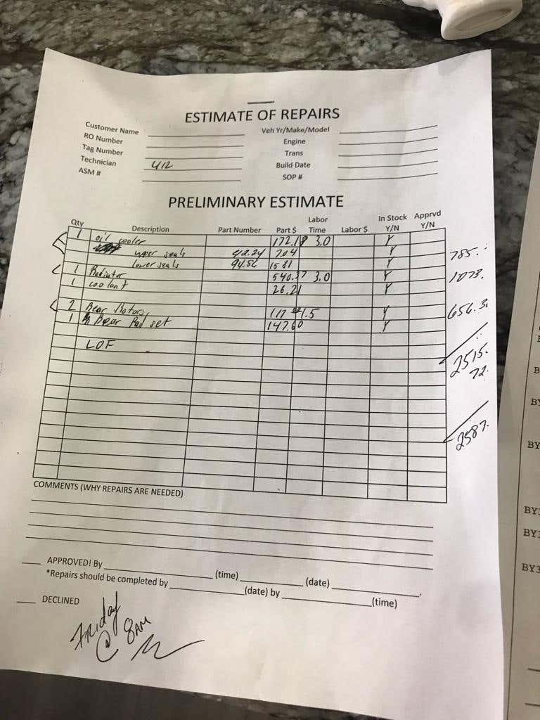

My 15 JKU, just 58k. The oil cooler started leaking when parked on an incline. The tilt caused oil to start dripping on trans cooler. I went to dealer and he wants $2,587 for oil cooler and radiator have little leak. Plus he said rear rotor and pad has less than 3”and soft, so that also needs
replacement. (6 hours labor). So any suggestions on good aluminum oil cooler bc I was reading it’s common for plastic ones to break again. So I can’t go through the dealer bc he will do plastic again. What do you think price should be going outside the dealer?

Dorman makes an aluminum one. Even though it is Chinese, it’s better than plastic POS that your Jeep left the factory with.
Unless it is warranty work or something to do with software or flashing a computer, avoid dealership service departments. They are happy to service you alright, as in bend you over. Not all are like that, but most are.
Replacing the oil cooler is not that difficult but it is very time consuming.

Yep I do it myself and 6 packs got Dorman I thought was made In USA Pennsylvania next state of course high tech. Not going to change oil the new young guy 90to 85% form plastic to tied . Plus is Mercedes design Chrysler bought soon new fiat Mini Cooper design. I found radiator have small leak in corner too so I order cold case aluminum
And rear rotors pads due so I am upgrading to Rt crown front rears set I bought all form forum vendor my good friend kolak in same time doing my sparks plug cleaning injector all service debating on sparks brand now what to get. Thanks for ur write and time sharing ur experience.
Ps: I found out changing O ring with the new Dorman to napa blue one will be Beefer and better.
