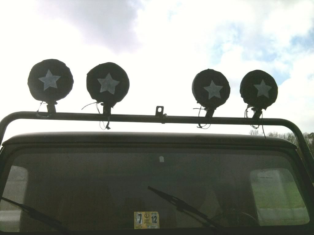

I was on a tight budget and i need light covers to make my lightbar legal. so i decided to make my own! got an old pair of jeans and started cuttin!
- started by cuttin a circle about 1"-2" bigger than the light itself.
- cut a strip about 4"-5" wide and about 2ft long.
- sewed a flap over for a draw string on the strip.
- sewed the strip around the circle.
- cut a circle of foam board that fit the cover for added protection and support.
- died them black and painted the stars with a stencil.

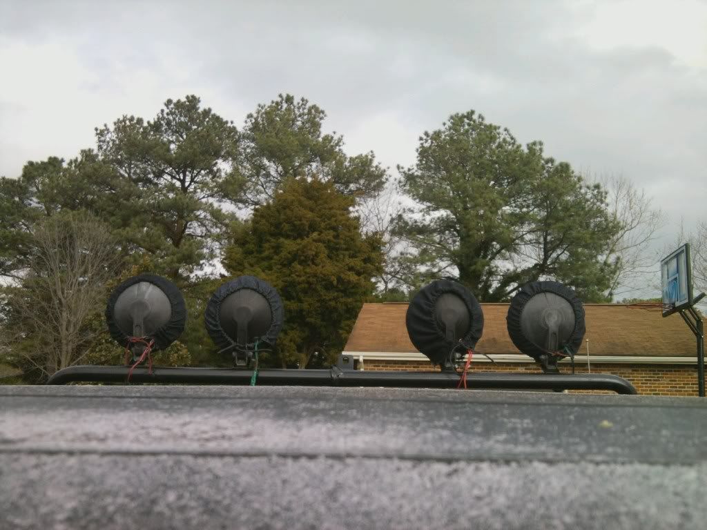

front
back
need to trim the drawstrings but other than that they are done. let me know what y'all think!
#5 ·
Only thing I can think of to improve this would be to but a large knot in one end (so the string can't pull through), with a large loop in it so you can tie it shut with the other end of your string, and never have to worry about loosing anything.
