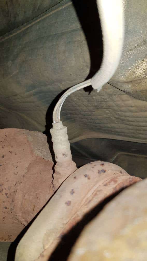

My TJ show today check engine light and P0138 code so it looks like new o2 sensor is needed
I had quick look under Jeep and there is 2 sensors;
1 at front and 1 and rear
Anyone know which I should to replace or maybe two of them???any part number???
Btw is Jeep Wrangler 4.0 2001 RHD with coil pack so 2001 onwards
VIN 1J4F4A9S41P365213
Front
Rear
That particular code is for the downstream (furthest from the engine) O2 sensor which monitors the catalytic converter for proper operation. However, while I normally just suggest replacing only the O2 sensor likely causing the problem, in this case I'll recommend replacing them both with fresh NTK (made by NGK) O2 sensors. The other O2 sensor, closer to the engine, is what monitors the air-fuel mixture and when it goes bad it wreaks havoc with your air fuel mixture which will cause stumbling, missing, and increase petrol consumption. O2 sensors are like spark plugs in that they finally wear out and need to be replaced.
