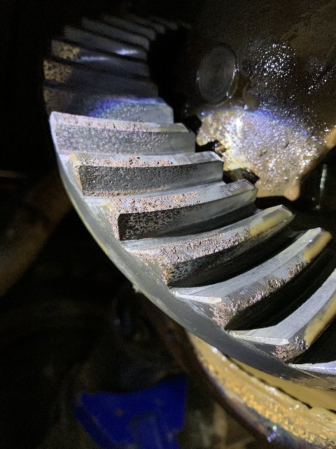

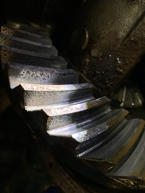

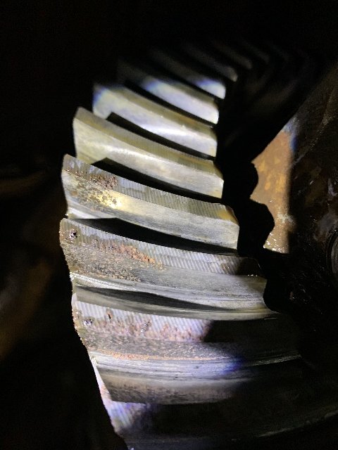

Update with more questions...
Hi guys,
I have an update to my thread, along with more questions! I installed the Spartan Locker in my D30 front diff, and it worked very well on my only off road excursion, which was power line trails in Gladwin, MI. Fast forward to yesterday, when I finally got around to pulling the cover off my rear AMC 20. I discovered two things. It is just an open diff, and, there is some serious pitting on a section of the ring gear teeth. I'm guessing it sat for a long time with the previous owner and the teeth that weren't in the gear oil did some rusting... My dilemma is what should I do? If you go back to the start of this thread, you can read all about my set up and usage. I'm thinking the easiest thing to do would be to buy a new set of 3.54 gears (about $230, I think), and try to install them without upgrading the carrier. I imagine it makes the most sense to put new pinion bearings and seal in at the very least. I still haven't convinced myself that I need any type of locker in the rear, based on my limited usage and success thus far. If I decide to upgrade to a locker at a later date, I'll already have the gears done. Of course, the EASIEST thing to do would be slap the cover back on, fill er up with lube and run it. Not sure that's the wisest idea though... Take a look at the pictures and let me know what you think. The rest of the gears look good, with no chipped or broken teeth. I have noticed a minor vibration at higher speeds, and I'm guessing this could explain that.
Regards,
John
#52 ·
How much shiny metal drained out when you pulled the cover? Did you hear whining while driving that started around 40-50 mph? If the answer is none on both those questions, put cover on, put lube back in and monitor with IR heat gun and listen for developing whine. You might get another 10, 20, 30K miles outta that. Depends on a few variables. Who can really say. That pitting will not cause the vibration you are feeling. That is something else.
But yeah a new ring/pinion is in your future. You know your mind will not be at ease knowing that's in there.

TIPPEDITOVER,
Thanks for the quick response! I did not notice any debris when draining. I’ll double check, as I drained it into a clean pan. Have not heard any whine, or detected any issues with the rear end. My main reason for opening it up was to see if it might have a trac loc in it. For as little as I use the Jeep, I REALLY don’t want to rebuild it right now. Plus, I’m planning on another trip to the dunes in May, and I don’t want to get it torn apart and not fixed in time. I’m thinking I will clean it out a bit more and do some inspection. I’ll check the backlash I the ‘good’ and ‘bad’ areas to see if they are significantly different. If all looks reasonable, I’ll seal it up, pump in some fresh lube, and roll the proverbial dice... Would you recommend 80W-90, or something different? I’ll update when I get some more inspecting done. Thanks again.
Regards,
John
