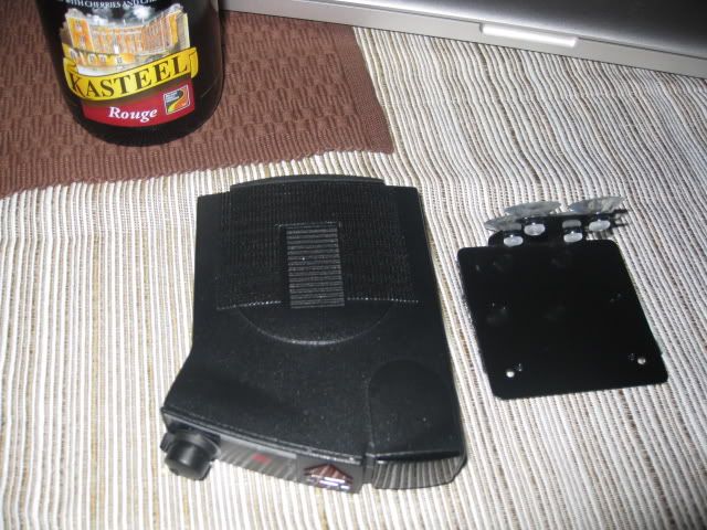

Anyhow, I have a Valentine1. The visor mount doesn't work b/c it just slides off and it will not rest at the proper angle. I dug through my parts drawers and found this:
GILSSON GPS ANTENNA SUCTION CUP MOUNT. Found them on ebay just now for 7.99. I feel that the four small suction cups provide great support for a Wrangler.
Garmin GA25 GA26 TomTom GO One Gilsson Antenna Mount - eBay (item 380196041144 end time Jan-17-10 10:00:43 PST)

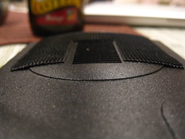

You can bend the mount backwards so that it works perfectly on a jeep windshield. Just get some velcro and you're good to go. If you have a V1, cut out a small area for the grooves, so it works properly in other vehicles. Install the velcro in your home and let it sit before using it in the cold.
Reminder, the bracket comes in the natural position for a car w/s. But if you bend it, it will work
You can customize it for any angle. Here is a pic of mine installed:
Since then, I removed the bracket, bent it a bit, so it does a better job of accepting the slightly round top of the V1. Pictured is the mount flat, and then bent to fit the V1 top.

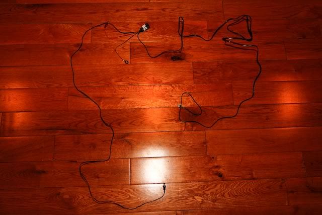

1. Order extra V1 mount and remove suction cups.
2. Order hardwire kit with integrated mute switch (round).
3. Start to run your wire from the mirror down through p-side door and across back of dash behind glove box.
4. Run the power cord to the cig lighter. Tap into the blue and pink with a t-splice connector. This is a switched 12v source. DRIVE SIDE 12V. There is an inline fuse in the hardwire kit, so it's safe.
5. Run the ground (it's linked to the power cable, so you can't go too far with this) up to the Bottom-left bolt for your stereo or mygig.
6. Drill hole in interior dash panel for mute switch, run switch into hole and lock with included lock washer and nut.
7. Hold up your V1 to desired location and get an idea on where you want it. Remove the radar from the mount. Use a pencil and mark the holes. Drill the holes with a tiny drill bit, to get them started. Insert some small screws.
8. Put the mount on and make sure it all lines up. Put some 3m foam in between to provide a little cushion/dampening.
9. Temporarily install the radar on the mount, if it all looks good, remove unit and tighten screws.
10. Rock n roll.
Again, Xtremjeepn deserves the props for this install. I prefer my switch method b/c my gf likes to hit the mute button, if I'm not paying attention. Xtremjeepn went with a flat mute switch on the steering wheel. Good stuff.
