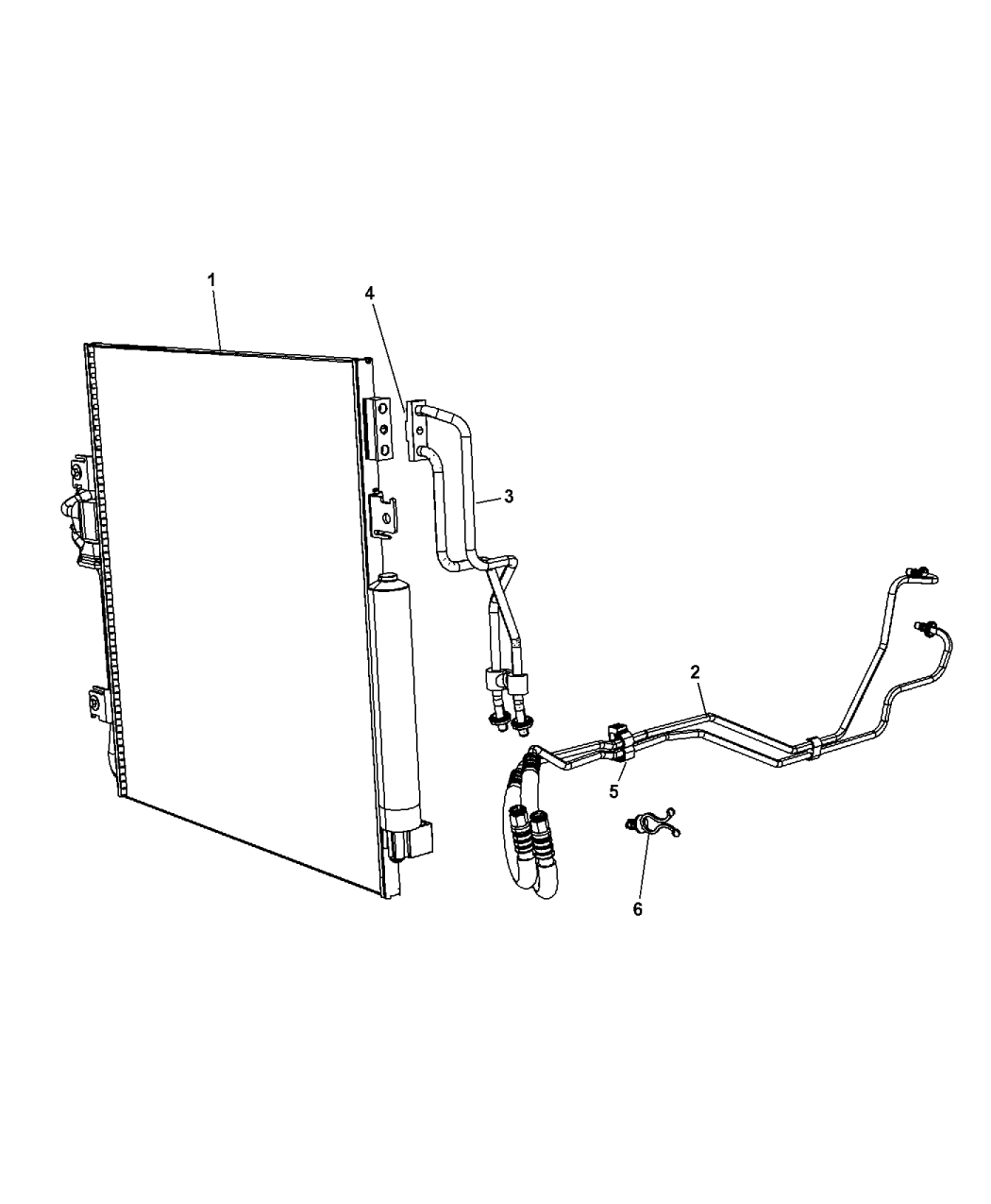

I am about to do a tranny filter change on the 2012 KK with 80k miles. I want to do a fluid exchange after that. I hook a clear tube to the return line and pump the old fluid out until it runs clean. On my XJ the return line was obvious. This KK not so much. Anyone know which line is which?

It is my Daughter's car and if you have Daughters you know that you have to make an appointment to do anything on it. As it is I am giving her my car so I can work on hers but I want to go at this as prepared as I can.I don't even know how the lines are connected. Quick releases? Nuts? Best place to open the lines?

I eyeballed it today. You can't even see where the lines bolt to the radiator. But the hard lines meet the flexible lines down at the bottom and are secured with the quick-connects. That looks promising so I will see about getting the connections apart without breaking them. There is a special tool for this (of course) but I read that a pick tool will get the spring off. Just don't lose it.

Well here is the factory tool to use on the "Jiffy-tite". That's what the quick connect actually is. It is very expensive so I ordered the Lisle long version. The lines are 3/8" but very close together. I don't see enough room for the round tool getting the fitting open. The long tool has a smaller head and there is plenty of room to swing it down there. The good thing is that whatever line I get open, the oil will drain straight down.. Hopefully I will find the right hard line so a plastic tube can go right on.Making progress!...................................................................................

OK I figured out what is what. In this drawing the #3 and #2 lines are the return lines. So looking at it from underneath you want to open the passenger side fitting. I tried to use the tool to get the "Jiffy-tite" thingy open. Naming it "Jiffy" is particularly cruel. The line and fitting were so corroded that I ended up using the pick to pry the little spring clip out. DON"T LOSE IT! Then I had to use a wrench to turn the hose end while pulling to get it off. NOT EASY!!! I'm sure it went right together smartly at the factory and if you went to open it the next day it would come apart like butter. But add eight years of weather and road crud/salt and you have a nightmare on your hands. I cleaned it as best I could but I will be praying it doesn't leak later. Also the RTV sealer they used for a pan gasket is another joke. It was leaking all over and several of the bolts were hardly even finger tight. Spend the $4 and get a real gasket. Then schmear both sides with Permatex Ultra Black. It won't leak any more- trust me. The oil pan was almost rusted through at several spots. Good old Mopar-Metal. I sealed it with some epoxy paint for now. It's not that expensive but I am in a hurry and can't wait for it to ship. No one has it near me.

All done. Judging by the condition of the pan I believe that it would have rotted through and leaked oil probably at the worst possible time. So much for "lifetime" fluid when the pan rots before the oil gets changed. The "Jiffy-tite" went back together OK but I tried using the tool to get it apart again and it was a waste of time. Just useless. Here is another tip- dig out your torque wrench for the pan bolts. I used a FelPro gasket and I schmeared both surfaces with Ultra Black. Using a nut driver I replaced all the bolts hand-tight. What I thought was tight enough was nowhere near the proper torque of 12 inch pounds. Use the torque wrench and go around and around sneaking up on the final torque. 12 inch pounds will not distort the gasket and squish it out. I also put a dab of Loktite blue on each bolt seeing as so many had vibrated loose. Don't forget that the second bolt from the front on the driver side gets sealer. It is right under the pressure test taps. Only a single YouTube video out of many knew about that. I hooked a clear 3/8" hose to the steel return line and ran that into a big clear jug. Run the other hose into a pan too as it WILL drain fluid. I used some 3/4" heater hose. Once that was done I filled the pan with a gallon of Mopar ATF+4 and ran the engine so that the old fluid came out. Shut it off and refill. Run again. Keep doing this until nice red fluid comes out. Then let the lines drain and when empty you can re-connect them. The "Jiffy-tite" snapped right back together and did not leak. Then it was time to slowly fill the pan a pint at a time so that you sneak up on the proper fill depth. You use the dipstick tool and factory chart to see that at 70° the level is 20mm. Once you get to that level you can go for a ride to get the fluid good and hot. It came back and I checked the pan with an infra-red temp scan tool. It showed 171° and if you add 5 degrees for the internal temp that is very close to the ideal 180° the FSM calls for. Then you adjust the fluid level to 44mm for the target level. Then you get it back on the road for a test drive and re-check the level. Too much is worse than too little. . It ran great and I am confidant knowing the filter and fluid are fresh as well as the pan is now rust-proofed.
