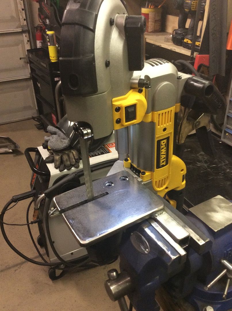

Portaband (with DIY stand similar to Swag off road) I am still suprised by the versatility of this tool, Its quiet, super easy to control and do angles with. Behind an angle grinder this would be my #1 recomendation.

Get a used portabnd off of craigslist and make a stand. Yep they are expensive but blades last a long time. It makes fabrication much more "fun" for me.

Thanks for all of the replies! I have myself a nice heavy duty DeWalt angle grinder, so it sounds like that will be primary tool when working. After reading all of the replies it seems like many people utilize their chop saws but more so their portabands. I feel like it would be a lot easier to cut perfect 45 degree angles with a chop saw rather than using the portaband, however I have no idea. Is it practical to achieve cut clean and accurate angles with the portaband?
A chop saw or horizontal/vertical bandsaw would be better for accurate miters, but you can get pretty dang close with a portaband mounted the way I pictured. I mostly use my modified portaband for cutting small pcs of plate or lopping tube before bending....bigger pcs of plate get plasma cut. I don't really use my chop saw very much because it's messy and super loud.
