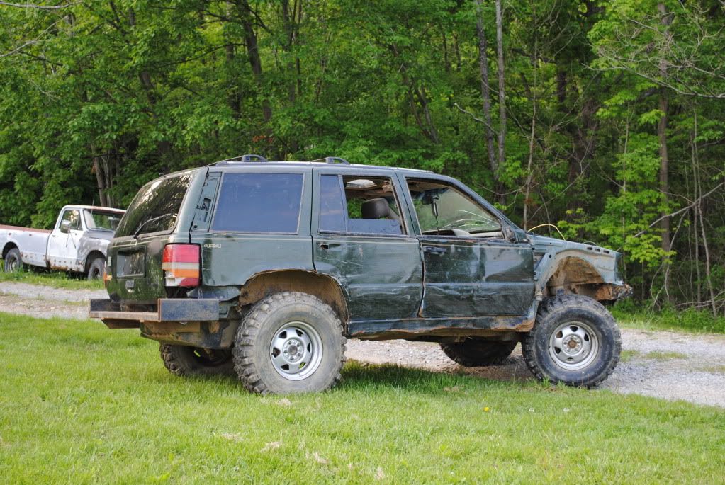

34x10.5-15 on only a 2" BB. gotta get some wheel spacers for the front as i rub the control arm pretty hard, but otherwise clear pretty well
See less See more
You didn't have to trim anything around the wheel wells? How much of a spacer will you need? I want to do something similar with 33x10.5x15.
well, front fenders are gone as you can see with the body seem beat flat. Rears were already trimmed as well.
probably gonna go with a 1.25" spacer, should be me clear of the control arm but i may need to trim a bit of body once i do that to get them to clear while turning.
