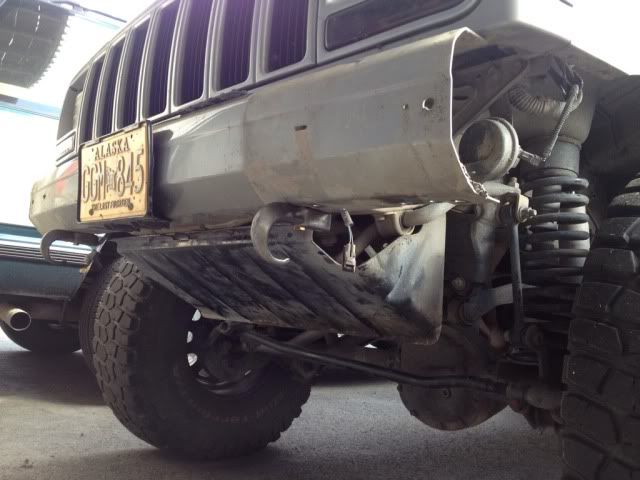

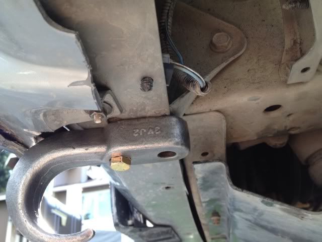

From my build thread
JY skid and 15$ eBay hooks
arent those skid plates useless ?
and are those just hooks? no tie ins, nothing?
From the picture it looks like there is only one bolt per hook going through the bumper... I know I wouldn't use that as a recovery point.
I'm sure the skid plate isn't completely useless.... It's gotta be worth the 20$ I paid for it
Where should I mount them? The bumper mount only had 1 hole or I would have used 2 bolts
Should I drill another hole?
See less See more
I feel like your bumper would start to warp if you tried to use it as a recovery point. Either that or your tow hooks would rip out. I would get some recovery hooks that mount directly to the uni-body. Seems a lot safer :2thumbsup:
I guess there going to be for looks for now :-/
Those are going to become missiles if you get stuck and use them for recovery
I don't get stuck ;)
You need to use proper tie in brackets or that tow hook will become a missile.

Or find a set from a JY.
You need to tie into the frame or you will destroy your bumper and possibly kill someone.
What about when your buddy gets stuck then?
On a full frame vehicle attaching a tow hook with BOTH bolts is fine.
On the Unibody XJ, you need more.
The stock bumper is like tin and held onto the tin unibody by only 3 small bolts.
Rusty's
C4x4
This was the info I was looking for! Thank you!
The internet sucks at showing scarcasm. :-/
