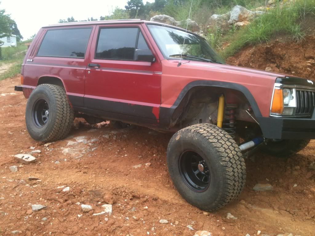

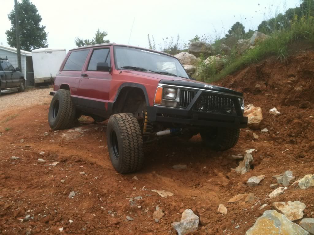

Detailed mine and did some touch up painting on the rims. Had to switch out the mudders (not enough tread) to some weak A/Ts last week :( There only temporary until I can find a good deal on some more mudders. I tried wheeling it with the A/T's and it was dissapointing. I NEED MUDDERS! The rims got scratched up from being broken off and remounted so touched that up, and detailed it from where it had gotten dirty wheeling.
