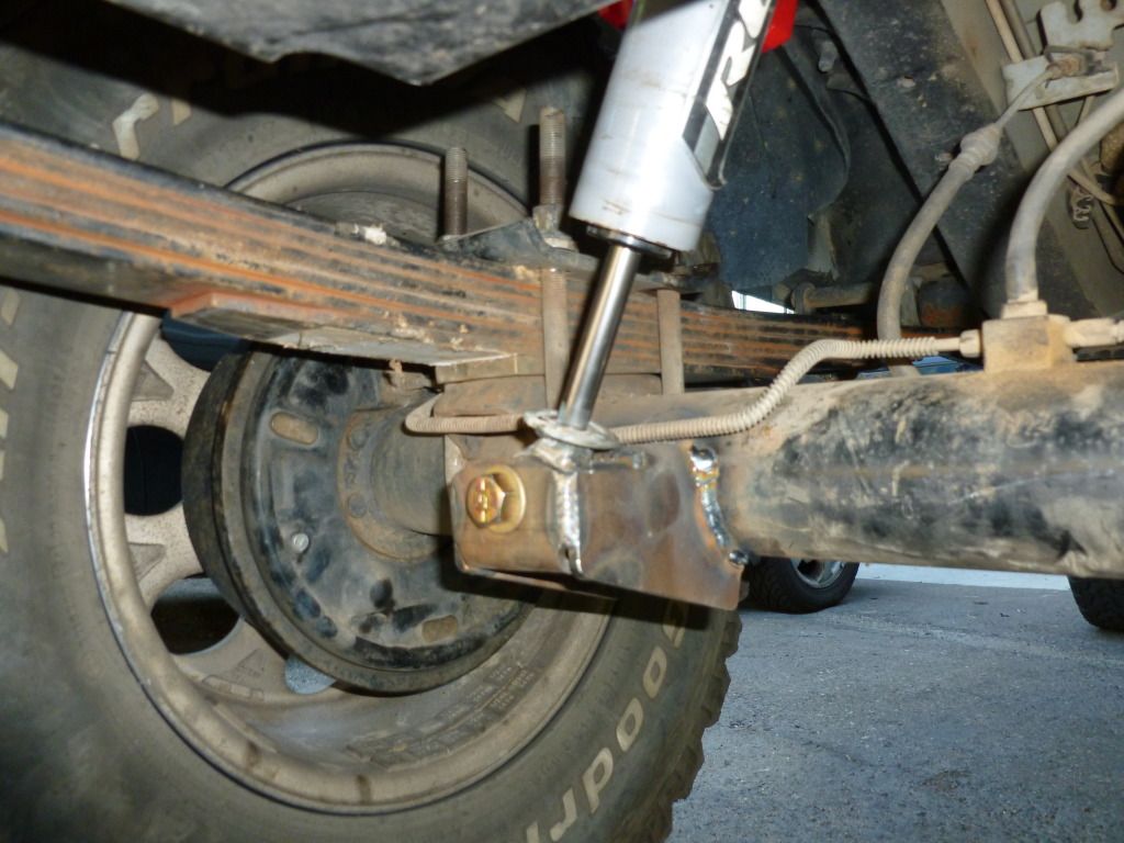

raised my shock mounts with a set of polyperformance mounts.
looking at 4" of up 5" of down in the shocks and that angle gives me about 6"up, 7" down in the tire.
I need longer shocks.

Nice, very nice
I've always wanted to get rid of the low-hanging mounts!
Got any more pics of the process?
How much work was it?
Are you using stock top mounts?
more pics?
2
Nice, very nice
more pics?

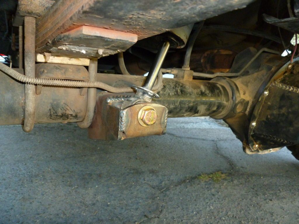

it was pretty simple. I used a set of polyperformance shock mounts, cut the factory mounts off with a cutoff wheel, and welded these on. I am using the stock uppers.
the plan is to go through the floor with a set of 7100s later on. but these will work for now.
http://www.polyperformance.com/shop/Synergy-Suspension-3-Radius-Shock-Mount-p-771.html
a couple more pics
