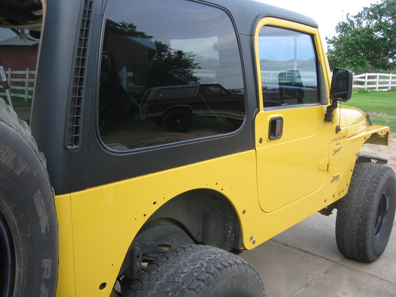

In April of 2007 I picked up this Wrangler TJ from a local seller. He was the original owner and needed a truck so it was up for sale. Here's a pic of what it looked like the first day I saw it....
(And no, it didn't come with the cup of tea) ;)
It was cosmetically "okay", but had a few hail dings on it and some paint flaws where it looked like some brake fluid had splattered on it. It's not noticeable from a few feet away, however.

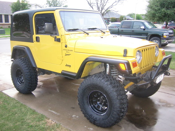

So I immediately ordered some new 35" Maxxis Big Horns for it, gave it a nice wash, and painted the flares the seller had given me and installed them. BIG difference if you ask me. I also installed some RE quick disconnects.
I also discovered that the owner had incorrectly installed a dropped pitman arm. I replaced it with a stocker to get the draglink and track bar parallel and the bump steer was GONE! :D However, it had some death wobble issues I needed to work out. Not often, but "often enough". ;)

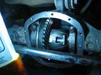

For the front I opted for a Lock Right from Richmond. Got it knocked out one evening after work. Here it is in operation just after installation (yes, I know the sound is out of sync for some reason):

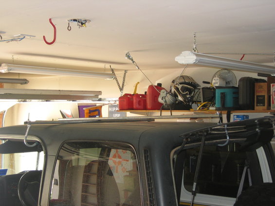

Before I sold the hardtop I made a hoist for it. The winch was a Harbor Freight special that cost me all of $20 and it included the cable and hook. The pullies and such came from Tractor Supply.

So I did a LOT of research and decided to install a full spool. The price was right at $100 and it would allow me to be locked for the Jamboree. If I didn't like it I could always remove it and sell it for close to what I paid for it. Who knows, maybe I'll like it. Keep in mind this Jeep is still often driven on the street.... Some folks said I was nuts. I never claimed to be sane.
See less See more
How do you did those shoulder washer?
I don't have pics of the spool install, but you've all seen that stuff before. It went well in one evening over the course of a couple hours. So how did it handle? On the street it was....interesting. It really binds up at low speeds requiring more throttle than you'd think. It squeals the tires when taking tight turns...sometimes the inside tire spins, sometimes the outside tire drags! The latter was unexpected. Other than that, you'd never know the spool was back there. And it drives very nice and straight. Above all, it's very predictable which was a key element. Keep in mind the rear swaybar is still off at this point.

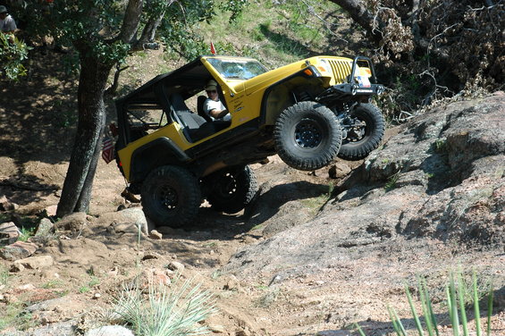

It was mid way though the day I noticed the Jeep was doing the "spool lift" pretty badly. It was at a break area that I noticed my rear sway bar endlinks (PLASTIC!!) was broken so I was running with no rear bar! Given the off-camber situations we were in that made for some very, VERY scary moments.
Here's a pic showing how the Jeep jacks when taking a tight left hand turn on a grippy surface like granite. I'd turned the wheels to the right in an effort to flatten it out before we got out to have lunch:
Image uploading. Refresh page to view
Scary as hell!!! Especially when you consider I was only half way through the turn at the top of a mountain with a steep drop off. :eek:
Fortunately, I managed to get through the day without rolling it.
