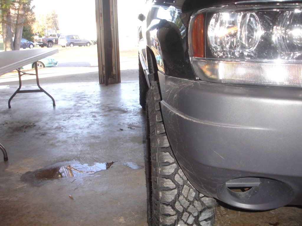

This is how far they bumped out my 245/75R16 tires:
