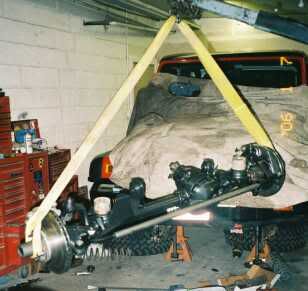

Just my 2 cents, When I first got my jeep on 05, I primed the entire frame with Rustoleum primer and Rustoluem professional paint. Came out really good, and still holding up today. Dirt and mud wash right off. The primer is pretty heavy.
Some pics for your enjoyment.
