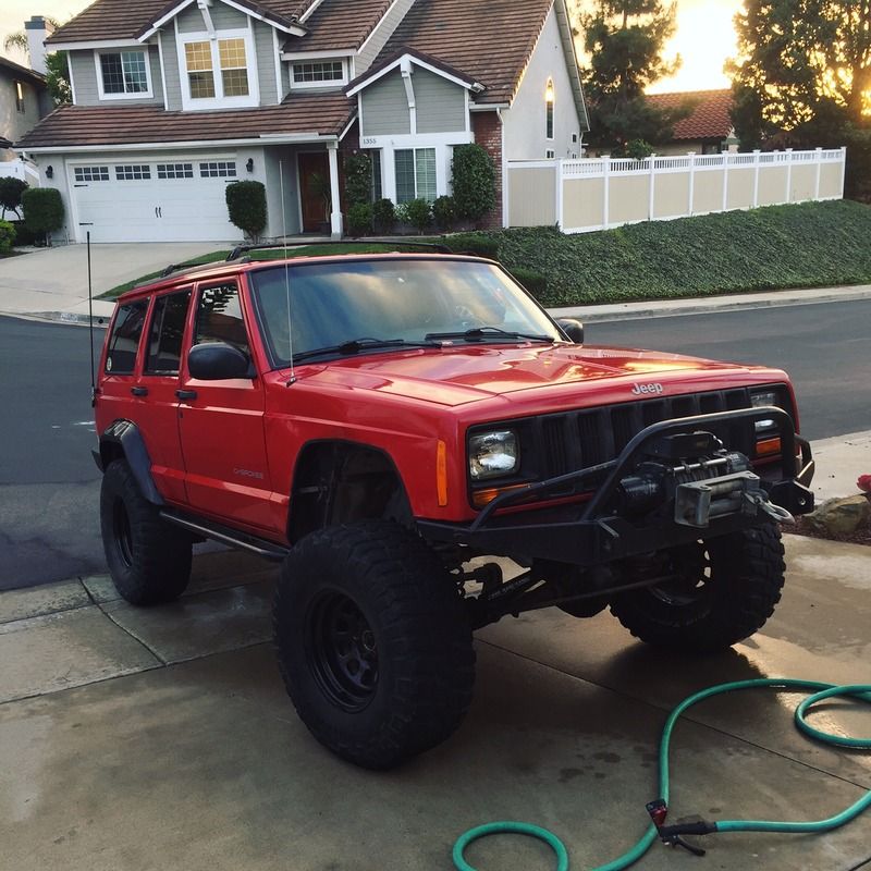

Anyway, here are some pics of when I first got her home:

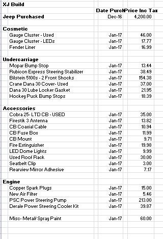

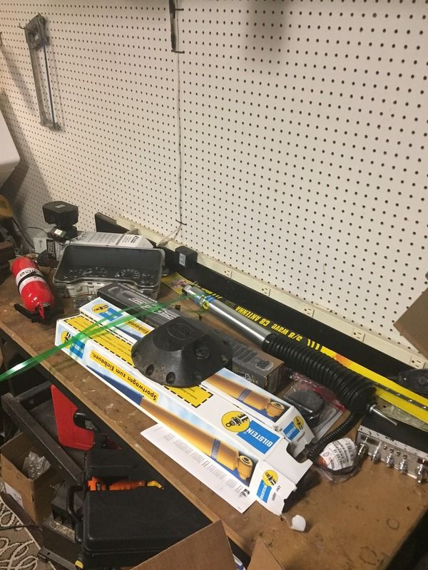

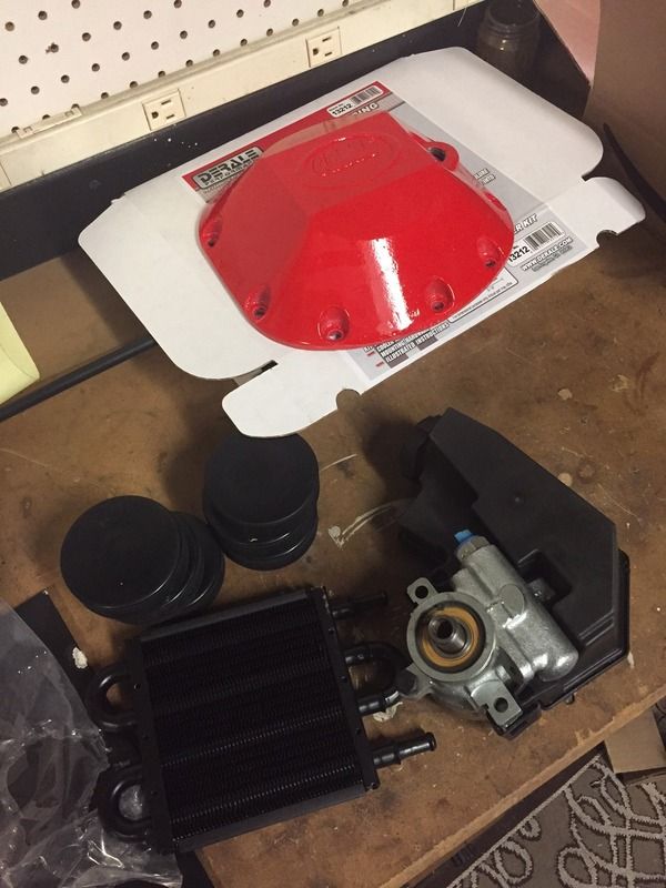

Then I started buying some parts:

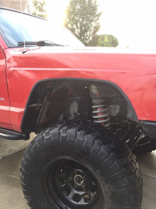

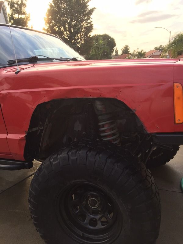

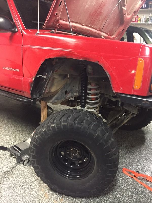

Heres the fender with the flares torn off before and after i gave it a little hammer work and fender liner:

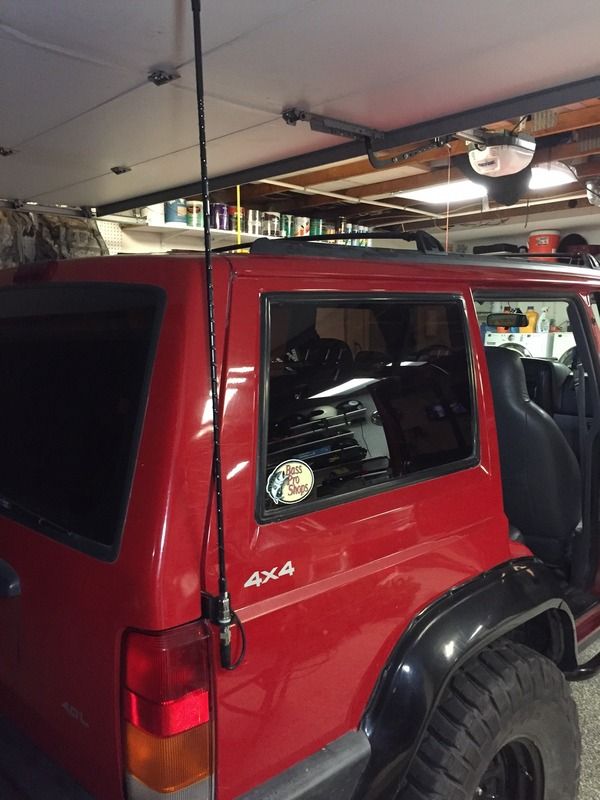

Then I installed up a CB. Made a bracket for the antenna and for the headliner that utilized the sunvisor brackets:

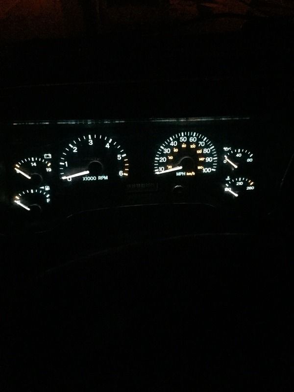

Installed a new instrument panel that actually has worthwhile gauges on it, and threw in some LED bulbs while I was at it:

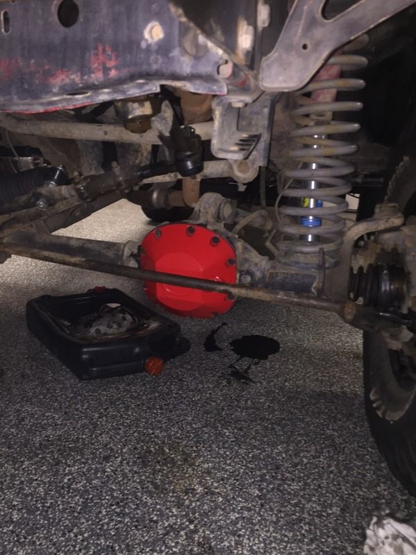

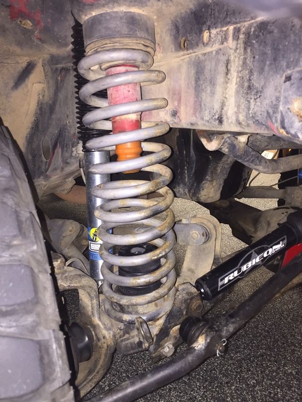

Installed some Bilstein 5100s up front and drooped the axle a bit for fun:

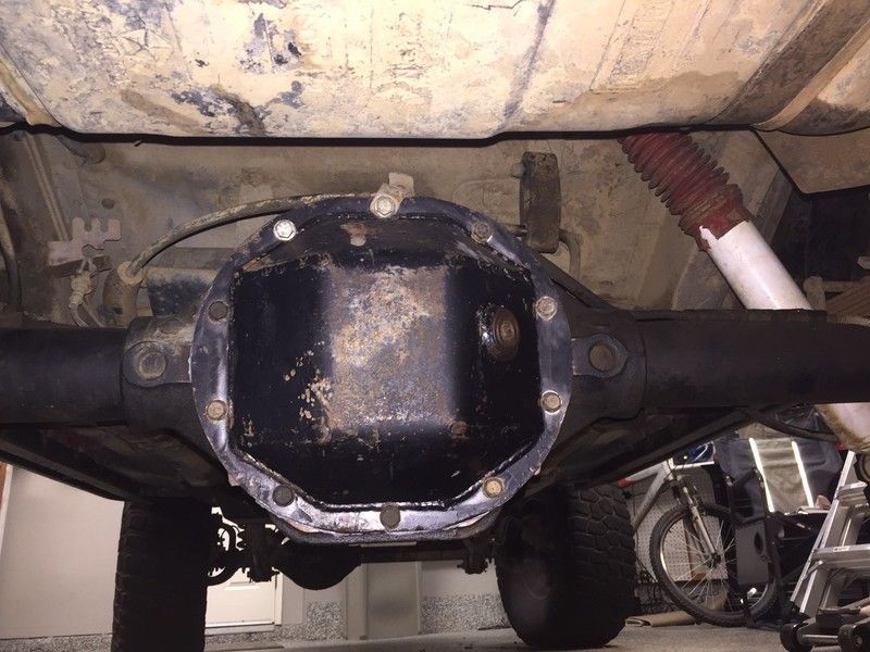

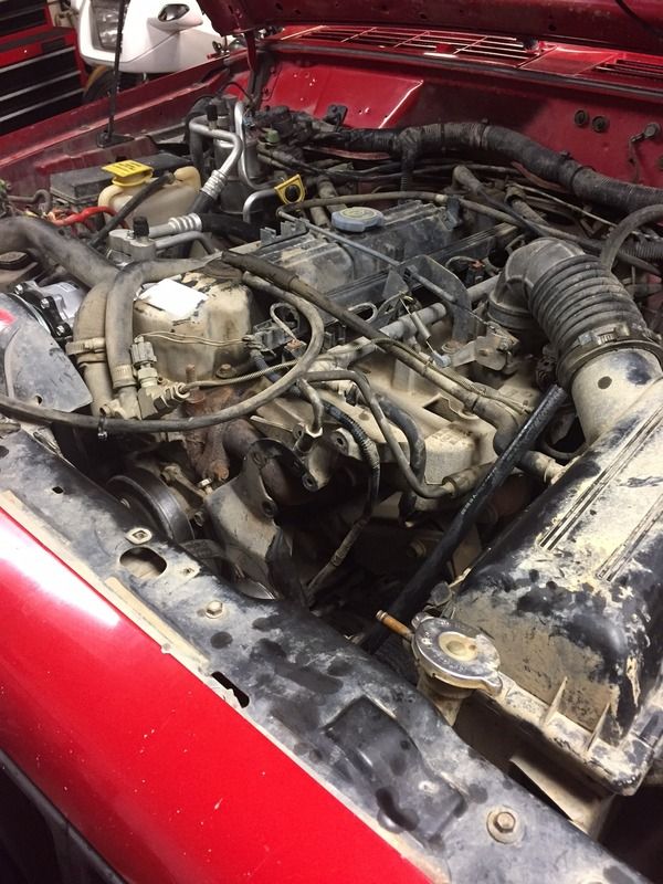

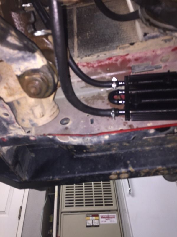

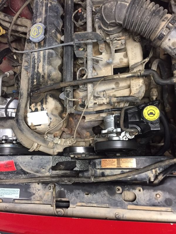

Tonight I got the old power steering pump out and am read to install a PSC pump as soon as I go rent a puller. Also installed a pump cooler behind the front bumper and a Crane diff cover up front.

Today's fun: Installed some hockey puck bumpstops and finished installing the PSC powersteering pump and cooler.

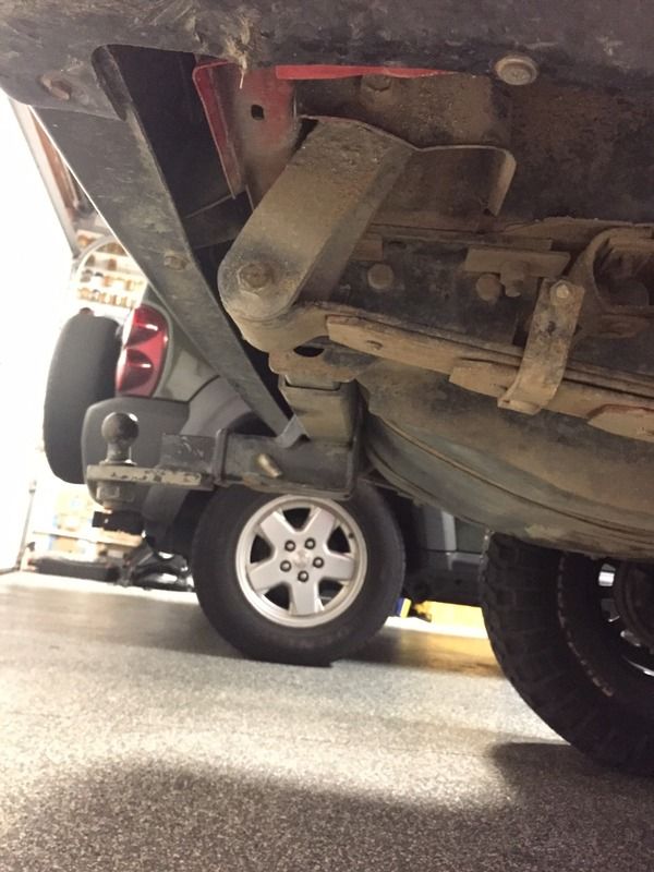

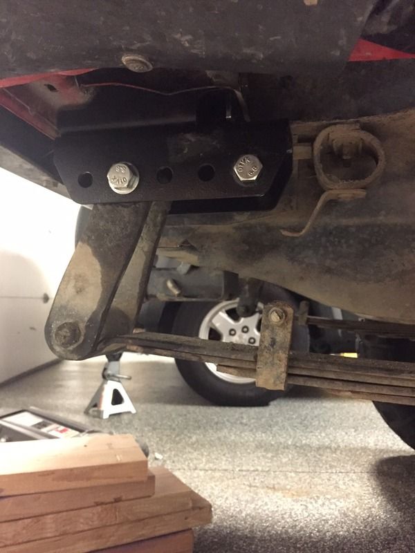

The front was about 2" higher than the rear, so I added a rough country shackle relocation kit to the rear.
Before:
After:
It seemed to give me about 1.5" of lift. But, in my usual fashion, I forgot to measure the before and after.

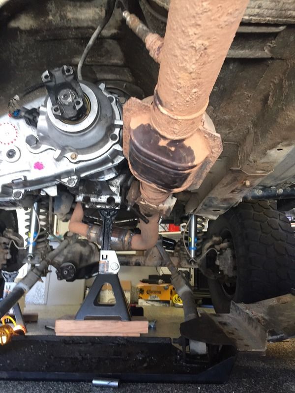

The new development is that the AX-15 is leaking pretty substantially. Its hard to tell where the leak is, as it seems to be coming from all over, only when I drive it. I think it is probably the main rear output seal.
See less See more
4

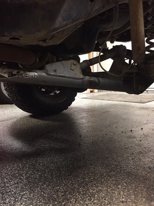

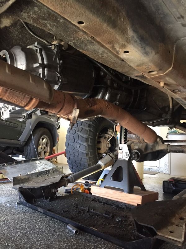

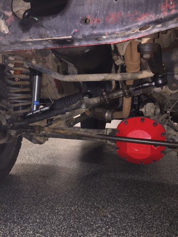

Last weekend I spent roughly 10 hours replacing the seals on the AX-15. It was a PITA to drop the skid since the long arms were attached and weren't willing to separate. Anyway, Ive driven around a bit this week and thankfully, the leaking has stopped.

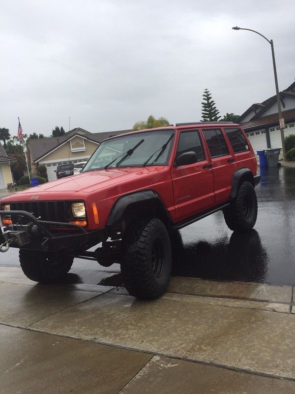

Then I took a pic of the front steering for good measure. I need to find something to replace that tie rod at the least.

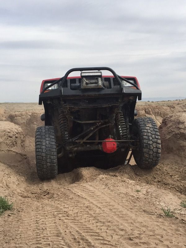

Heres some pics from TDS. We had a decent time, but my power steering line burst about 2 hours into offroading, so I had to baby it a bit the rest of the trip.
