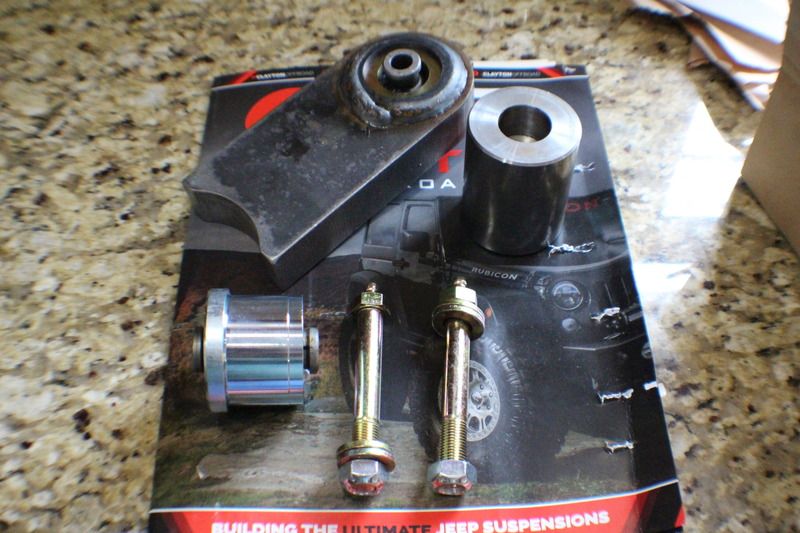

Brown Santa (UPS Man) showed up today @ work. Dropped off a few boxes & I had to load up & take right home.
Rear Springs:
Front Springs:
Shocks:
Front Radius Arms:
Cross Member:
Track Bar:
2 More boxes of stuff....... I'll dig into those boxes & lay everything out to better show it off. I'm absolutely amazed as to how well everything is packaged. By far the best I've ever seen.
Clayton is definitely a very well built kit, total BEEF. Welds are perfect & the material used is HD. Can't wait to start getting this Build moving.
Next step is to totally unbox everything, clean & put a few coats of clear coat on everything. I have to do everything I can to fight the salts that the DOT puts down here in Western New York (WNY).

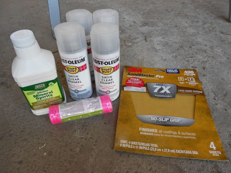

8/6/16 - Painting Clayton Lift
Got some products to paint the Clayton Kit.
- 4 cans Clear Satin
- 1 Container of Mineral Spirits
- 400 Grit Sand Paper
Got a clear coat on the Track Bar (no picts.)

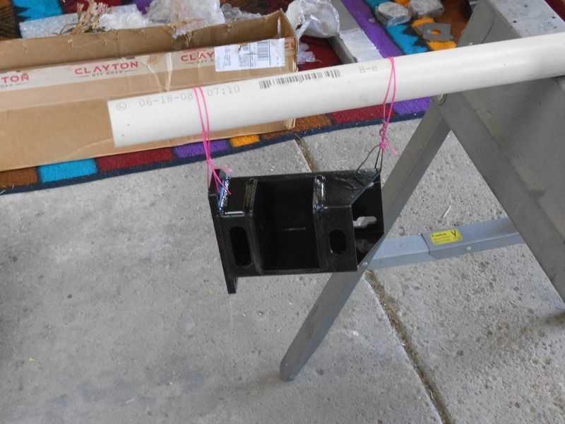

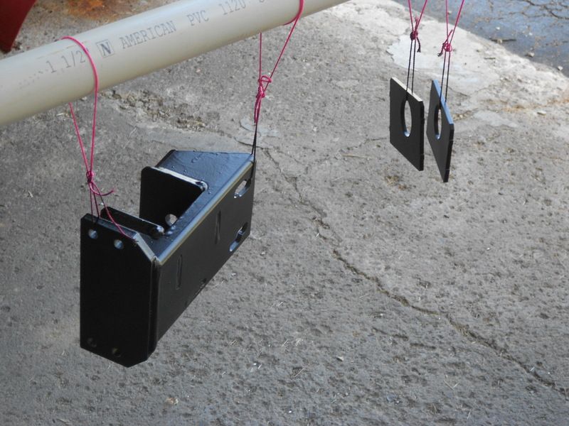

Cross Member (center section) & Rear Axle Mount:
Cross Member (end sections & end plates):
All the parts of the cross member & end caps were raw steel. I put 2 coats of black & 3-4 coats of clear. I'll have to sand certain parts of everything I've painted so i can weld them on.
Tomorrow, I'll sand, clean & clear coat the Radius arms & rear long arms.

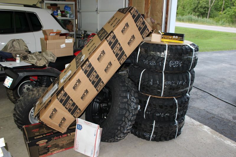

Came home from work today to find my tires were delivered. Tossed them right into the garage.
Gonna need my lift installed.
They look bigger than 33's.... Had to measure them to be sure.
285/70-17

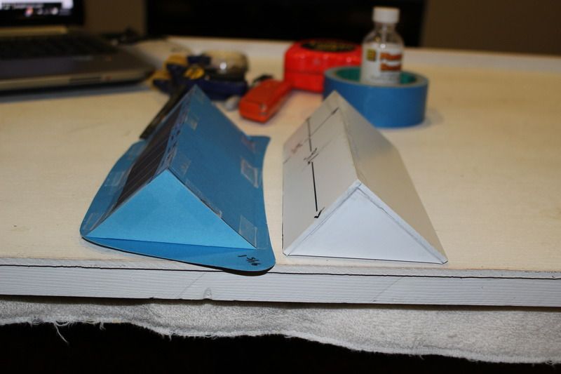

Not too much progress today, touched up the rear long arms with a coat of clear & boxed everything up. Loaded the WJ with all the lift parts in hopes that I'll be able to hook up with my friend & get the lift installed next weekend.

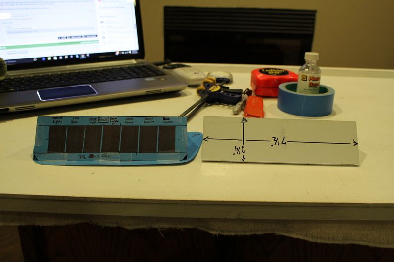

Figured I'd mock up a switch plate that i'll make for all my aux. lights & ARB/Locker switches. Used some old file folders (card stock) to mock everything up & make some test fits.
Going to mount it in the change holder infront of the shifters
Test Fit:
Templates assembled:
Front:
Side:
Back:
Side:
Rockers I'll be using:
Bottom Plate for mounting purposes:
Next step will be to cut the tape out, trace the templates to my Styreen, cut it out, and glue them all together. Body fill the cracks, sand, prime, body fill, sand, prime, repeat as needed. Then paint it up & add switches.
Here's what I'll use to make the switches..... Made many RC bodies & modifications to Hard Body RC Trucks with this in the past.

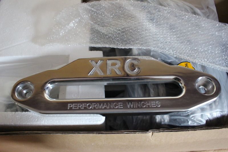

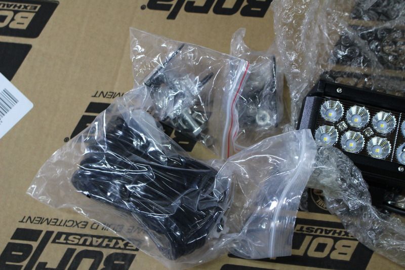

8/16/16 Deliveries
Came home today to a package from Mr. FedEx. He dropped off these goodies....
Unboxed:

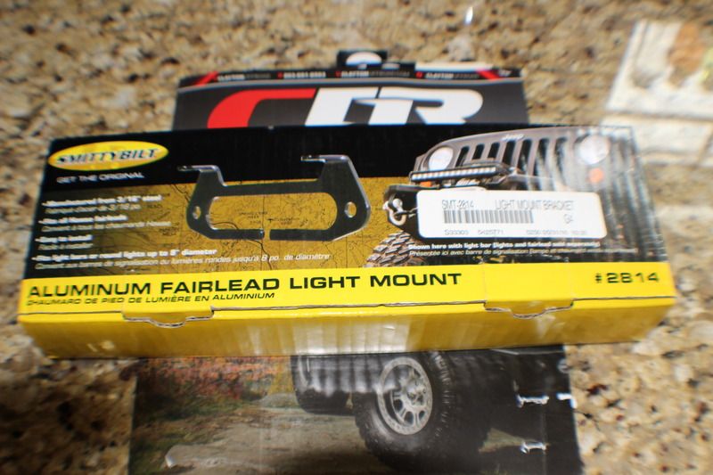

LED Light bracket:
This is what I was trying to find on the net...... didn't have any luck, and now I see it printed on the front of the box....... WTF, you'd think it would be on their website....
And as I'm typing this up...... Brown Santa rings the bell..... I thought he came through the fireplace all this time..... and when I say "he", this is what I imagine....
And for a closer look...
Hold on..... I feel like Homer Simpson when I see a perdy girl...
Ok back to this Build.. This is what he (or she) dropped off.
Ta-Da-
Should hold up in our Buffalo Weather:
Nice Alum. Hawse Fairleed:
Expecting a bunch more goodies to show up in the next couple days. Sill looking like the install is going to happen this weekend........
See less See more

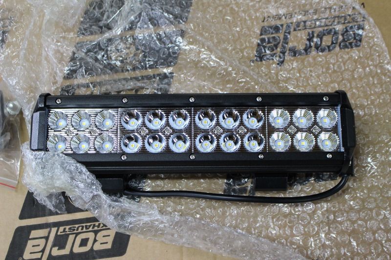

8/17/16 Deliveries.....
Well the US Postal Service dropped off a package.... Again in my head...
Free Hat..
And UPS Dropped of another box..
Amazon 12" LED Light Bar & wiring harness. This'll be mounted over the Haws Fairlead with the Smittyblt bracket. I know these LED's aren't the best units out there, but to having a cheap one on the bumper I won't get too pissed if it gets smashed or broken...
Parts are starting to build up.
With everything in the garage, I have to keep my Grand outside....I hate not being able to put my WK2 in the garage.

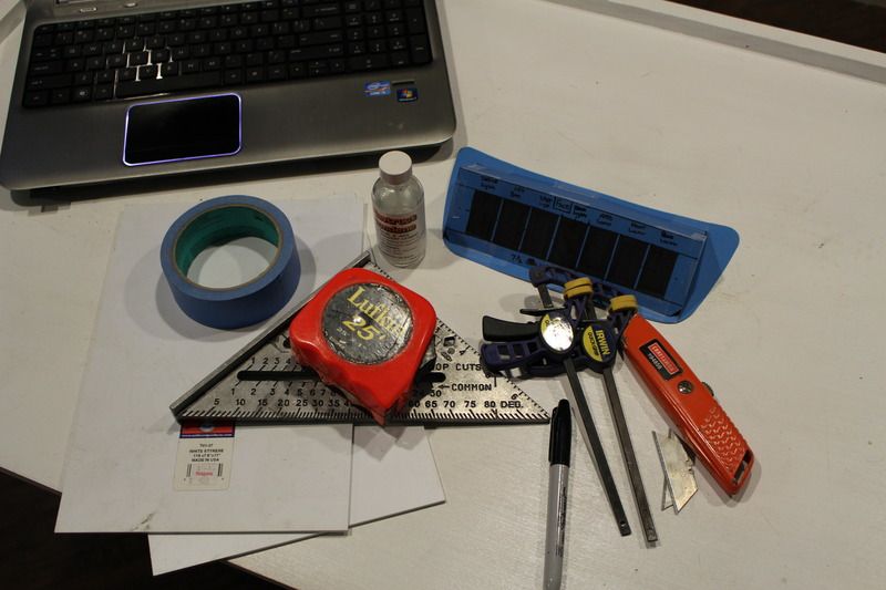

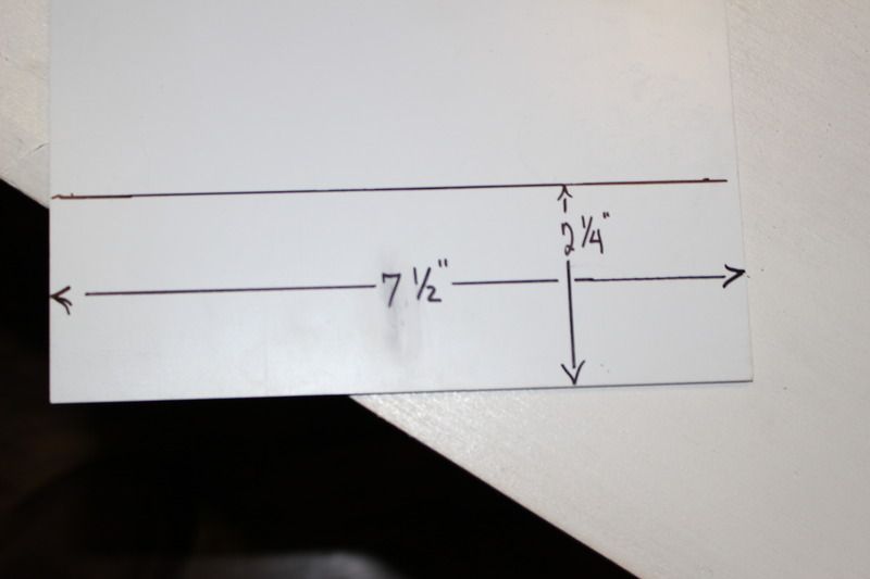

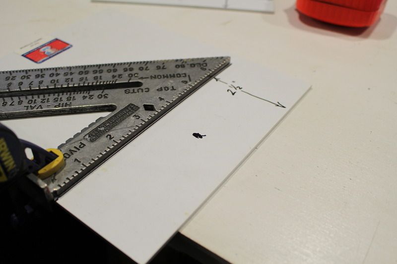

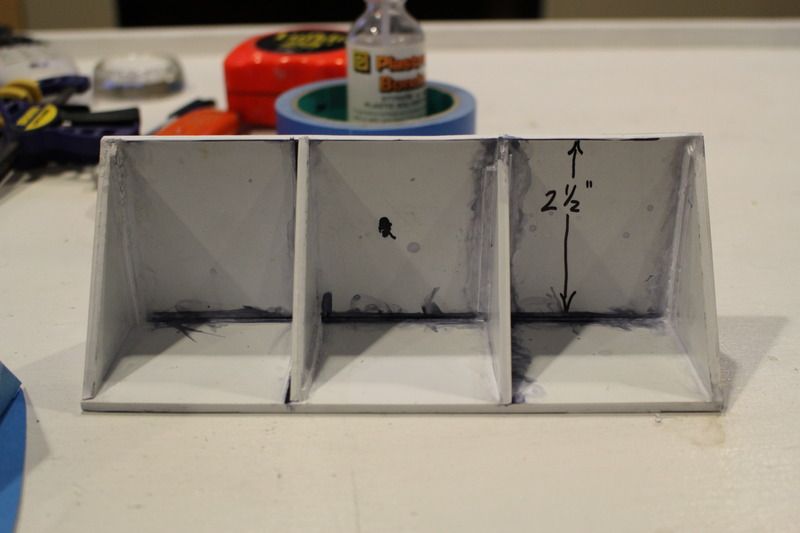

Last night, since I couldn't do much with the WJ (still waiting on more parts) I figured I'd work on the switch console.
tools I'll be working with

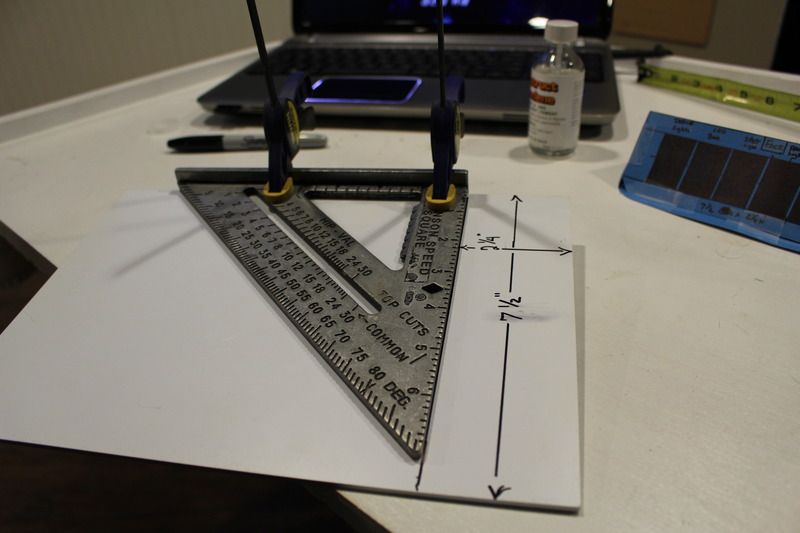

I'll go through the basics......
Measure twice & start cutting with a razor knife. The sharper the better & don't slice off a finger.
Use a speed-square and hold it in place for the first pass with the knife.
Repeat as needed
Use the Plastruct Bondene. Use a lot, it meltes / fuses the two pieces of plastic (Styrene) together. Cut small pieces to use as reinforcement on the braces.

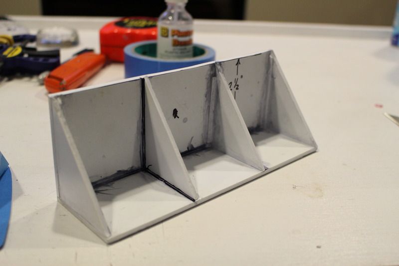

End up with this....
Inside, the material is .118" (1/8") thick, but I wanted to reinforce it enough so I wouldn't have to worry at all when hitting switches on -of.
Next step will be to make the platform that it'll mount to, the bottom plate that'll get mounted, cut the switch openings. Bondo, sand, prime, repeat. I'll probably paint it black so it blends in with the rest of the interior.
Still need all the switches, another fuse/relay box out of a WJ, do a clean install. I like to make the install as clean as possible when installing Lights, accessories.
That's all for now folks.........
