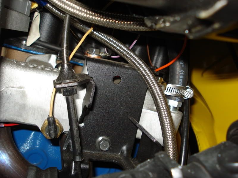

Been lurking here for about a month while I work on my 78' CJ5. Not nearly as nice as yours. Question, how did you manaage the linkage for the TB? Did you use the stock bracket on the engine and the stock cable or use something else? Reason I ask is I've got the same TB and am having a problem figuring out the linkage and cable. Thanks for the inspiring work and great pictures.

I ran the stock linkage assy. I don't have any pics of the setup (can ya believe it) but it's the std mount on the intake.
If I can get the kid to come home at a decent hour, I'll try and snap a few shots.
That would be awsome, I've been struggling with this one for about a month.

Here ya go. Hope they help:
See less See more
Thank You very much, that does help. The linkage I've got orginaly came from a jeep with the single barrel carb. Needless to say it looks nothing like you pics. I now have something to take to the parts place to help describe what I need to make this work. Thanks again.
