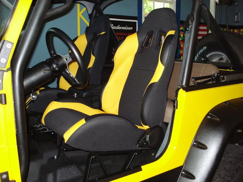

Got the new windshield in since I last posted ... $110 installed!
Put in some new seats. Not sure I like em. May just keep my stock'rs and have em re-covered.

Looks great, the new seats are a lot better than the tan IMO, looks comfortable. Maybe I missed it but whos are they?
I need to come test-sit those new seats and see if I fit. By the looks of Aryn in them, I'm thinking I probably won't fit.
Got em here:
http://cgi.ebay.com/ebaymotors/ws/eBayISAPI.dll?ViewItem&item=190225207681
Eddie, Your head would be above the cage. They sit a couple of inches higher and the leg section is longer than the stock seats. I think they would be fine for a honda or that type of vehicle where your legs are straight out. Jeep seats position you like you're in a chair (legs down) The seats are nice, guess I just need to get used to them.

I know the ad for the new seats says leather, are they? they almost look like neoprene?
a coworker has the same style in his CJ5, and they really dig into my shoulders/sides- perhaps yours are a bit different?
Hoss
Fatman
Hoss
LOL, they have a few edges with leather.
They are tight but not to the point of being obnoxious.
Contrary to the S/N, I'm 5'9" 180# so I fit the seat ok.
The kid is 5'7" 125# wet, he has more of a problem with the seat than I do.
I think the best resolve at this point is to tack in seat mounts to the cage, lowering them about 2-3", add the 4 point harness mounts. Pull the cage and weld it all up. I thought this could wait another 5 months, maybe not.

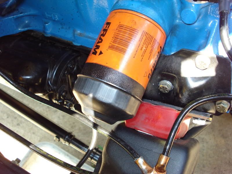

Lil trick I've used while working on Harley's:
end filter wrench
keep the oil from a PIA (no clean up needed)
took more time to take the pictures and up load em
not telling, do your own thing!
Seal it up, I prefer sealant over teflon tape

I like the plastic bottle trick. Clever!
