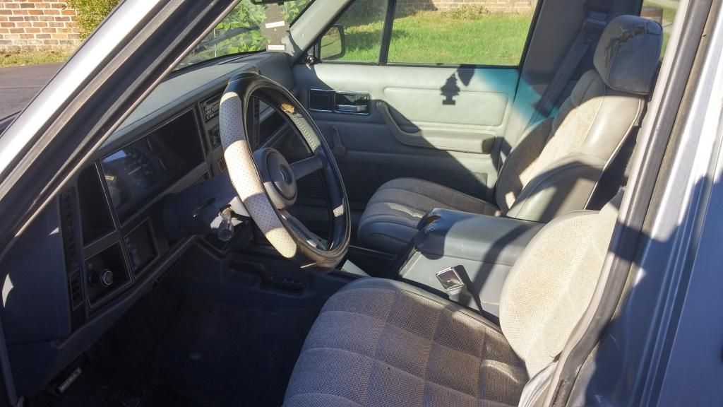

It's in pretty damn good shape. Got the interior and dash bulbs swapped as well as the headlights. Power washed it and spent a couple hours undoing a lot of previous owners afro-engineering.
The interior is in better shape than I expected. It would be perfect if a previous owners dog hadn't chewed all kinds of ****. Swapped my console lid out for that reason.
