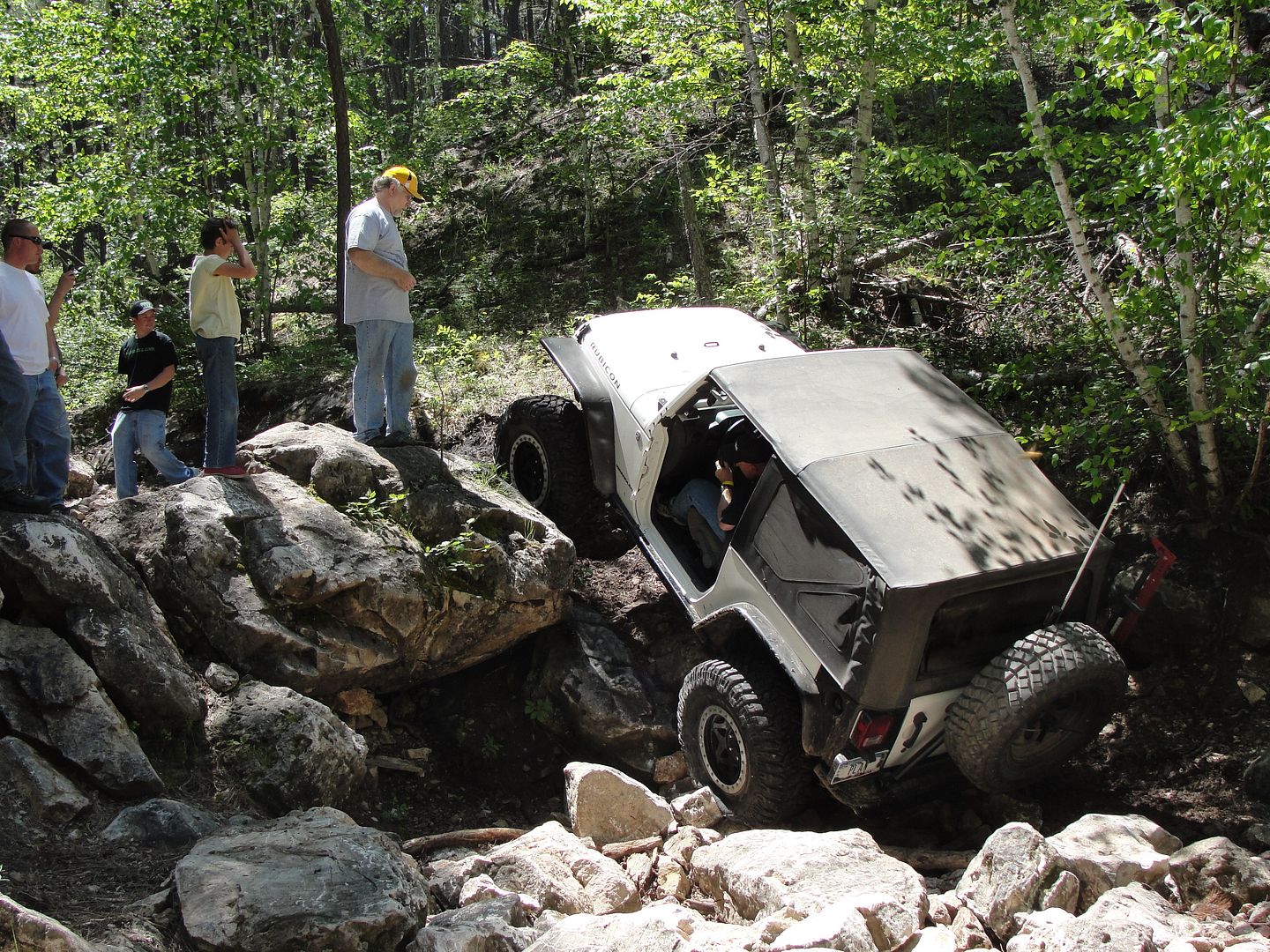

So, the first thing I did was increase the length of my front bumpstops from 0.75" to 2" using JKS adjustable bumpstops. I could have reinstalled my TF front extended bumpstops from my 2.5" BB, but it was much faster to use the JKS ones. 2" extended front bumpstops on a 3" lift leaves about 3" of up travel before the stop would be fully compressed:

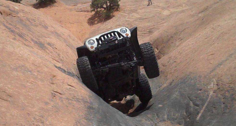

We occasionally do mud, but I hate having to spend hours and loads of quarters to clean it off. So we mostly do technical rock crawling, some forest service and BLM roads, and snow wheeling.
If it were a mud rig, I wouldn't want the LCOG approach nor would I run 40s on D44s--even with the reinforcements/upgrades to the axles.

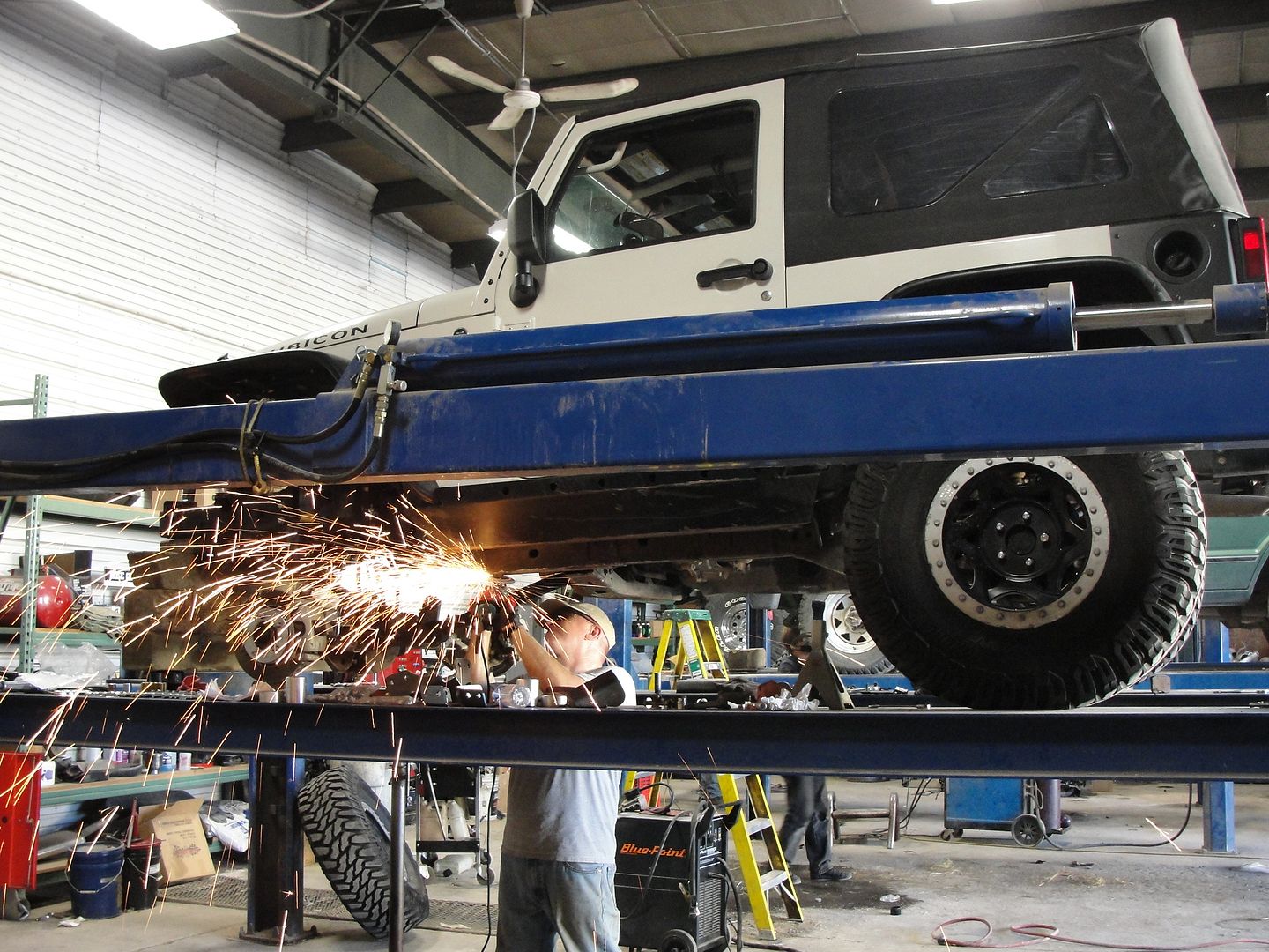

Trailmaster has asked me to be a private product tester for them. They sent me their new 4.5" Stealth Long Arm with rear 3 link to install, test, and critique. I opted to run the kit with Fox shocks.
I'll do a thorough write-up, and later this month, I'll rigorously test it out in Moab.
After the test, I'll do some tweaking to customize the Trailmaster setup.
I am making notes as I go. I started yesterday and am mostly done with the front.
Here is some of the progress:
Grinding of residual control arm bracket material:

What is left after quick work with the plasma cutter:

This would take much longer at home, but the guy who owns the shop that does my regearing for me let me use one of his lifts for the install.
