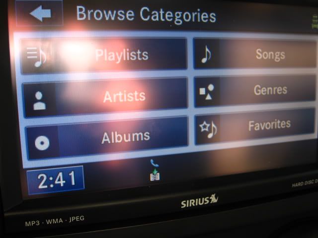

Data File Transfer/Storage:
• 2007 RER models: 20 GB HDD for Nav, Photo, Music (7 GB available for storage)
• 2008-up RER models: 30 GB HDD for Nav, Photo, Music (17 GB available for storage)
The unit for sale in this ad, is a 2008 model.
• USB 2.0 port interface
• JPEG photo viewer
• Customizable screen background using your own photos
• Music file transfer
• CD/DVD to HDD
Integrated Music Juke Box:
• Supports Gracenote Music file management system
• Ability to Rip and store music to HDD via CD or USB

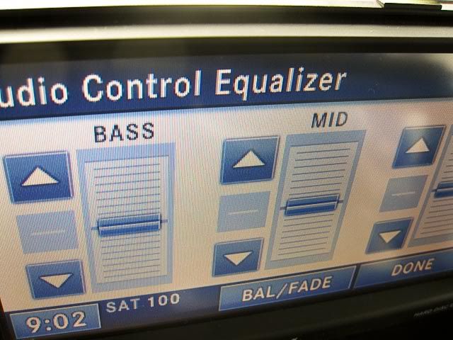

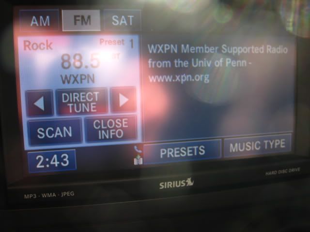

Integrated Radio Receivers:
• 12 AM/12 FM station presets
• 12 satellite radio presets (when equipped)
• Bass, treble, balance, fade control and mid-range
• Bi-directional radio seek
• CD changer controls
• Dual base band satellite radio receiver (Sirius)
• Dual FM tuner
• Electronically tuned
• Optimized AM tuner
• World tuner support

PHOTOS:
These are my personal images
