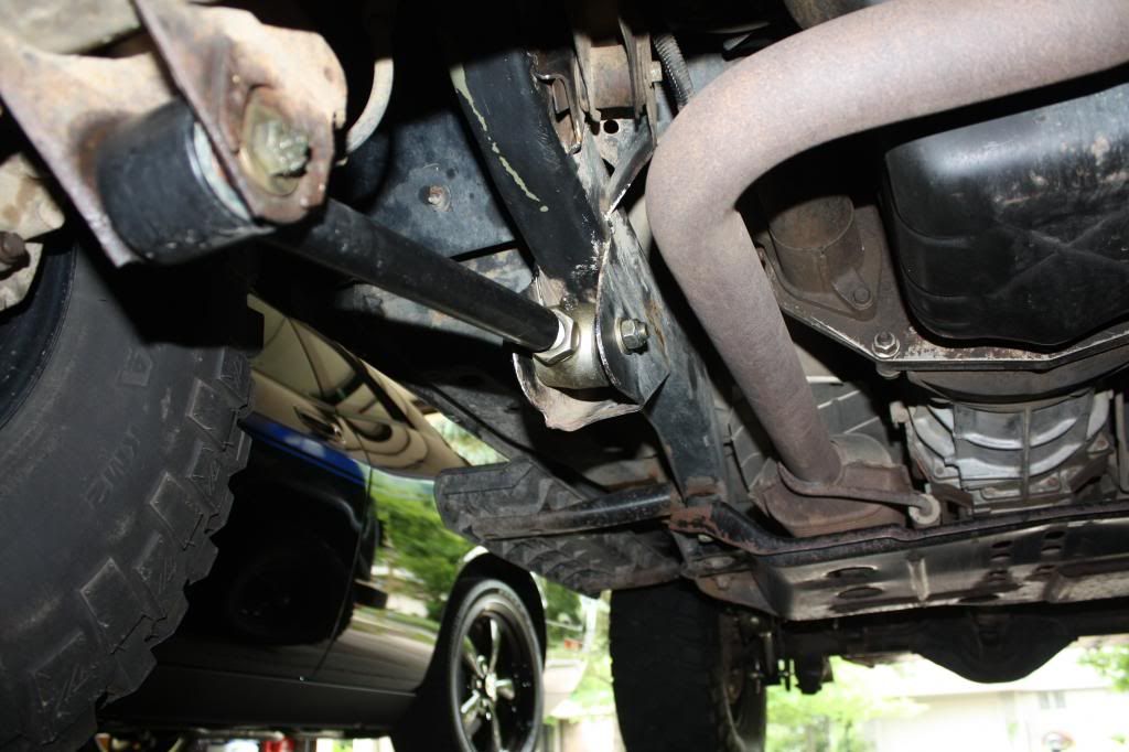

Small update today. I got her running easily enough. Since then I've installed my front Currie antirock, rear Currie JJ LCA's, new front brakes, oil change, diff fluid change, and rotated the tires :D I've also attempted three or four times at getting my front axle u-joints done, but those three unit bearing bolts are a *****! :rantscream:

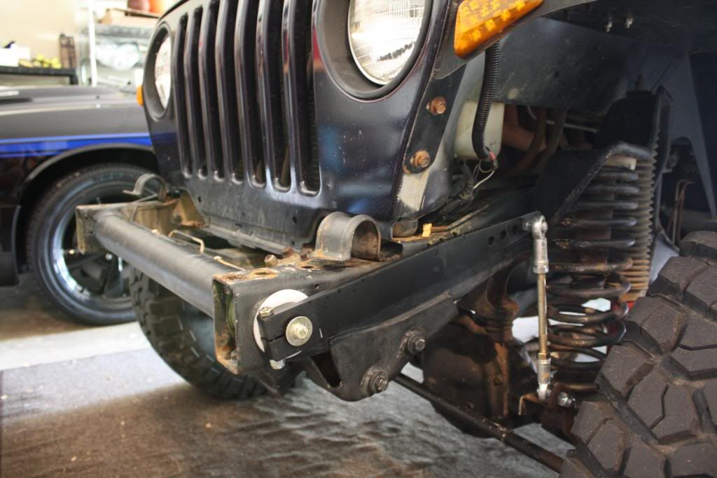

Antirock and front and rear LCA's are done. Yes, I know the jam nut isn't jammed :)
When removing the factory sway bar, I couldn't get a wrench around the bolt that's almost under the grill which is holding the sway bar 'clamp' down. You can see in the AR pic how it's still attached. To get the sway bar out, I had to bend the clamp a bit, then hack saw the rubber bushing enough to where I could yank the whole thing out of the clamp. Now the bumper and winch are back on and nobody can see that ugly business :laugh:
