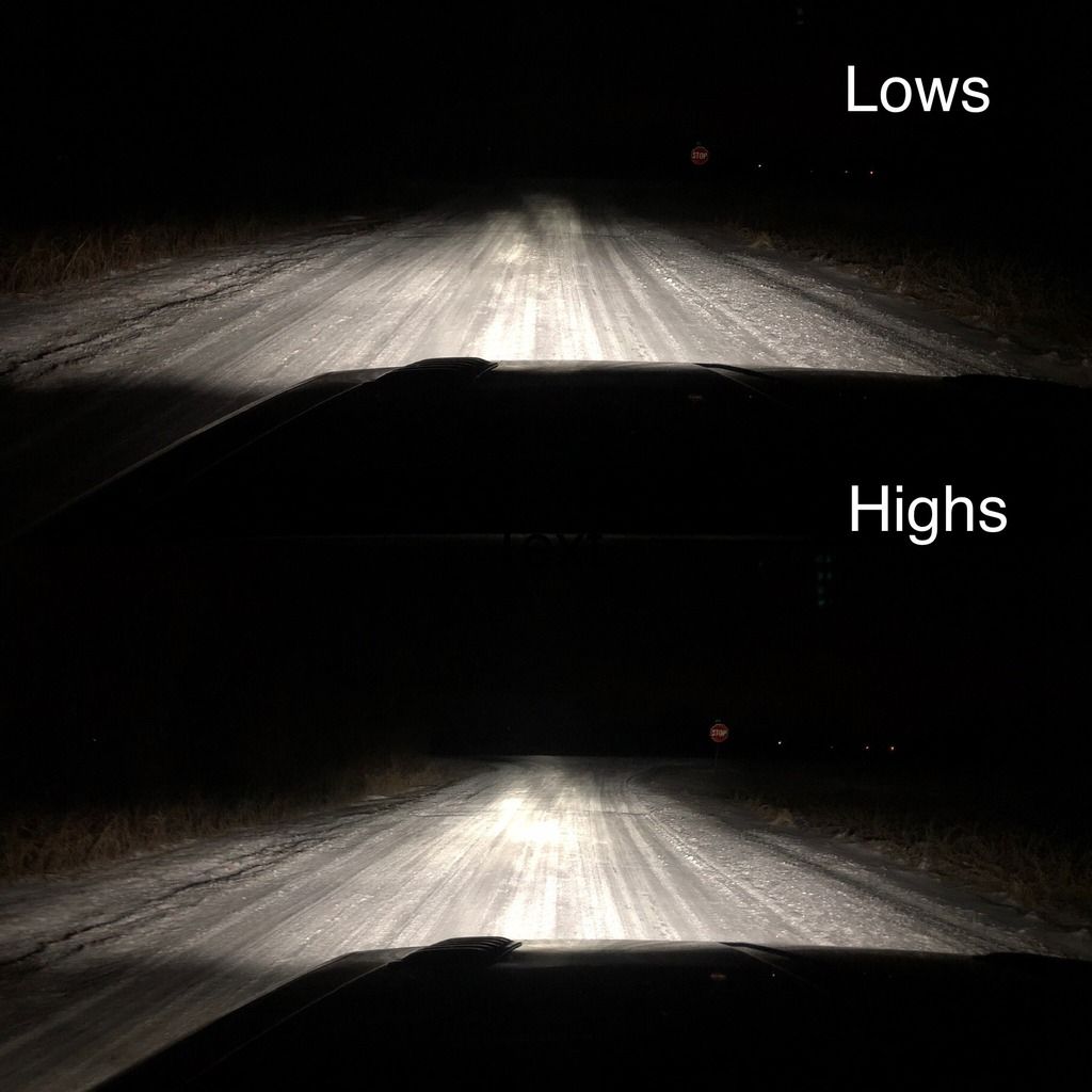

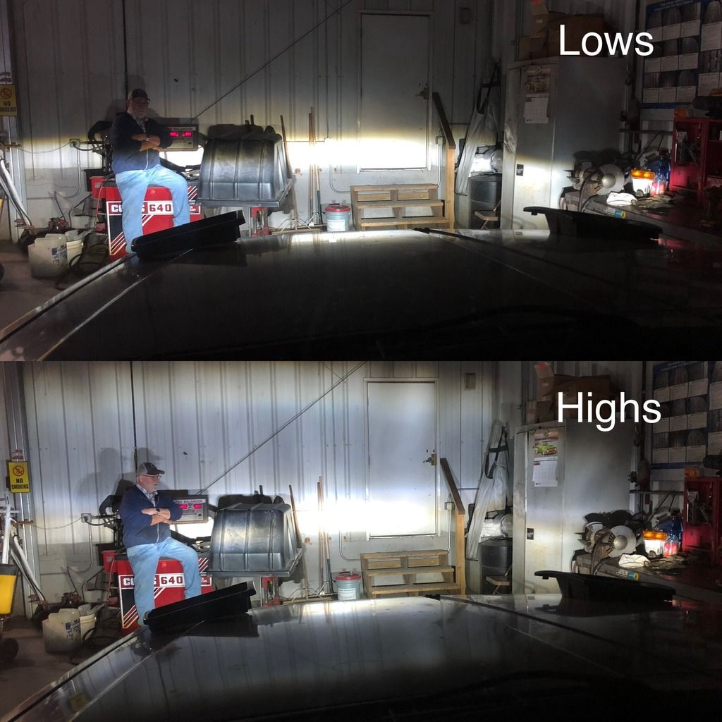

I have owned all of the mentioned above. Autopal H4, with IPFs, LEDs and HIDs, with upgraded harnesses. TruckLite LED, JW Speaker and now the Amazon cheapie specials. I have LOVED the TruckLites the best over the years, but decided to try the Amazon ones due to another members recommendation, and I am impressed.
The headlights.
My tire salesman was highly impressed.
Low beam:
High beam:
All finished up.

Here are a couple comparisons. I will get the outdoor ones with the new Jeep as soon as its one all 4 again.
Truck Lite
Amazon Specials
