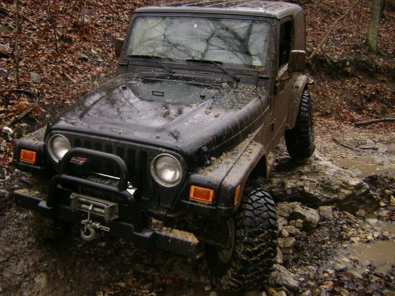

So on that note ill leave you with some pictures from one of the top off road parks in the midwest that i took my budget lifted jeep to (both YJs also have RC lifts):
SMORR (Southern Missouri Off Road Ranch) Some buddies and i rode trails in the rain for most of the day. We had a blast and luckily no one broke anything on this trip. This was my first major trail ride since the 4in RC lift and 33x12.50x15 Micky Thompson MTZs. Both of which i am very pleased with. The lift had decent flex and the MTZs took everything i threw at them from the quiet highway ride there to the rocks, mud bog and even up a muddy/rocky hill that my buddies with locked rear axles couldnt get up.

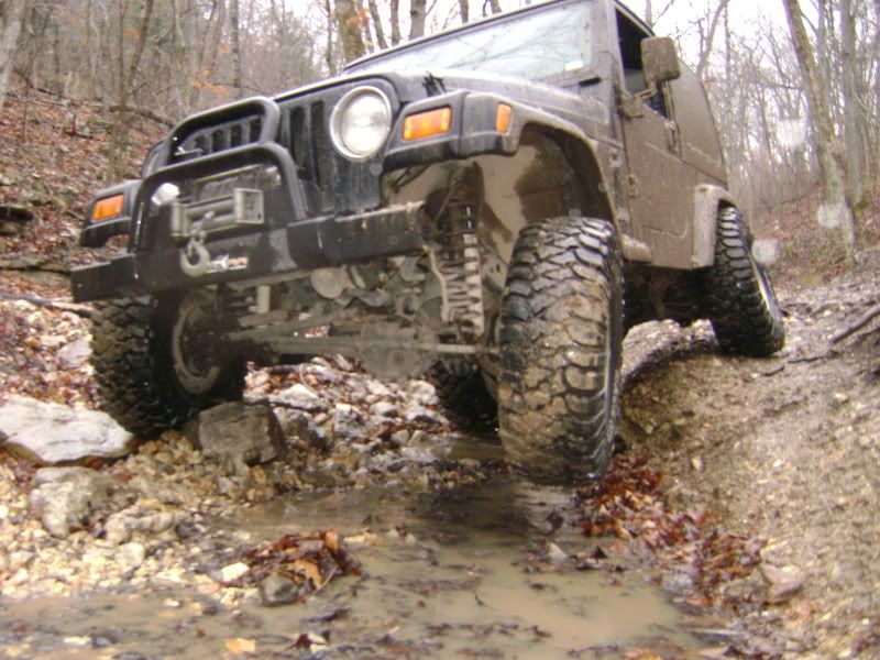

Flexing and picking up a tire:
This rock pushed my MTZs to the rim and i felt like i was on the verge of tipping over while i was going over it:
Mud pit and a lot of fog:
After a few trips thought the mud pit:

Also, in one picture with your wheel off the ground, you can get more flex if you disconnect your sway bar links. I made some DIY disconnects following a thread on here somewhere.
I need to get longer brake lines before i disconnect the sway bar links so i dont damage my brake lines.
