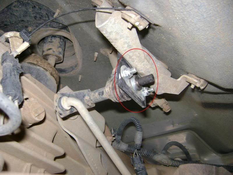

Other then getting stuck in some really loose gravel i was really happy with my new setup. The only issue I had was 4-LOW would pop out and go into neutral on occasion. It feels like its not engaging all the way. Im guessing either the trans drop moved it enough that the lever is coming into contact with the body or the 4wd relocation bracket needs some adjustments. Anyone else run into this issue after installing an RC lift?
^Anyone have any input?
I have the same lift and I had to adjust the TC shifter linkage when I installed mine. I'm pretty sure the lift actually came with instructions to do so. I've had mine for about 2 years though. Things may have changed.
It came with and i installed a relocation bracket that dropped the linkage down about an inch or so to stay even with the trans drop. I had to drill a new bolt hole in the bracket because the original location made the linkage hit the head of one of the bolts when selecting 4hi.
It will shift into 4lo but if im bouncing around on the rocks it will sometimes kick in between 4hi & 4lo with a loud pop sound like it isnt getting all the way into 4lo and its popping out because of it. At least i had no issues with 4lo popping out before i lifted it so im fairly certain it has something to do with it.
The directions said something about having to possibly cut/hammer the shifter hole on 5speed TJs but i have not needed to do so as it shifts without hitting the body. Could the 4wd selector be hitting the body?

I did notice that after the lift the 4wd selector sat up a bit higher like it had been slightly pulled up but after pushing it down to find it would not go any lower i assumed that it was like that because the trans drop changed the angles of the linkage. Is that normal for the 4wd selector to be like that after installing the RC lift?

Hmmm.....When I installed the lift the kit didn't come with any brackets to move the linkage. I just added the TC drop (mine is a little over 1") and then adjusted the linkage per the instructions. My shifter actually seems to sit a little lower now which makes sense since I dropped the TC down. Honestly maybe try taking the linkage drop bracket off and re-adjust everything. Mine works fine without it.
Edit: I also have the 3 speed auto and mine is a '99 not sure if that would make a difference or not.

Here are a few pics so you can see what im talking about.
This is a picture of the supplied bracket attached to the original pivot point for the 4wd selector:
Here is the bolt i moved (arrow) because the original bolt hole location (circle) made the linkage hit the head of the bolt when going into 4hi (path of linkage in green):
