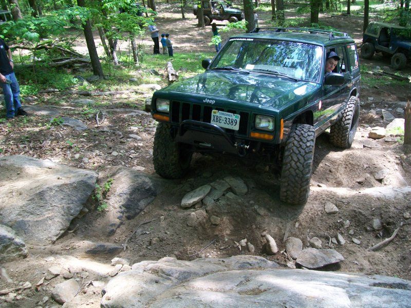

for all the haters.....low and 35's flat worx!!!:cheers::cheers:
See less See more
I'm totally happy with this setup. Works awesome, no rubbing. I do, however, need to put another washer behind the steering stops. I got a little lca lovin' from the tires. Also, I NEED TO GET SOME SHOCKS IN THE BACK!!!!! Crozet also did some bodywork. I'll get more pics of that later, but I need to do some rocker replacement.
At least your out wheelin :thumbsup:. Looks good
Yup! I got to get used to this Jeep. Been a while since I have wheeled an XJ!
