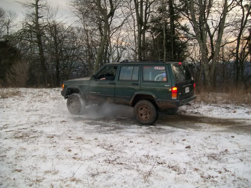

Current pic: 10/5/14
Well folks, I said I was going back to an XJ so that's what I did. Just a recap on my previous Jeeps...
My first XJ the day I sold it. 95' Sport 5 speed...
My second.... 87' Waggy XJ w/ factory 44 and HP non disco 30. Wish I kept this one...
And of course, my TJ I just recently sold....
Well after my TJ, I started looking for my next XJ. I knew I wanted a 97'+, so that's what I went after. While searching craigslist, I came across a 99' with 130k miles. Girl that owned it said it needed a radiator. All it really needed was a cap. Talked her down to $1600 and brought it home. Had some awesome seat covers and looked and smelled like an ash tray inside...
