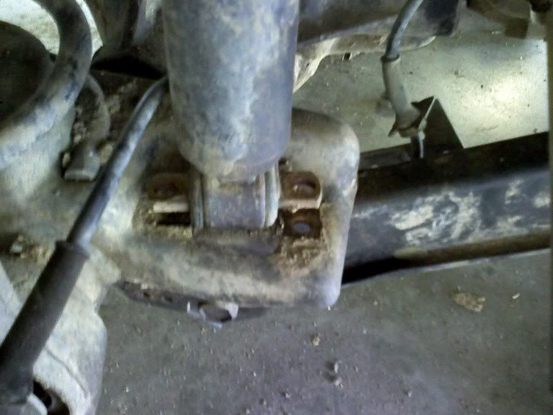

6. You need to unscrew the lower shock mount bolts, and the upper shock mount bolt to remove the shocks.
Removing the Lower shock mount bolts
When they are removed

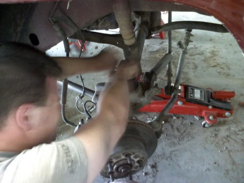

*TIP* if you are having trouble lining up the holes and the axle needs to be pushed away from the car then you can use your jeep jack to put in between the LCA mount and the axle tube itself for leverage.
Something like this, sorry about the darkness but if you look hard you can see what we did.

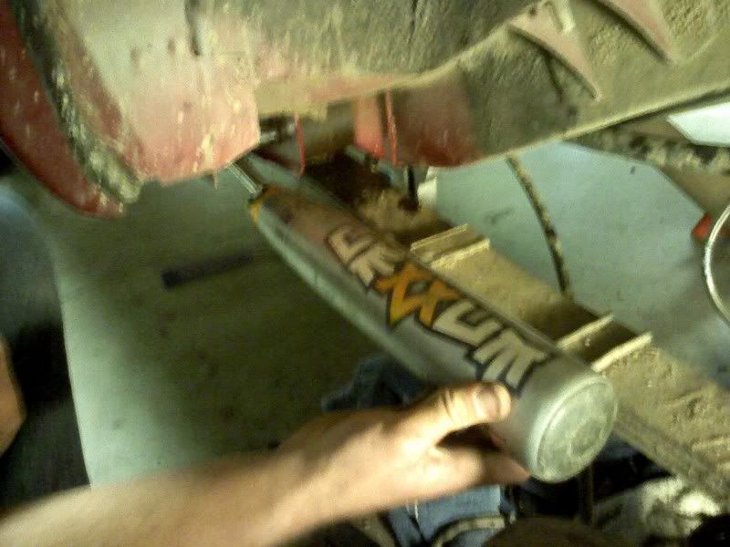

6. Remove the shocks, there is two upper screws holding the top up and one at the lower shock mount.
*Note* Be careful with rear lower shock mount because they are known for breaking.

13. Install the rear shocks, not very difficult just put them on the same way you took them off:thumbsup:
