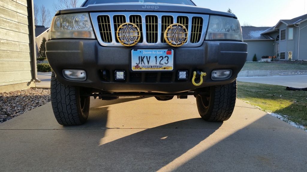

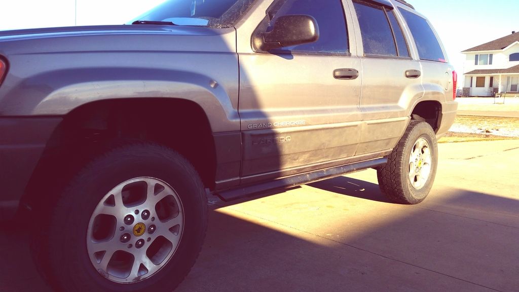

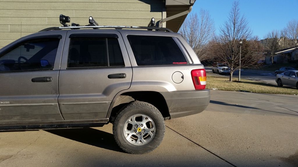

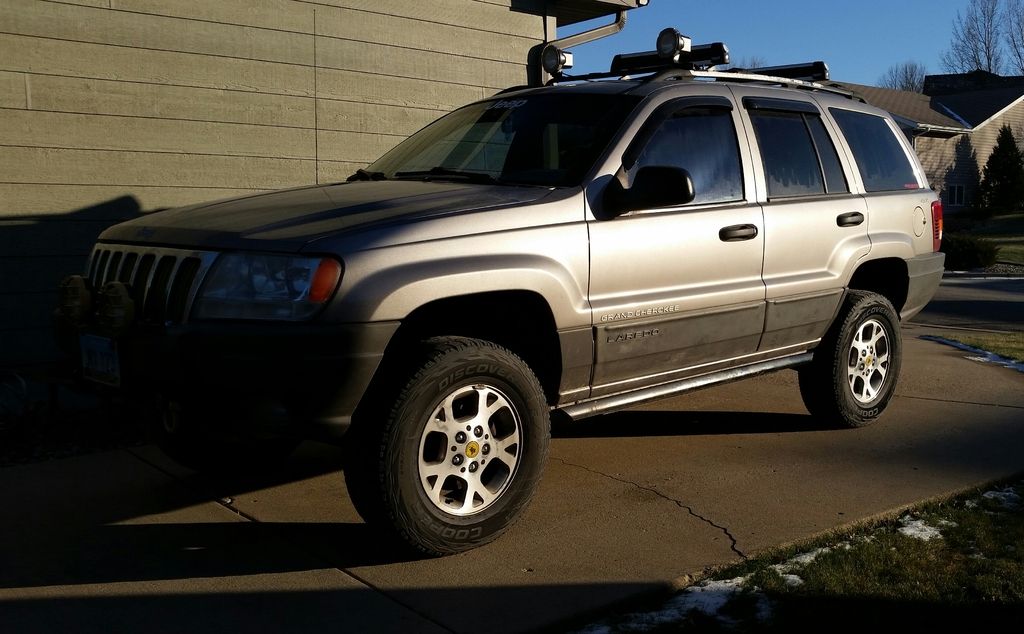

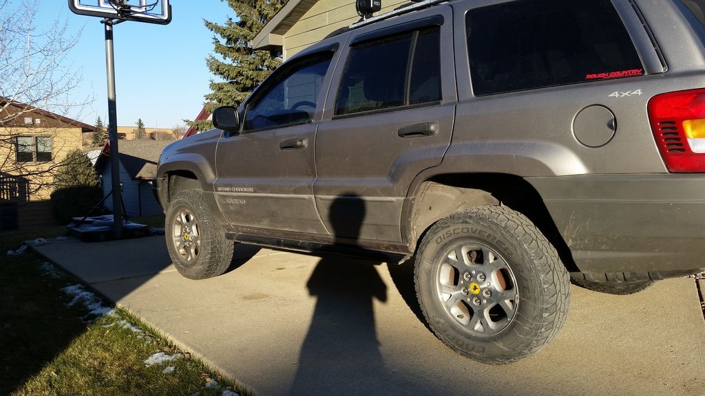

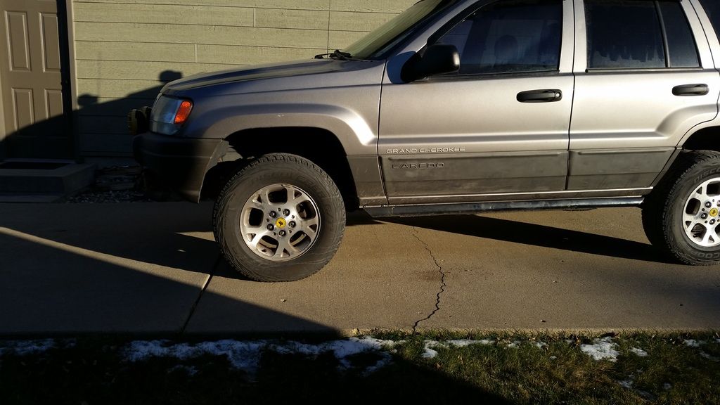

Finished up the Iron Rock Offroad 2" lift install the other day
Compared to my previous setup with 3/4" spacer front and 10mm spacer in the rear (these were left in, so I netted almost 3" of lift up front and about 2.5 in the rear).
To complete the lift I installed Rough Country N2.0 shocks up front, IRO extended sway bar links all around, and IRO HD adjustable control arms all around.
Pics of new setup:
