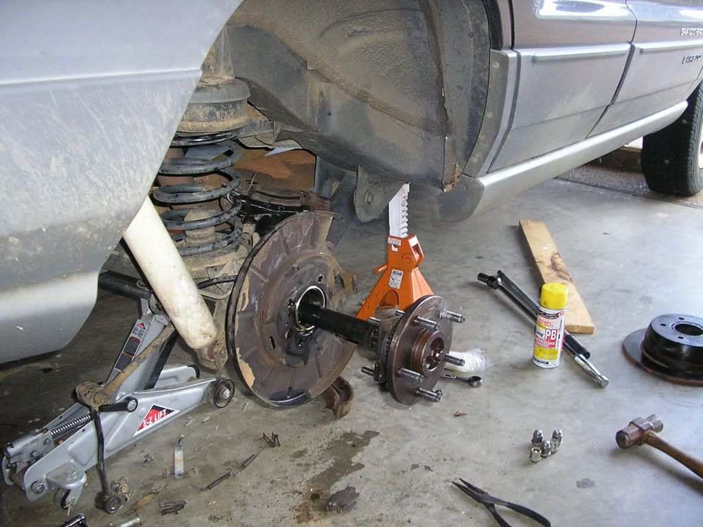

The side gears must now be removed. To remove these, you must pull an axle shaft out about an inch. (I pulled the passenger side). First, remove the caliper from the brake rotor (held on by 2 18mm bolts). Tie the caliper up and out of the way with zip ties - do NOT let it hang by the brake line! Next, the brake rotor must be removed. This will take a good amount of PB Blaster and some good whacks with a mallet. Also, be sure that the emergency brake is not keeping the caliper on.
With the brakes out of the way, remove the 4 15mm nuts attaching the hub assembly to the axle housing (these are on the axle side, "behind" the brake dust shield). The axle shaft will now slide out:
