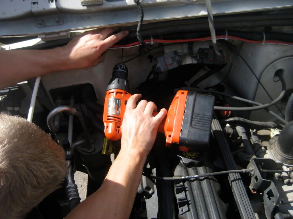

From the motor side in i drilled a pilot hole for the hole saw
It is always smart to measure 2WICE cut ONCE! no turing back now, cut a 3" hole making sure to avoid wires and the factory ground bolt

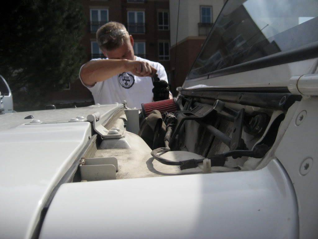

I then took the flex tubbing I bought from AutoZone and I pushed it through the whole in the firewall, it just so happened to work out to where it actually threaded through really nicely and snug. I pushed about 3" through. Then I pushed the flex tubing into the filter and used a hose clamp to seal it. I then pushed it into place and it fits perfectly.
Here are a few pics to see the clearance.
