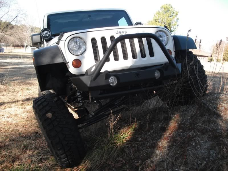

Here's a couple pictures of my setup - as noted in my signature...

rock krawler has 2 nice ones and 2 different price points. and there 2.5 lifts are a little closer to 3 ish 3.25 ish
