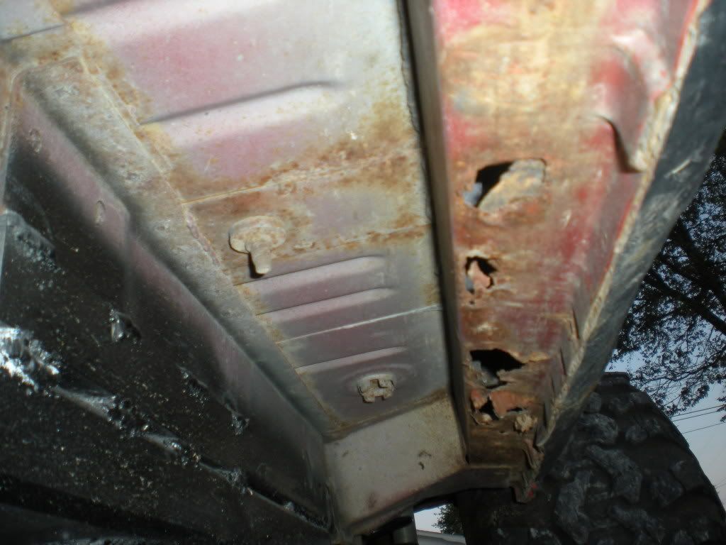

My rocker panels were rusting out
So... I decided to cut them off and make boat sides. I just have the passenger side done so far and I should have the drivers side done sometime this week
See less See more
That looks clean man. I'm kinda thinking about cutting up the rockers. How long did it take you to do one side?
That boatside looks pretty cool man! Did you happen to run any stringers from it to the frame rail to reinforce everything or just that lower plating? Be wary of the slider trying to push the existing rocker material up into the bottom of the doors haha. Mine try to do that when I hit them really hard even with decent reinforcement
Thanks, It took me 4 hours to do the one side but now I know what I am doing so I say I can do it in 3 or less
Thanks and yeah I have 4 stingers and they are welded and gusseted to a 3"x4" plate that is welded to the frame and the stiffener. Then its all tied together with the lower plate.
3

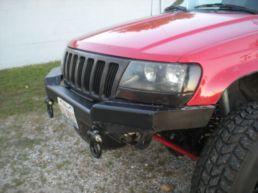

Well I was busy this past weekend. I finished welding, grinding, and painting the new front bumper. I will later add a winch plate when i buy a winch. I also got some new street tires, 37x12.50 Wrangler MT Hummer tires.
See less See more
any clearance issues with the 37s at that height?
the bumper looks awesome. radiator skid/protection soon?
The 37s clear with no problems. If I push the front axle forward another inch, Im sure I could clear 40s all the way around. The radiator protection should be built in the next couple of weeks.
what did you do with those 36's?
so your running an iro a arm with LONG lower control arms? hows the ride?
Im going to use them for when I go wheeling. They just wear too quick on the street.
Yep and it rides better than stock.
damn that looks sick. i love that you use "street tires" and "37inch hummer tires" in the same sentence haha
do you have a front driveshaft yet?
waiting on flex pictures!!
So you built a tube subframe, then based your LA mounts off of that? I would've sleeved/plated the unibody first if I was going to go that route. That's putting an awful lot of faith in not much weld bead.
What are you running for a welder?
Yeah, now looking at it, it doesnt look all that strong.. on top of it hanging down pretty low.
