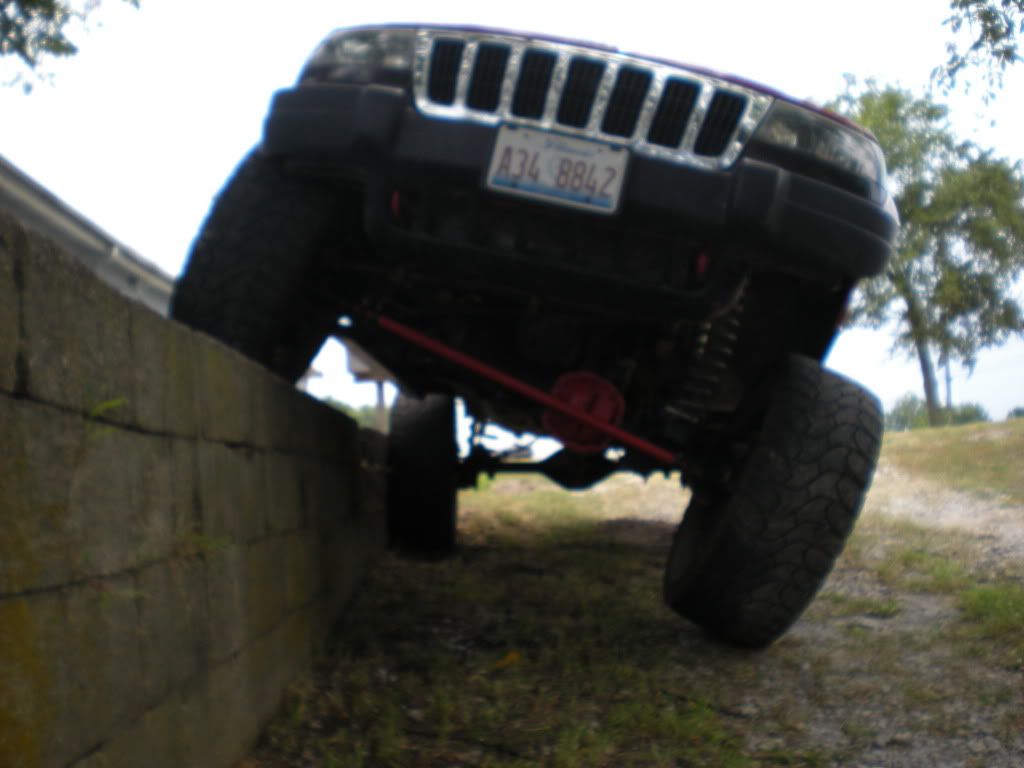

The weater cooled off a little today so I thought it would be a good time to get the rear trimmed. So now I can bottom out my shocks front and rear and not have any rubbing. There is not room in the rear for 37s with short arms. When it is flexed, the axle pushes back too far. There is just room for the 35s.
max flex w/ no trimming
front only trim
front and rear trim
More pics with front and rear trimmed. That is full flex, there is no more up or down travel

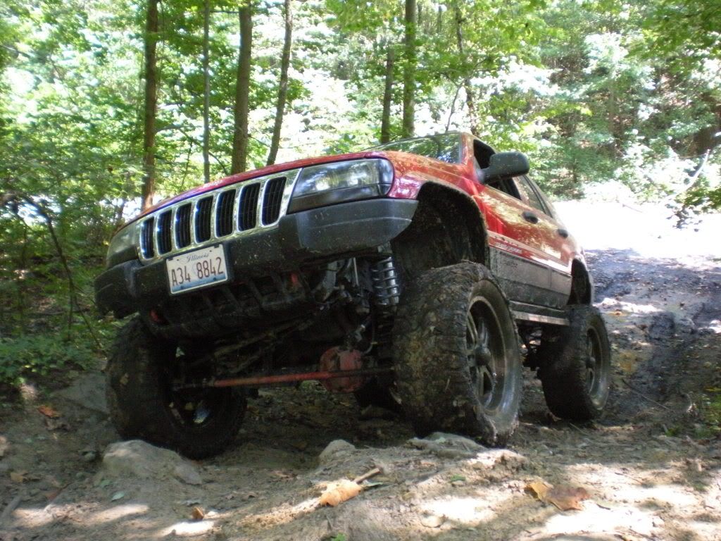

I went to Interlake again today to test out the trimmed fenders.
As I was on my way out and I decided to mess around in this washed out part of the road.
Then... woops
It was the loudest sound Ive heard a vehicle make. When it fell, my tire got sliced a little on part of the inner fender.
