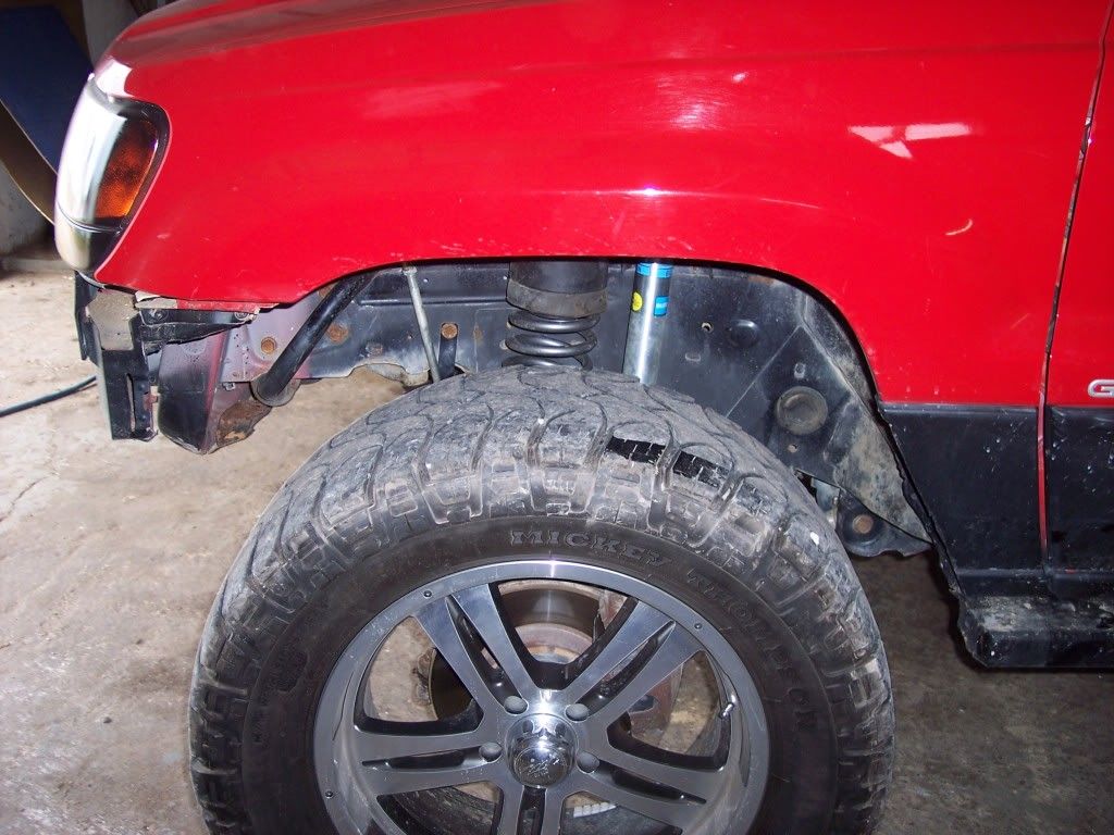

I have a few weeks off of work and school doesn't start for a week, so I thought it would be a good time to do the front fender trim.
what I started with
I added another strip of tape below this one for the cut line.
trimmed, sanded and rolled
painted
both sides finished
See less See more
