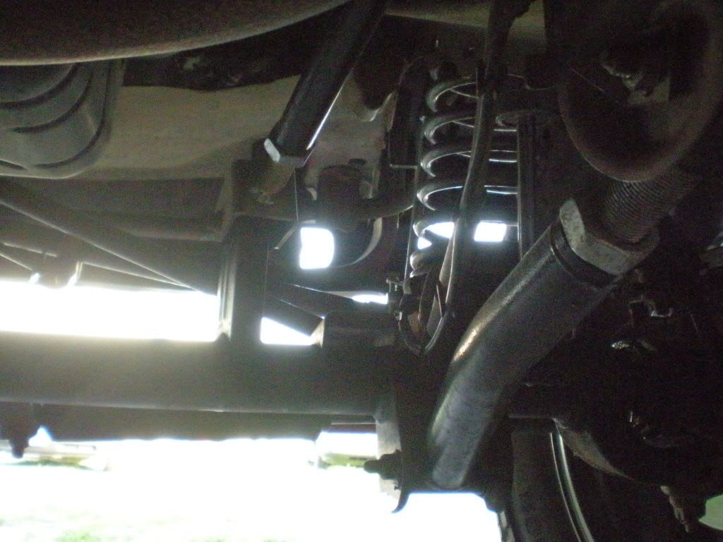

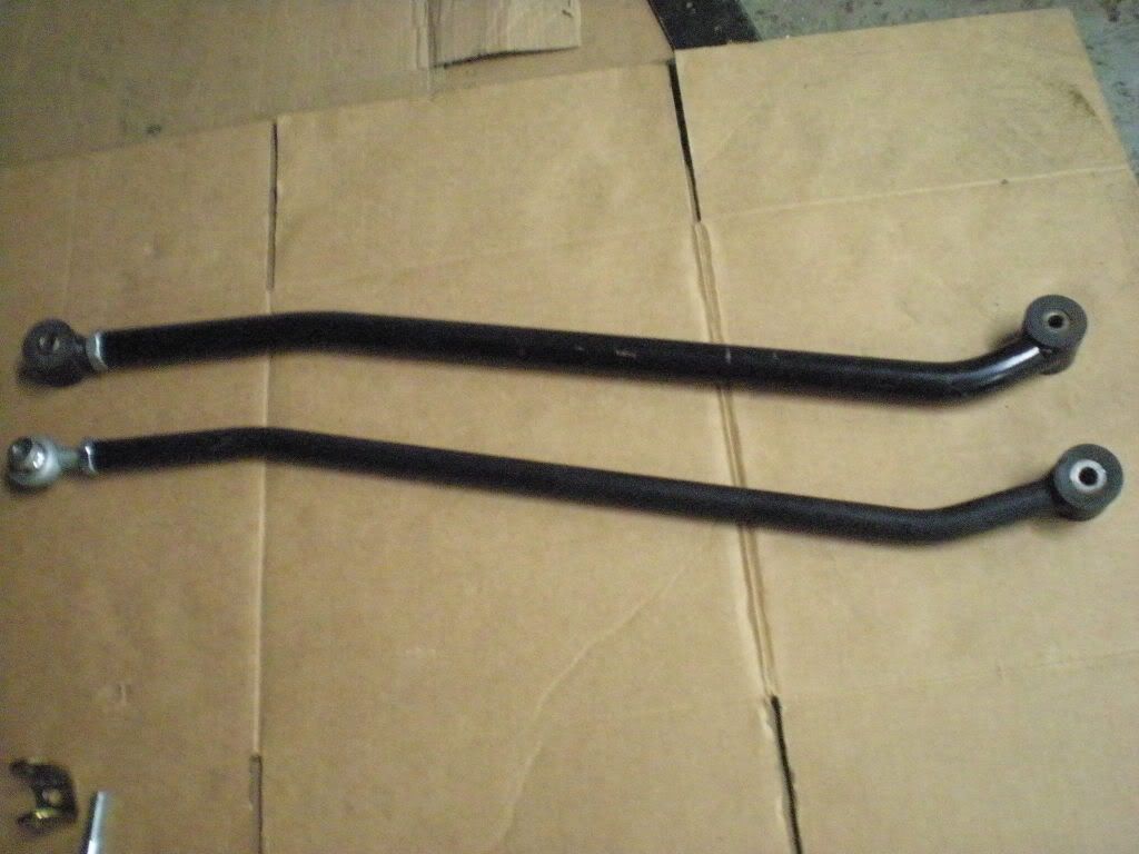

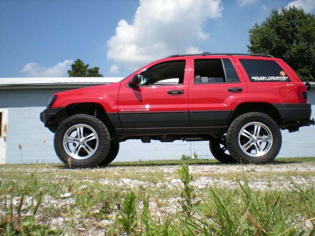

For about the next month after that, I started stocking up on lift parts. I think this cheepest way to get 6" of lift. I think I am right at $1000 in parts at this point in time.
RCX 4" lift
Rusty's 2"bb
IRO upper adj control arms
IRO fixed lower rear control arms
IRO HD Dual SS

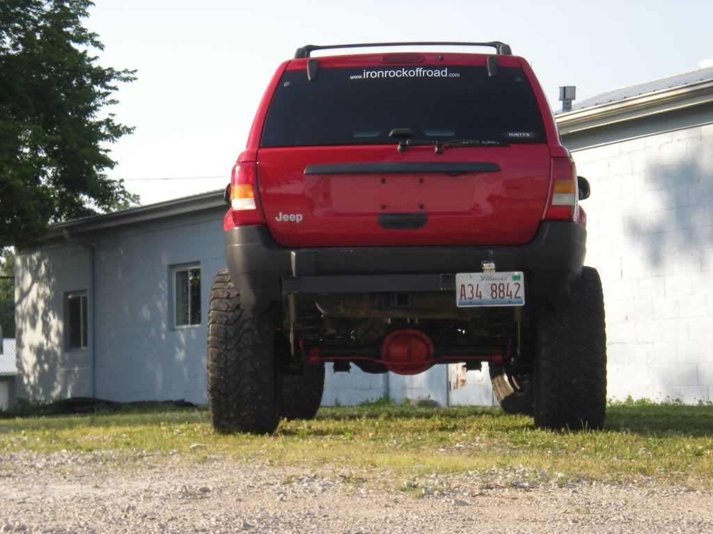

I put the lift on buy myself (took 10 hours) so I didnt really care to take and pics in the process of putting it on. It measures 6.5" actual lift I dont have a t/c drop and I dont have any vibes.
The only good pic I have with stock wheel and tires.

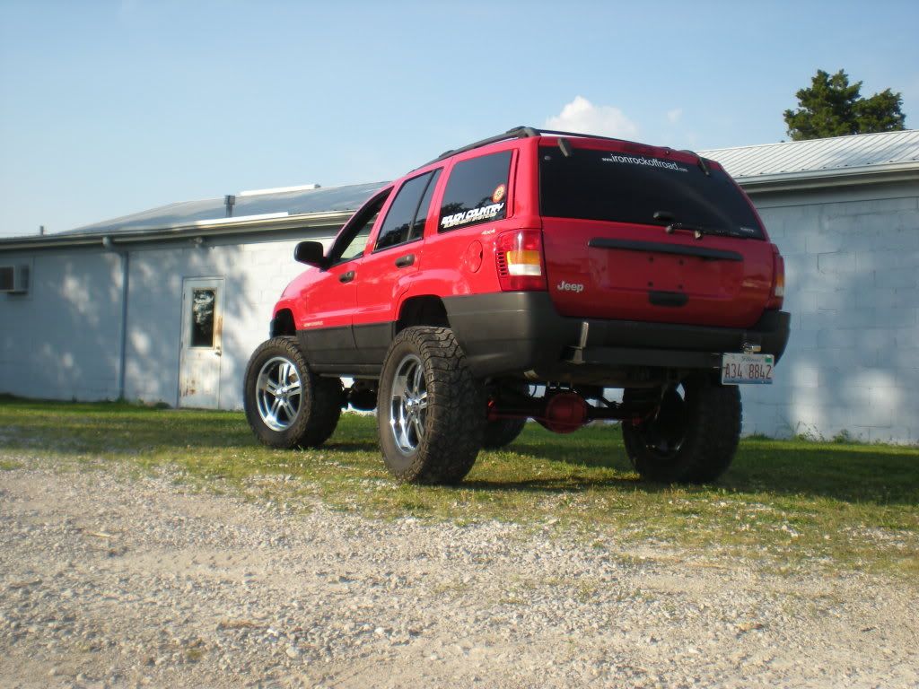

I got at set of half used Baja ATZs from a friend of mine for free. 35x13.50R20. I got a set of 20x8.5 gunner 5s from discount tire. So for under $700 total I have a good set of 35s mounted and balanced.

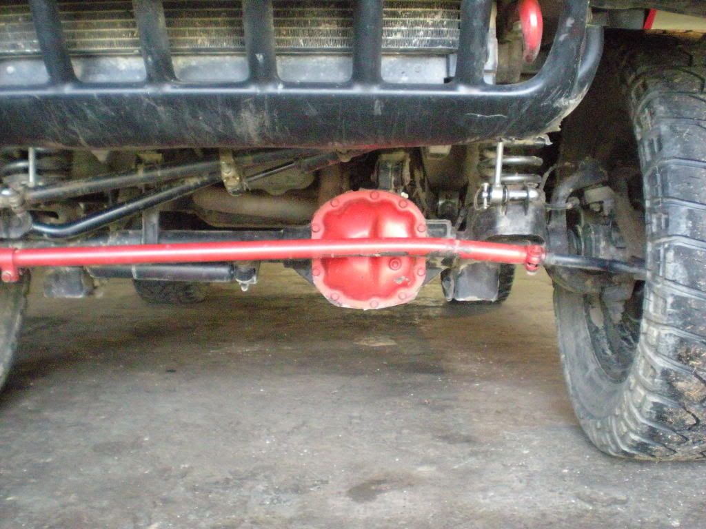

I was having a lot of bump steer so I got rid of my little RC adj track bar. I would not recommend it to anybody. I bought an IRO adj track bar form Bama_WJ for a good price and it solved my problems.

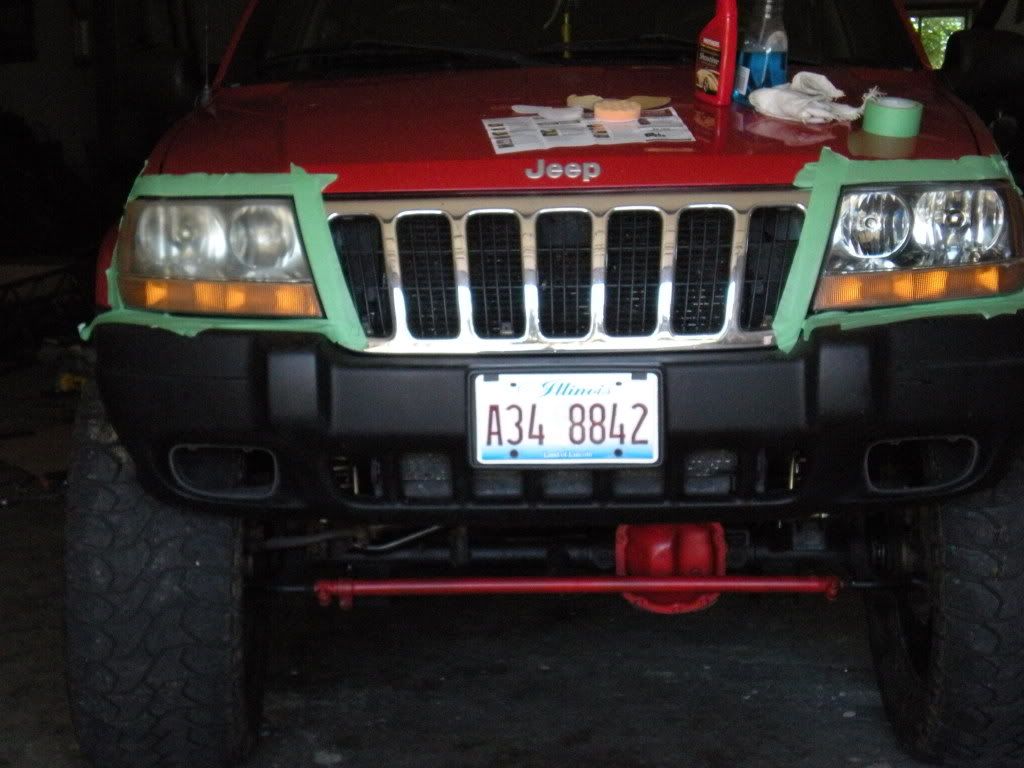

I cleaned my headlights with the 3M kit that goes in the drill. It did wonders for my lights.
I then tinted my turn signals and side markers. I also added some tow hooks and trimed my bumper

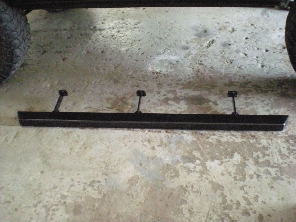

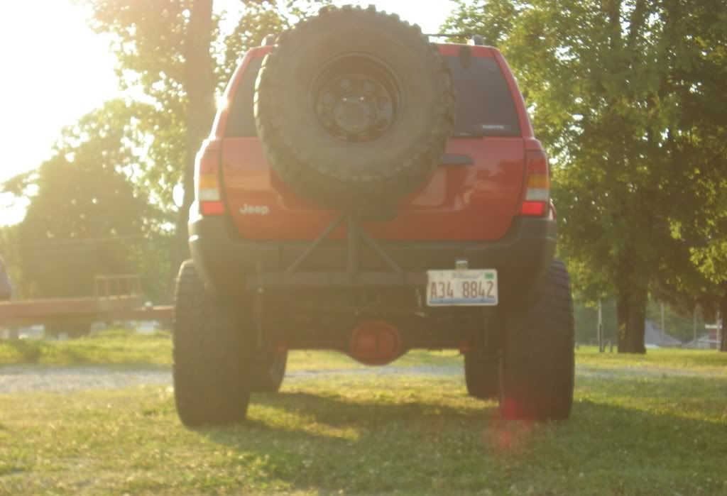

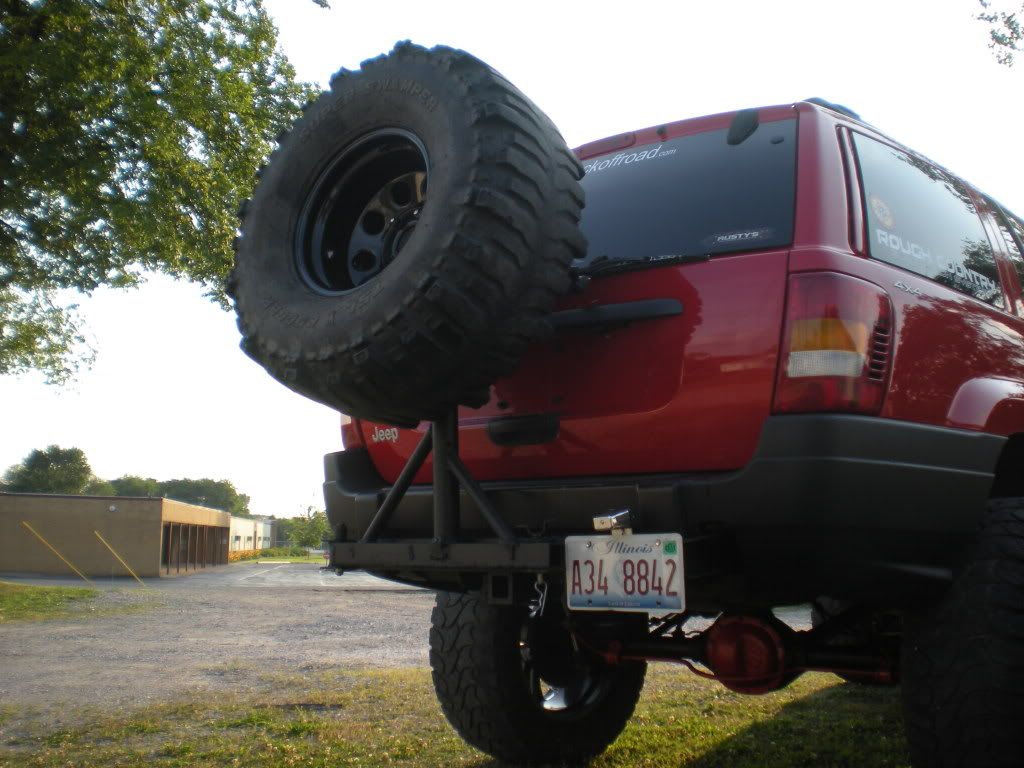

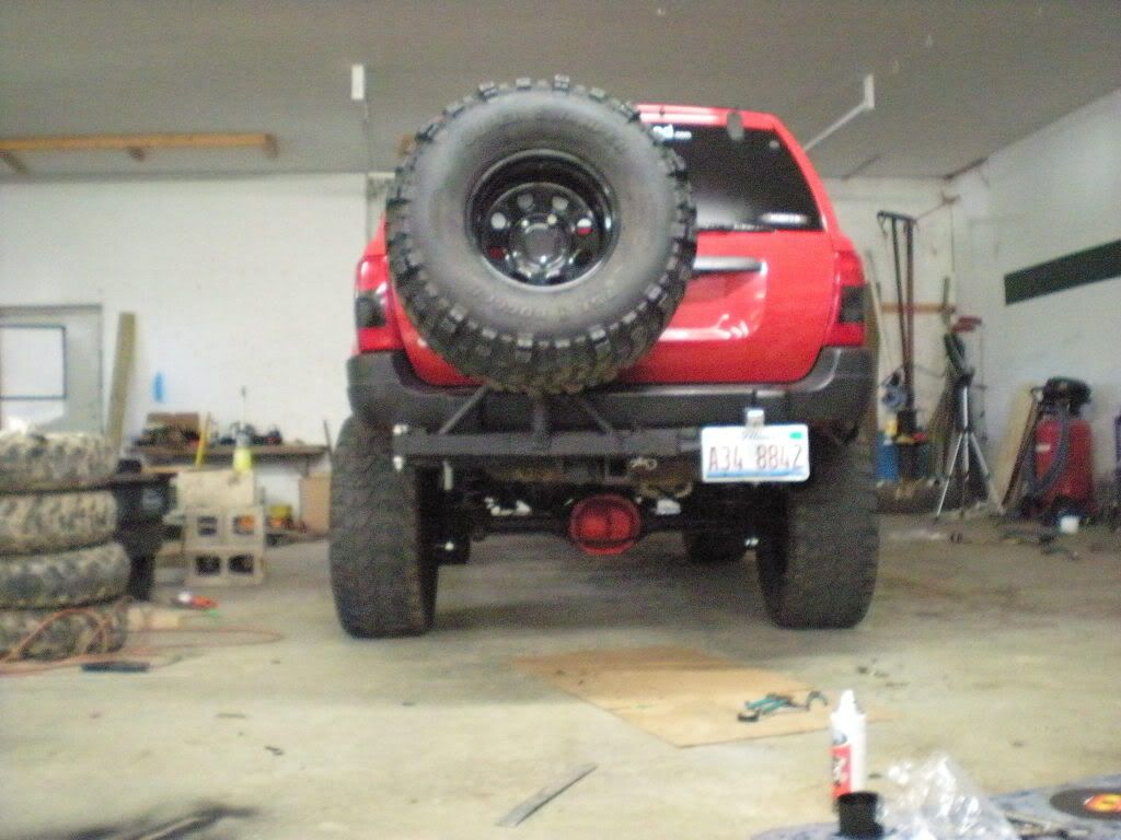

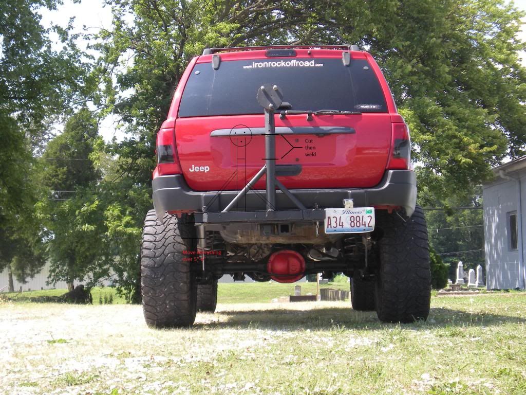

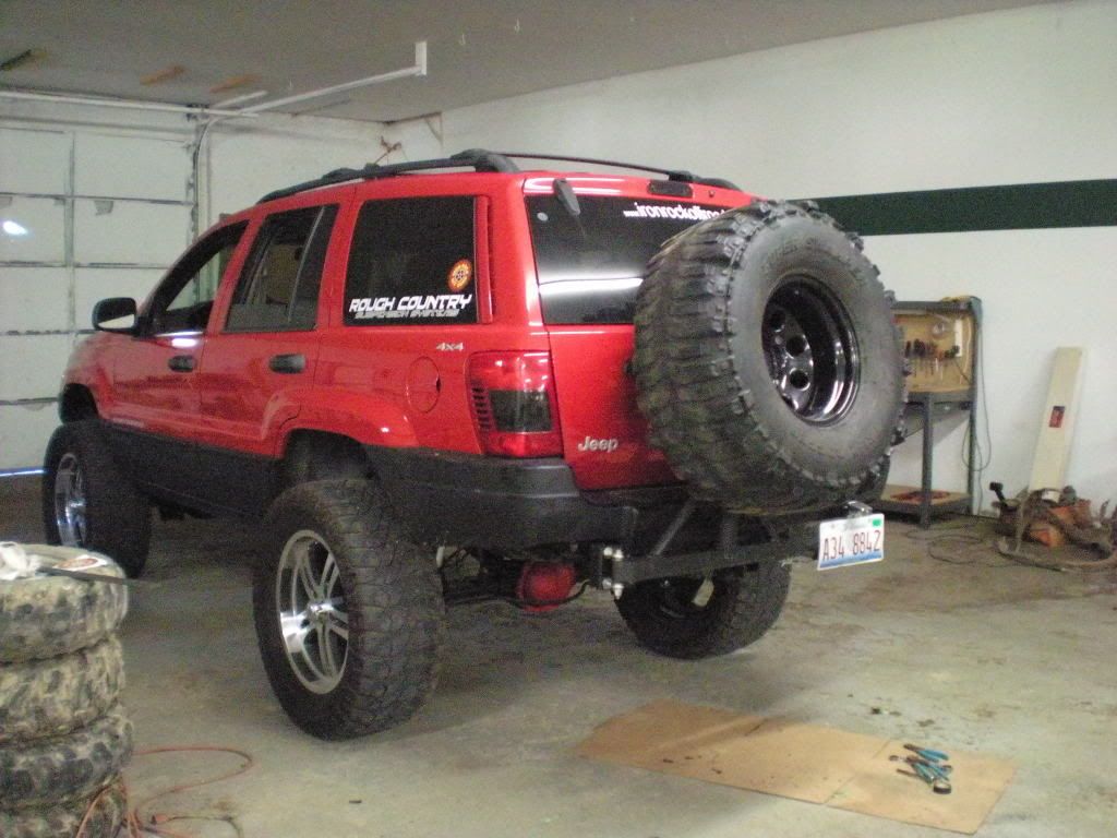

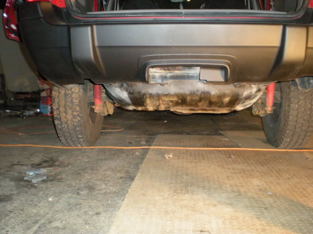

Now onto my trie carrier that I have been getting questions about. I got some c-channel for free at school. I hope the pics can explain most of what I did. Here is what I had before I redid it.
and here are my plans

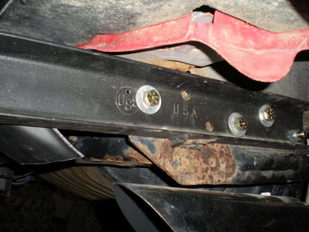

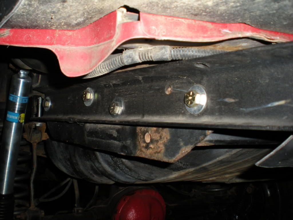

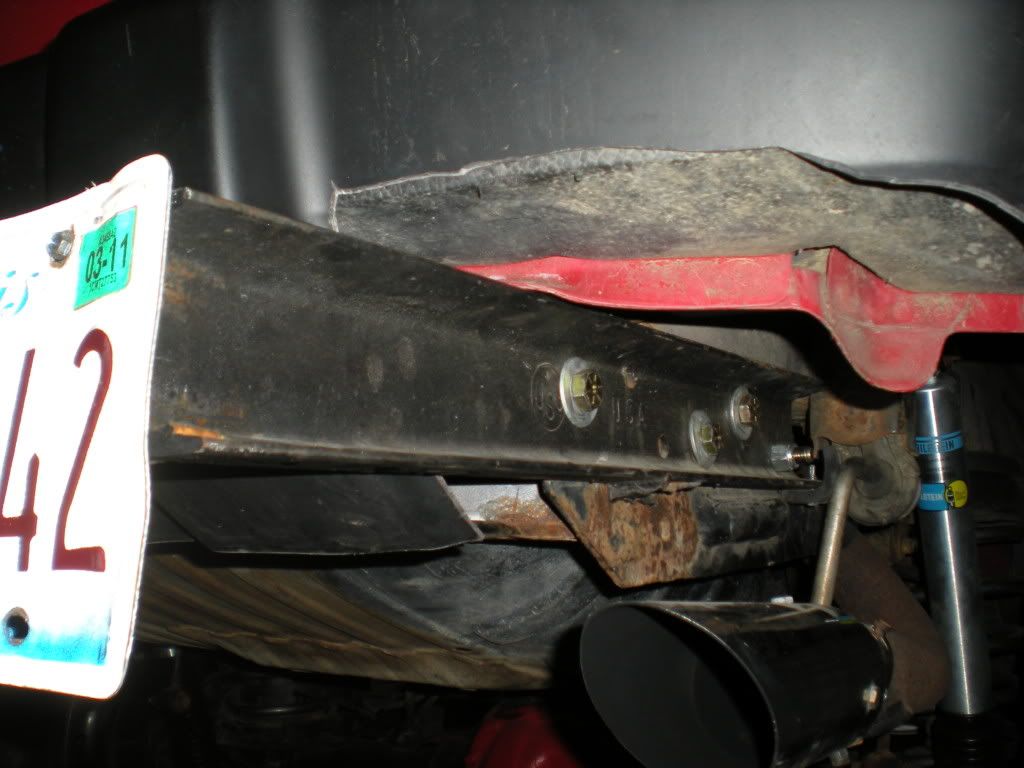

mount on the hitch, passenger side stops and the exhaust hanger
my mount on the drivers side goes all the way along the hitch b/c there are no gas fill hoses in the way. (you can see my 5125s in that one, they make short arms and 6" lift ride just like stock)
off of the jeep
There is a little of the pinch/weld seam that needs to be bent up to make everything higher.

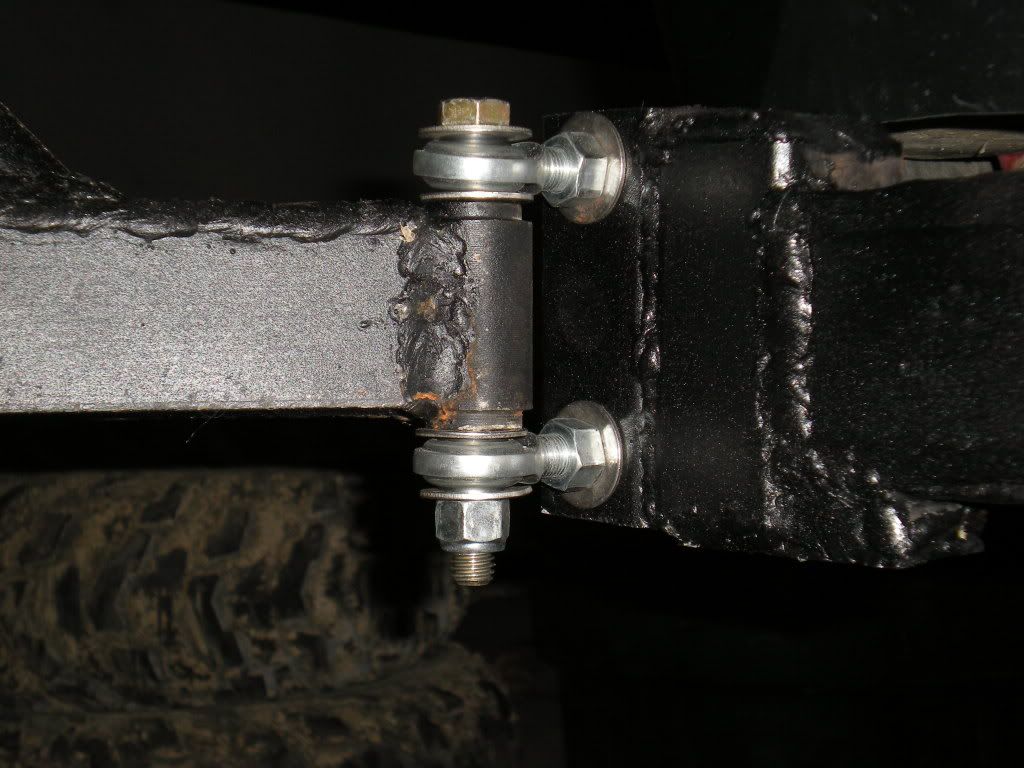

I converted to a heim join style hinge that works great. It is much better than tabs with a bolt through it. (don't pay attention to my welds, it was my first time with a wire feed)
simple latch

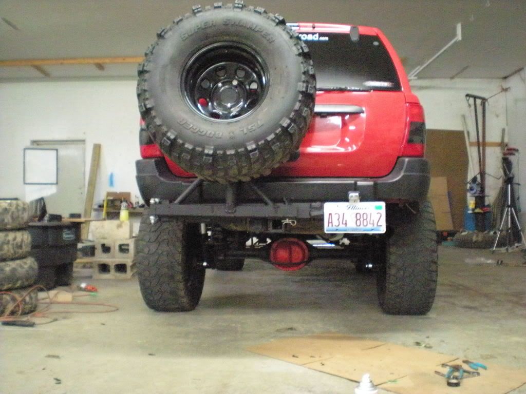

before
after
Thats about all I have for right now untill I get my IRO budget rock sliders, and my multiple double cardan drive shaft (4 U joints) from Drivelines Plus in Evansville, IN.

with stock tires and RC track bar I would get death wobble at 50mph when I hit a big bump. With the 35s and RC track bar, dw at 40mph and a big bump. With the IRO track bar no dw and just the slightest bump steer. Thanks

i think your front IRO lower CAs are the wrong way also i think you have bumpsteer because if you are sitting at 6.5 the tbar only goes to 6in of adjustment so you need to compensate for the .5in
· Registered
Joined
213 Posts
Discussion Starter · #8 ·
My lower control arms are RC and I think they are the right way, I could be wrong but I dont have any problems. The RC tbar was too short, now I have an IRO adj tbar that is rated to 7"

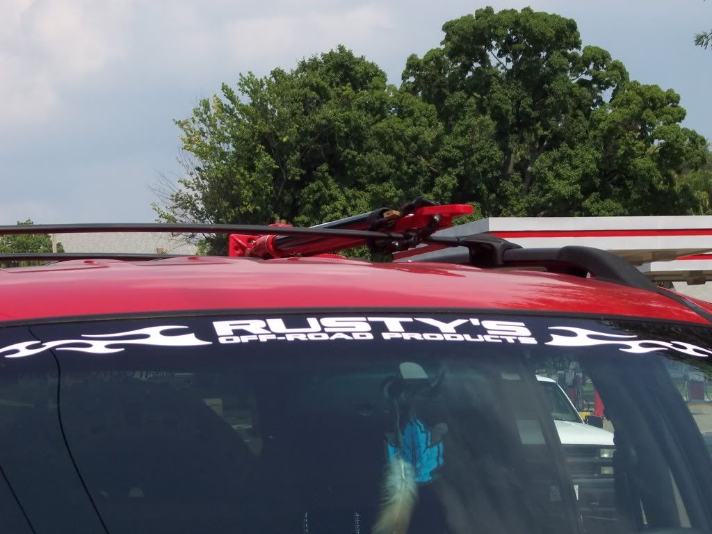

I went and got a HiLift jack and mounted it on the roof rack crossbars. I used all stainless hardwear so I wouldnt have to ever worry about rust.

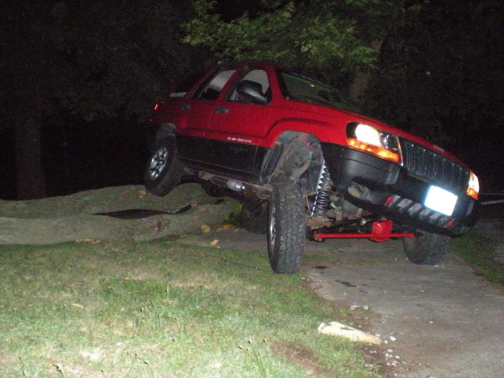

I took off my rear swaybar because all of my bushings are wore out and they were making all kinds of noise. Then I got board and decided to do a little flexing at my shop. The rear coil was fully extended and loose; I thought that was pretty cool with short arms.

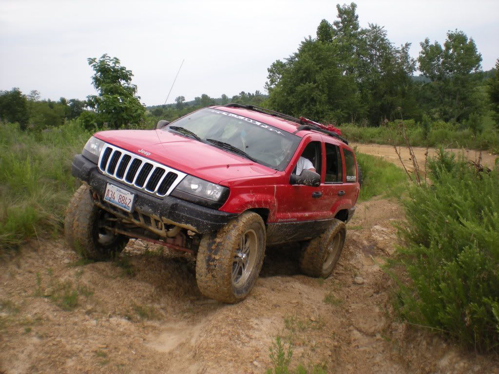

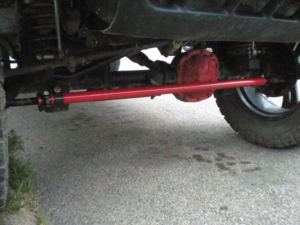

I went to Lynnville again today. It rained so the all terrains were limited. Still didn't stop me from tearing something up. First real trail damage. I guess I have a higher clearance tie rod now. lol

I went and got a new oem tie rod, threw on several coats of paint, and swapped everything over. I wish I could have gone with the IRO set up, but money is tight now since I just dropped a grand in tool for college.
problem solved
