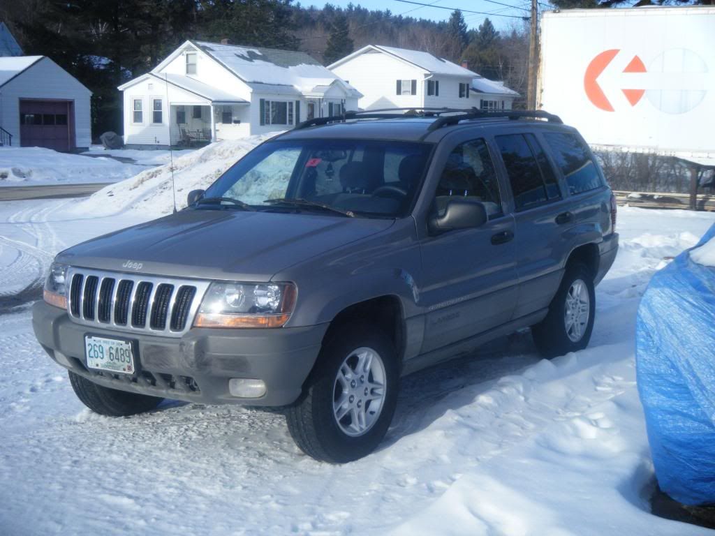

I just picked up this 99 Grand Cherokee Laredo 4.7 with 150k miles for $600. It needs the 247 rebuilt or replaced with a 242 im not sure which to do yet. The motor has a knock in it also so i need to see if i can fix this one or put a new motor in it.
I sold my ZJ yesterday for $3000 yesterday and kept my 285 duratracs which are now forsale. I was wondering what would be a good riding lift kit for the WJ cause im not going to cheap out on this kift like i did the ZJ which rode like a dump truck.
All that has been done to the WJ so far is i paintrd the wheels because they were staind badly with brake dust and my Girlfriend cleand out the interior.
